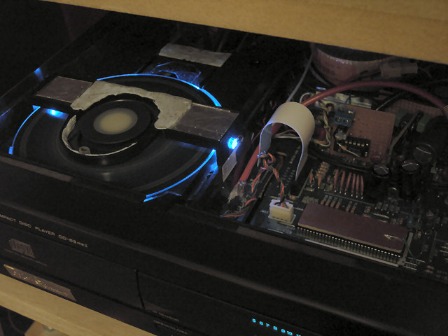

Oh yes, you asked about my LEDs. I took a (terrible) picture for you.
At least it shows where you can mount them.
Thanks Simon, thats exactly where i thought it went. Ill have ago at that one tomorow if i get chance.
Have you mounted the LEDs so they are centre of the disc, ie, shining through the disc rather than below it onto the laser and reflecting to the surface ?

ImSparticus said:Thanks Simon, thats exactly where i thought it went. Ill have ago at that one tomorow if i get chance.
I just tried some pana tsup 10000uf caps in my A400 amp(reservoir caps), used the 100uf Blackgates for the coupling in the A400 also, these where a redundant mod from the cd63 output. Needs burnin in a bit first. Then ill evaluate the led mod.
They're mounted just below centre, so more of the light is spread under the disc than over it. Brent actually did this mod for me whilst he had the player, he's a good lad
