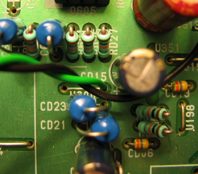

The very Santa version. Lets see if I remember. It's 2740 posts ago!
The one at left supplies the pins 17,22 and 26 of the DAC, the analog 5V. You can do this by removing the wirelink and inject your clean 5V like this.

The very Santa version. Lets see if I remember. It's 2740 posts ago! The one at left supplies the pins 17,22 and 26 of the DAC, the analog 5V. You can do this by removing the wirelink and inject your clean 5V like this.

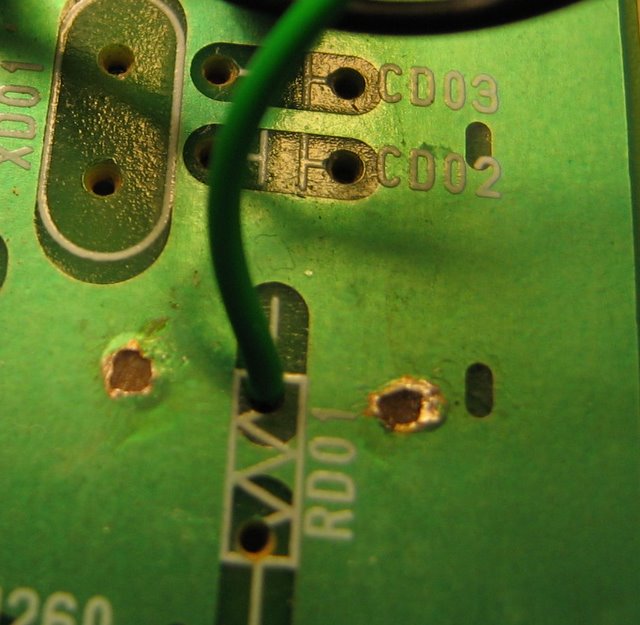

avr300 said:
The right one is feeding pin27 af the DAC, 5V clock supply. You can do this by removing RD01 and inject the 5V as shown.
The one in the middle is the clock.

And it is, of cause, pin 17,21,22 and 26. I'm sorry.
Quoting myself :rolleyes:
LOL,
Tak Tak! Thanks AVR, appreciate the close-ups and the "good oil" info.
k.
