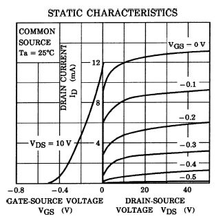

Well...
I couldn't imagine that Marantz made a class-B HDAM....:eek:
so I couldn't resist taking a look at the datasheets of the FET's, and it seems that you're wrong :bawling:
The FET's are of the 'normally-on' type, so with an Ugs of 0V there will be a current flowing, somewhere between 6 and 12mA (?) for the BL version. Fweew....
Ray.

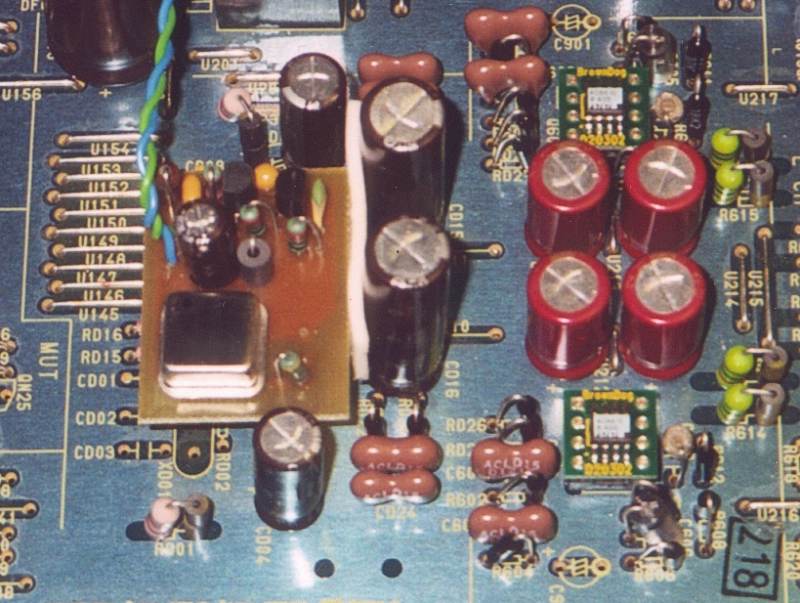

Hi DJNUBZ,
Good to hear you like the first results of your mods. You have taken out the muting transistors and the output caps also, is that correct? Since you have a CD53, you don't have to bypass the HDAM circuit, so that will save you some work :yes:.
If you want to replace the opamps, I would recommend to put two IC sockets in there. That will make it easy to swap them. So you may start with a cheaper opamp now, and drop in something better in the future.
You can start with the OPA2134, AD826/827 or LT1361. But the AD8620 is very good. You can also get bare BrownDog adapters and source the opamps from Analog Devices' free sample program :D.
You can put the original 2114 in class-A, but I don't think that will gain much. Never tried it actually, always take it out straight away ;).
Why do you think you're not able to build a clock? You are soldering now, right??? All you need is a small piece of veroboard. The simplest clock would be the Tentlabs XO-module (see fuzzy picture). That's a complete oscillator in a can, all you need to add is a power-supply. Take a look on the Tentlabs Website, there's also a schematic for the PSU, and it's not too expensive. I started out with this, and it will give you far better results than the Acoustica clock hack (well, that's if you don't break anything of course :D).
If you change other parts, like the electrolytics, it's not only important to change them to a higher value, but also to use a GOOD capacitor. It's better to have a good 470u in there than a bad 1000u. What brand are the caps you have?
You can swap the 220u to 470u/50V, but the best thing is to use a Panasonic FC, Rubycon ZL or another type that has low ESR. The 470u will make an improvement over 220u of course, but 1000u or 2200u will be even better, and you get the best results if you use a special low-ESR cap.
For other parts that are easy to replace, you can take a look at one of my mods list. The CD57 list is the most recent one I did. You can start with the power supply caps, and around the opamps. Do the the bigger ones first, and do the smaller parts later, like the 4,7R resistors. If you get the hang of it you can really dig in.
