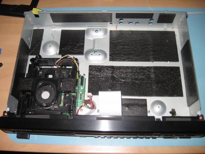

Mornin' fellows!
I was also worried when I first see the non centered upper lock of the CD... but seems normal.
I need some advices about how to dampen the bottom chassis plate, as it is not flat and maybe close to PCB in some area and has hole that may help to cool the stuff.
So, any cooling issues or damping advice?
Thanks!
Thanks!
