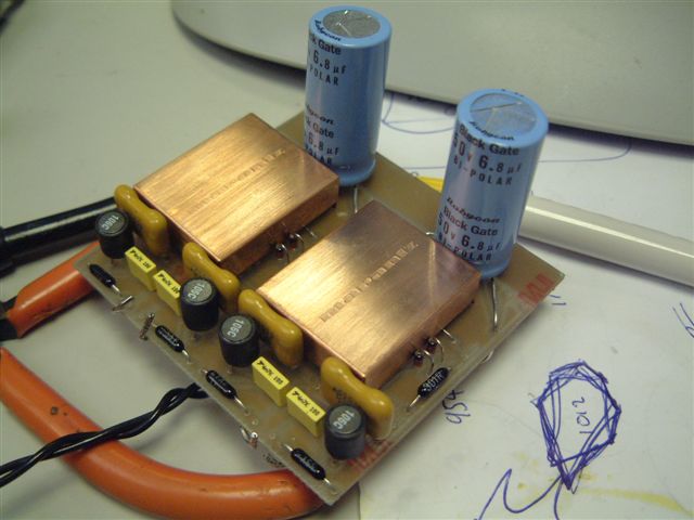

Well the Black Gate caps certainy sound more open/clean than the LCR and AMPOHM caps.
They seem to allow the music to play with more pace too.
Here is a pic of pcb with caps and copper cans
Brent

They are now giving a little more bass yes and the more I run them in the better they get.
And I must say how suprised I am by them, they are running in very quickly indeed, the sound is getting deeper and fuller with the tops being very tight.
Im running India Arie cd on repeat has this has loads of bass.
Brent
Yes it is tighter and its getting tighter with use too.
Brent

rowemeister said:
I ordered some BG N when I ordered the BG AC but they sent BG C instead of the N so they have gone back.
I will test the difference when the replacements come
Brent
Hmmm, bummer. I'm curious what their sound will be like. Still haven't decided on my output caps yet...
Ray.
