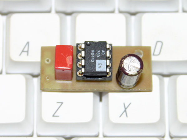

Voltage reference
I had some AD780 laying around and fitted one on a small PCB. It's a very precise voltage generator, giving out exactly 2.50Vdc.
It's a common mod for high price studio gear (analog-digital converters) to have the reference voltage modified, so I wondered why not?
For this purpose I ripped out (you know me by now) R124,R125,C123 and C124. The output connects to the hot side of R125.
Please don't ask me for results as I did several mods at once. Bottom line: the fat lady sings like never before!
Regards, Jaap
