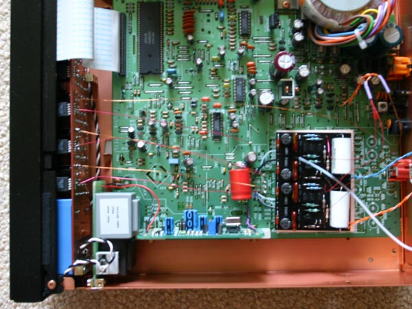

pantera6 said:Jaap,
Sorry to sound daft, but the pic you posted of the circuit board close to the RCA outputs .... is that your passive filter + FET output stage??
You're not sounding daft at all as this thread is getting longer and longer...
Yes, it's Rays' passive fiter and FET buffer. I just did the PCB design.
In the center is a Tent clock (bolted to mainboard) plus Tent PSU (bolted to side of case).
On the right is a 4X 5V PSU (bolted to bottom of case).
regards, jaap

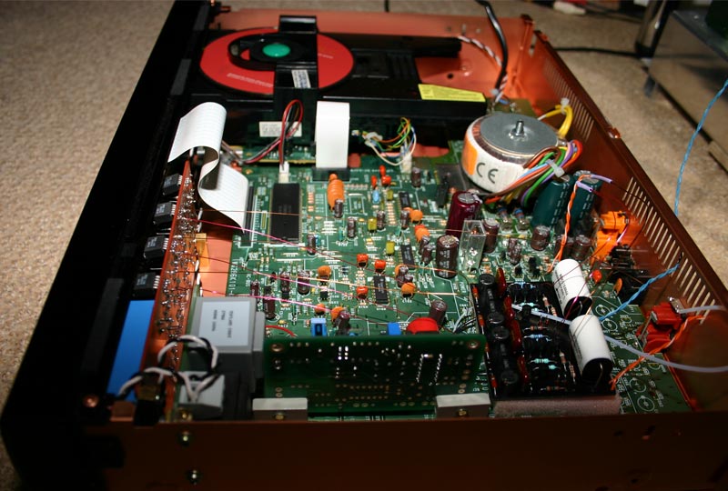

disco are you etching the pcbs yourself?
Brent
rowemeister said:disco are you etching the pcbs yourself?
Brent
Yep. I have a smal setup, not very efficient for large numbers.

Would you be willing to make a small amount of bare boards for some of us. We will of course pay!
I want to build a pcb like this but dont have the equipment
Brent

Jaap, very impressive work mate! Was the difference noticable going from opamps + HDAM to the custom FET output stage? How would you characterise the change in sound??
Champi
pantera6 said:Was the difference noticable going from opamps + HDAM to the custom FET output stage?
Thanks.
Well, I do own a second CD63 modded this far:
acoustica clock mod, good caps for 5V (BG NX 1000uF) and 12V, removing HDAM , muting transistors, DC blocking caps and headphone circuit, placing selfs with beads, bypassing several electrolytic caps with SMD stuff, changed diodes to Schottky. Original 21140 opamps but matched resistors.
Compared to the one shown (FET buffer, Tent clock, dedicated PSUs) it gives less presence, know what I mean? Music is more veiled, indirect.
When playing the copper one, I am allways looking for the volume knob to put it louder I guess this is a good sign.
Don't remember each mods' effect but I think much veil was lifted by putting in better caps and bypassing them with PPS smds. Not necessary larger caps, just better as all caps destroy details.
Regards, Jaap

avr300 said:BTW Jaap, really nice layout. A bit of a pain to get the board out I'll guess. That's why I'm trying to get as much as possible to stick to the board itself. One newer knows when one have to rip it apart to test an idea.
There are 10 wires to loosen when taking out the board.
I've put in silver pins for easy access (four of them are between the red cap and FET buffer).
Regards, Jaap
