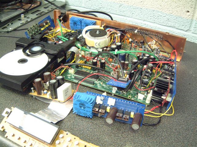

Is this new since fitting the clock feed? or an old problem?
Have you screened the chips with copper foil? also the new circuit?
It since fitting pcb, I will be screening chip and fitting it next to servo ic.
I chucked it all together to test, a little more care in the fitment etc and it should be ok.
Brent
Brent
I think it may be reradiation of the 16m signal causing the skipping
It is something I had thought of.
I really want to get it right as the benefits are very good.
Brent
just a thought
could be echo's
or
which one Dac or decoder is the master?
being
if your have the clock as set
the decoder and dac has to sync to the clock
if the clock is signal is interrupted to either the dac or decoder.
then data will be out of sync.
might be why the companies put the clock on the dac then run the decoder of the dac.????
allan
ps interruption could be anything ie RF, EMF, Vibration even down to
to cables?
could be echo's
or
being
allan
to cables?
awpagan said:just a thought
could be echo's
or
being
allan
to cables?
Yep
I may also try tapping off the decoder feed.
Brent
rowemeister said:
Yep
Brent
where is it put into the decoder?
allan

rowemeister said:Here is a pic of the CDP stripped from chassis ready and begging for mod to be sorted. Also my display died LMAO
Brent
I was thinking RF induced earth loop
Is the coax earth at the decoder as well?
allan
ps as for the display
ask simon here's the expert in that
