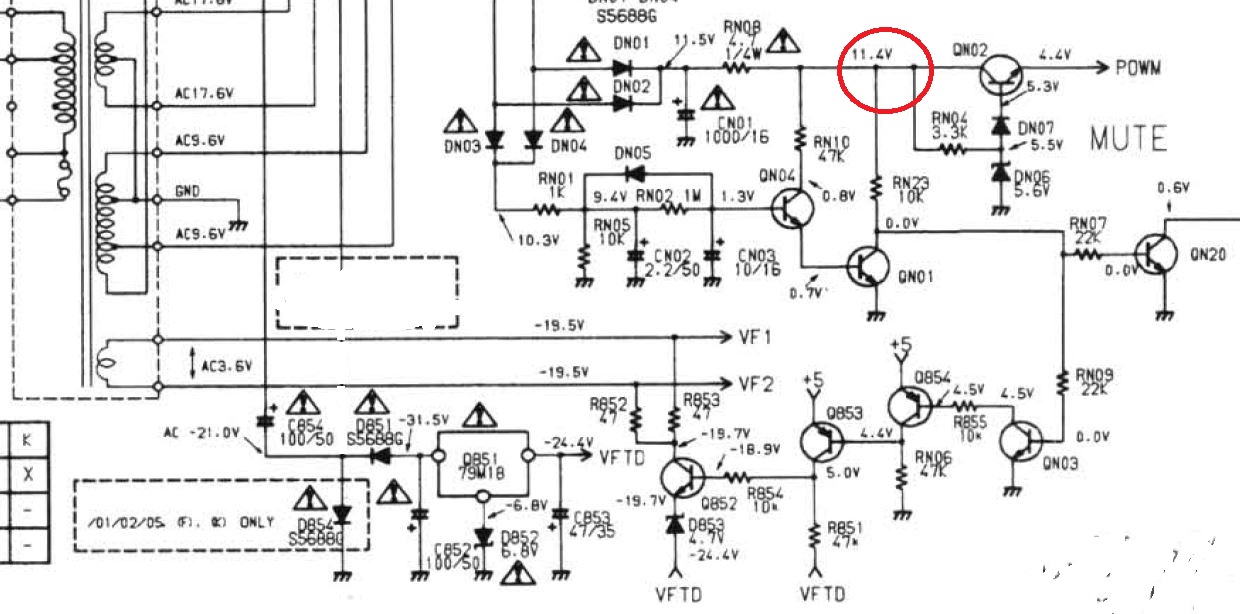

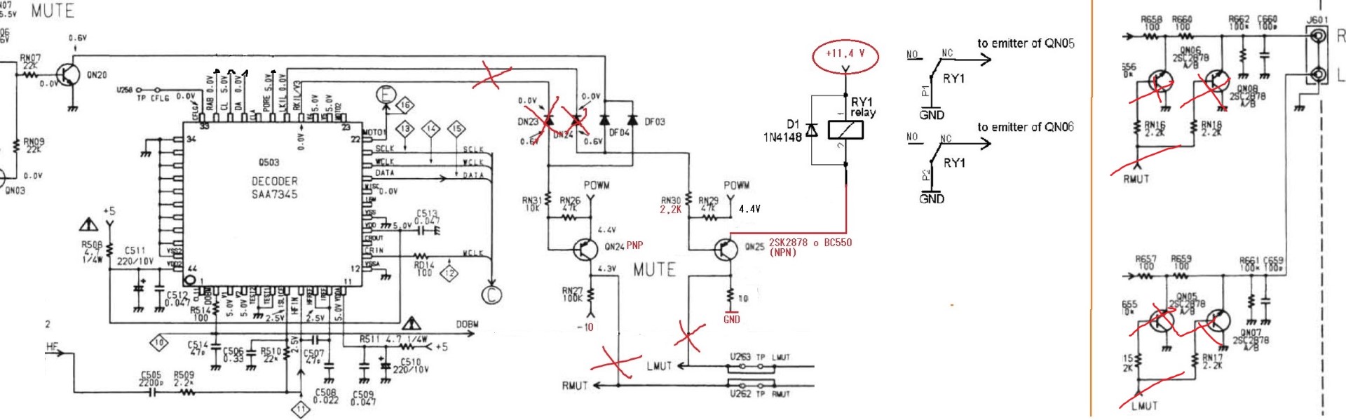

Hi i'm from Italy and that's my first post here on DIYaudio. I'd like to ask you a question about Marantz CD-53 muting mods. I decided to remove the muting transistors on the output (after having had some problems, sight and their criticality on the sound path) and to replace them with a nice double relay. I was there for a while to study the possible circuit, because the idea was to "integrate the relay on the board" without making too many changes. Well I succeeded and everything works regularly (or almost). There is only a small problem, actually negligible, but not much for me who are a fussy eater like few
Specifically, when muting is active (so the relay is off and the NC contacts bring the RCA output to ground), a rather weak whistle in the range of 500-1000hz can be heard from the speakers, and also from the headphone output. . When muting is deactivated after a few seconds from turning on the CD player (relay energized and audio outputs open), everything is PERFECTLY silent and the player's playback is perfect. No whistling was heard before the mods.
I am attaching parts of the CD player schematics with the changes I made.
What do you think it can depend on? I have done a series of measurements and tests but I have not solved my problem. If I turn off the power just to the OPAMP everything is perfectly MUTE and you don't even hear the famous whistle.
Does this make me deduce that it may be a whistle that is amplified by OPAMPs? But why just and only with the relay OFF?
It is also difficult to think that it is a whistle introduced on the ground plane by the switching of the relay coil, since the hiss is heard ONLY when the muting is active or that the coil is de-energized (OFF). In reality, however, it is not entirely true because perhaps there is also a problem on the sizing of the resistors RN29 and RN30 that drive the relay transistor: when the relay is OFF I measure a drop on the relay of almost 3 volts (when my project had to be 0 ) and relay ON I regularly measure 11-12 volts. Could this be the cause of the whistle?
As BJT relay driver I used one of the muting transistors which I removed from the outputs (2sc2878). I also tried with a BC550, always NPN, but nothing has changed. The whistle was always present.
Ideas?
Thanks a lot Ivan
P.S (In red marks my muting mods)
