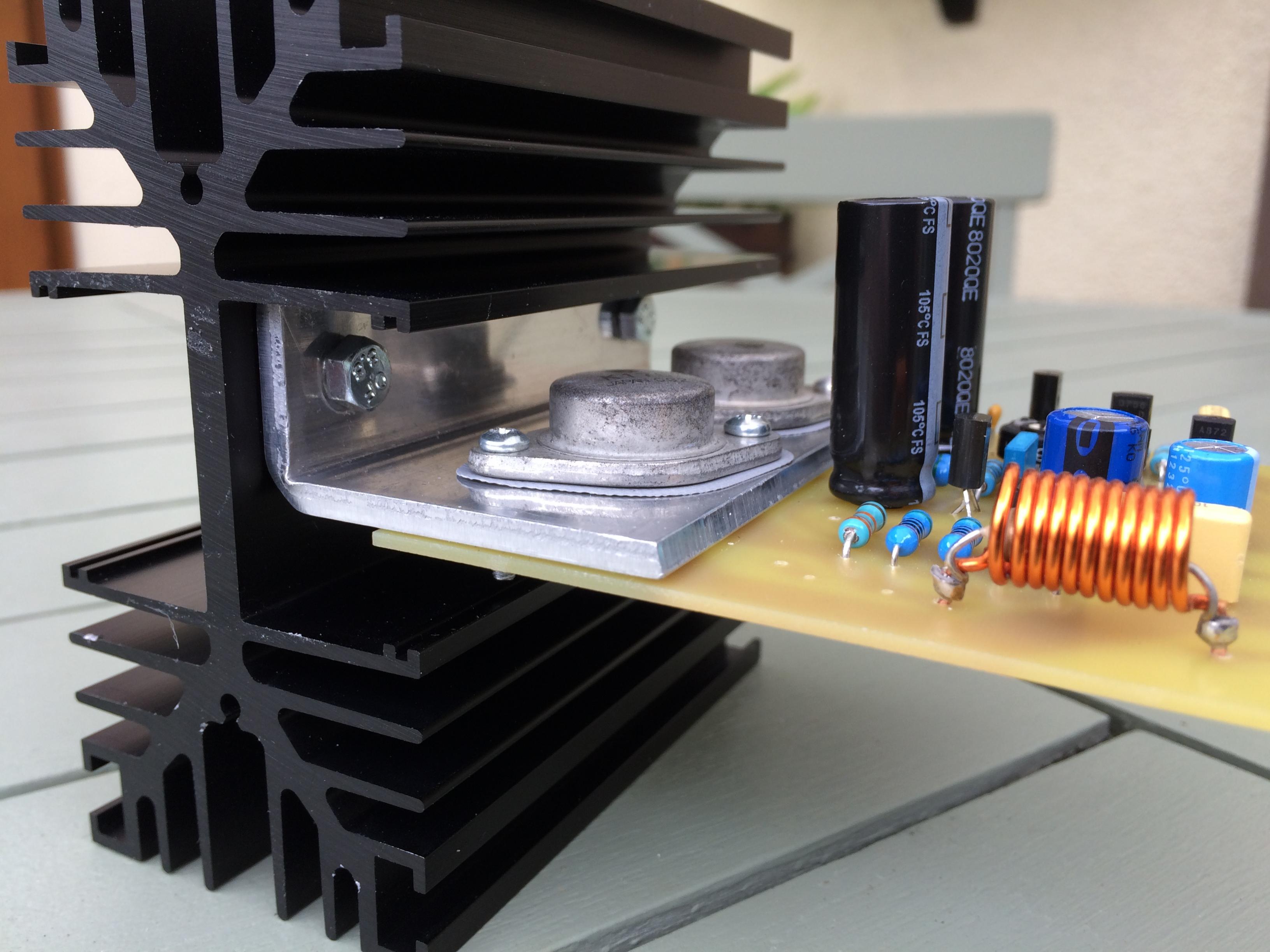

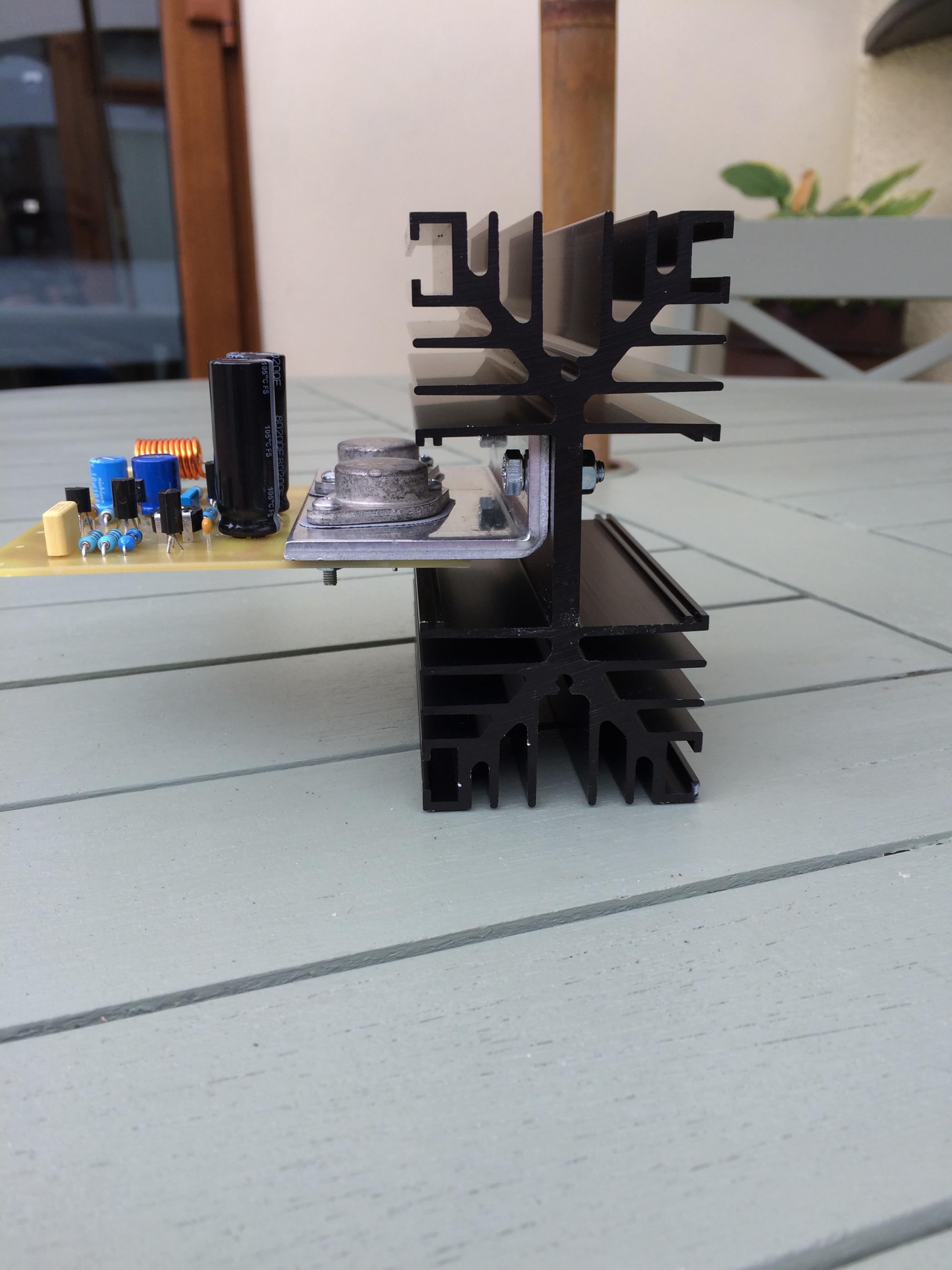

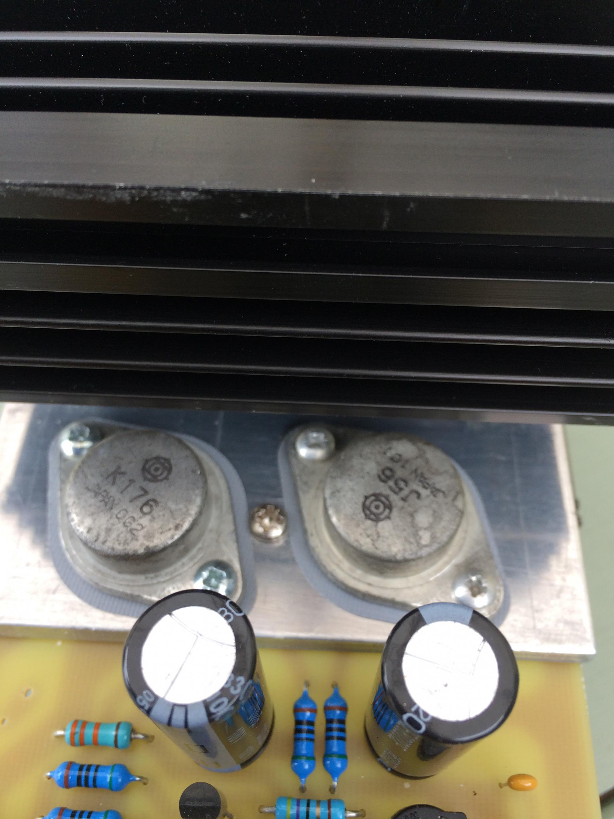

Just made the new heat sink bracket .. this is just a trial fitment, better 3mm bolts will be used and the mounting bracket will be polished
Just shows what you can achieve when you put your mind on to it and stay focused
Is it made from one or two pieces of metal ?
Its quite a thick piece of metal to try to bend.

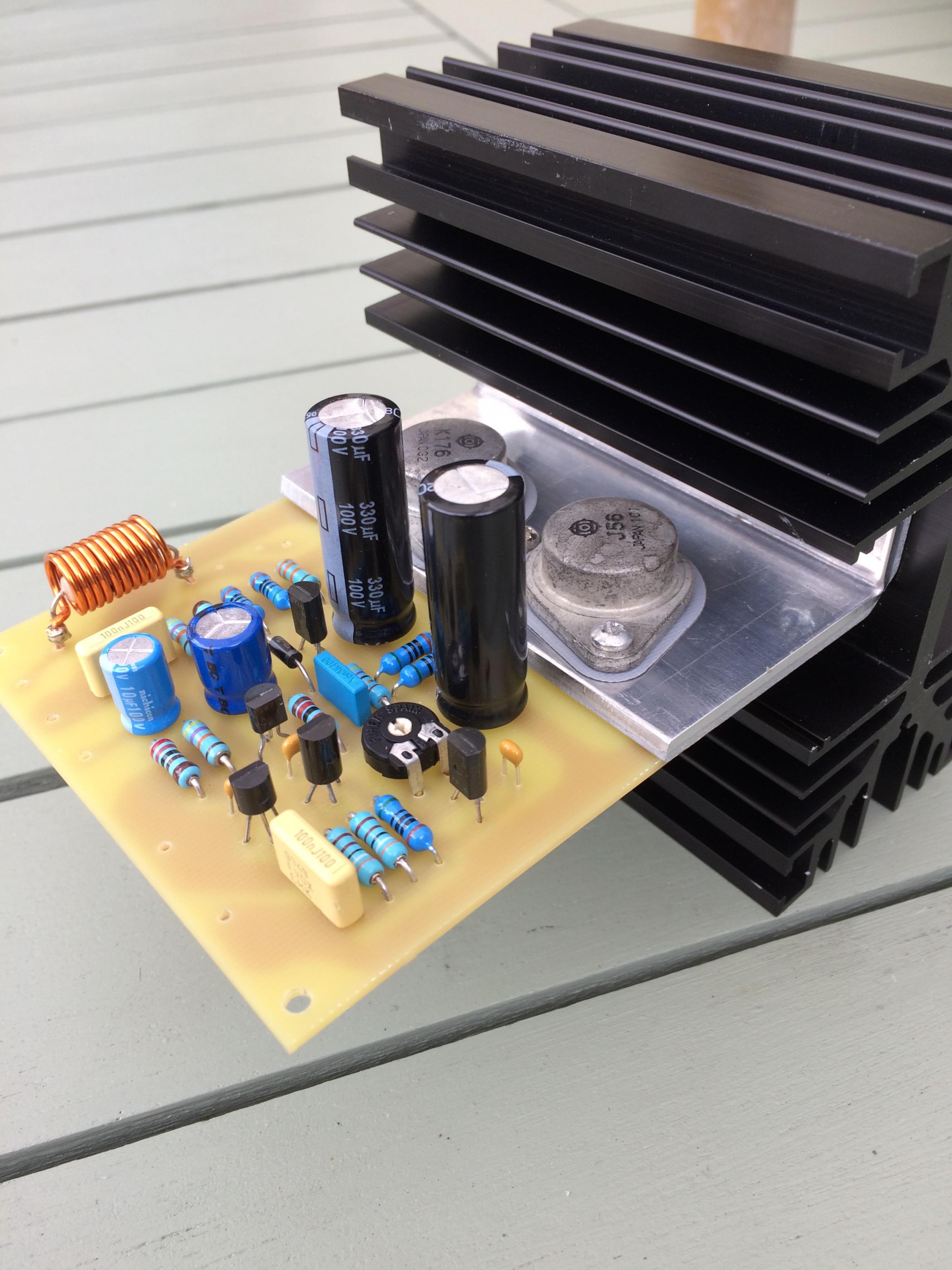

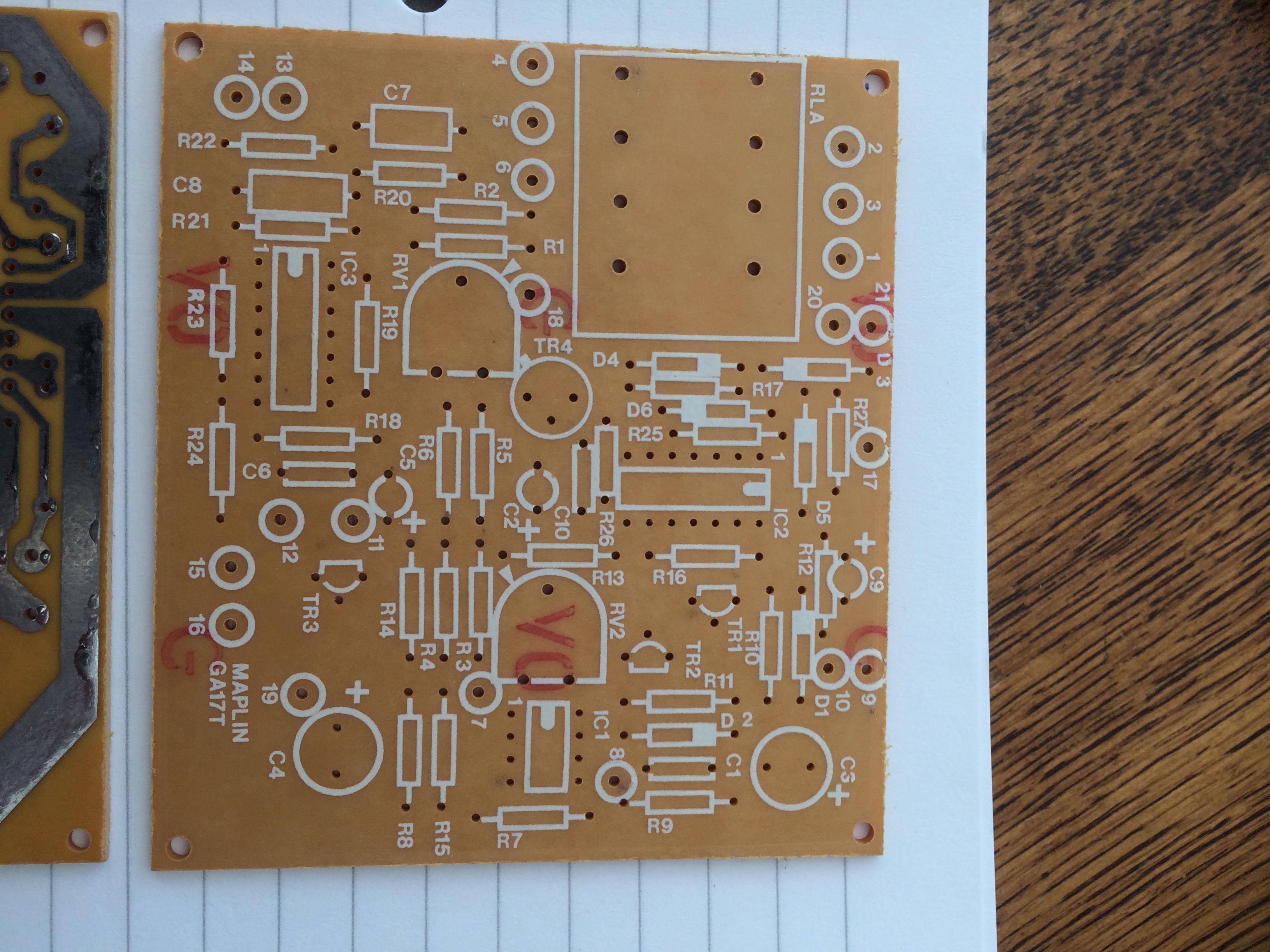

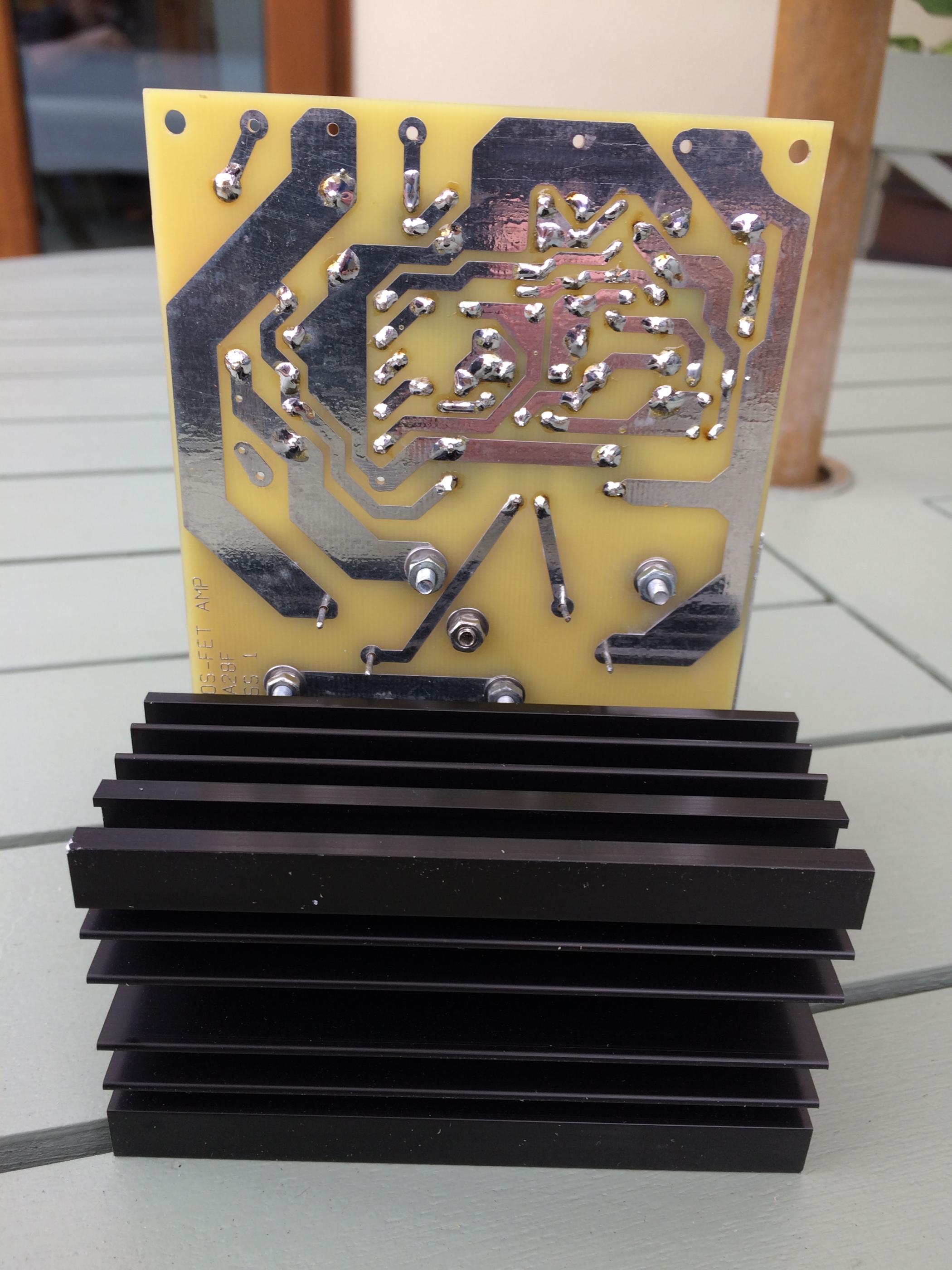

A little progress tonight a few resistors mounted .. really like making this amplifier it's very satisfying / easy to make and mod if required ... no spider thin PCB tracks on this board or surface mount S*** ... who cares if there is a little bit of hum when compared to all the mass produced chip stuff and all the people who listen to music on their iphones over bluetooth !
I bet you a couple of these in mono block form with good quality components would give the owner many listening years of pleasure and would still be working 20 years plus when most stuff ends up in the tip. I feel like I have just gone back to 1985 to my local maplins store ... all warm and fuzzy

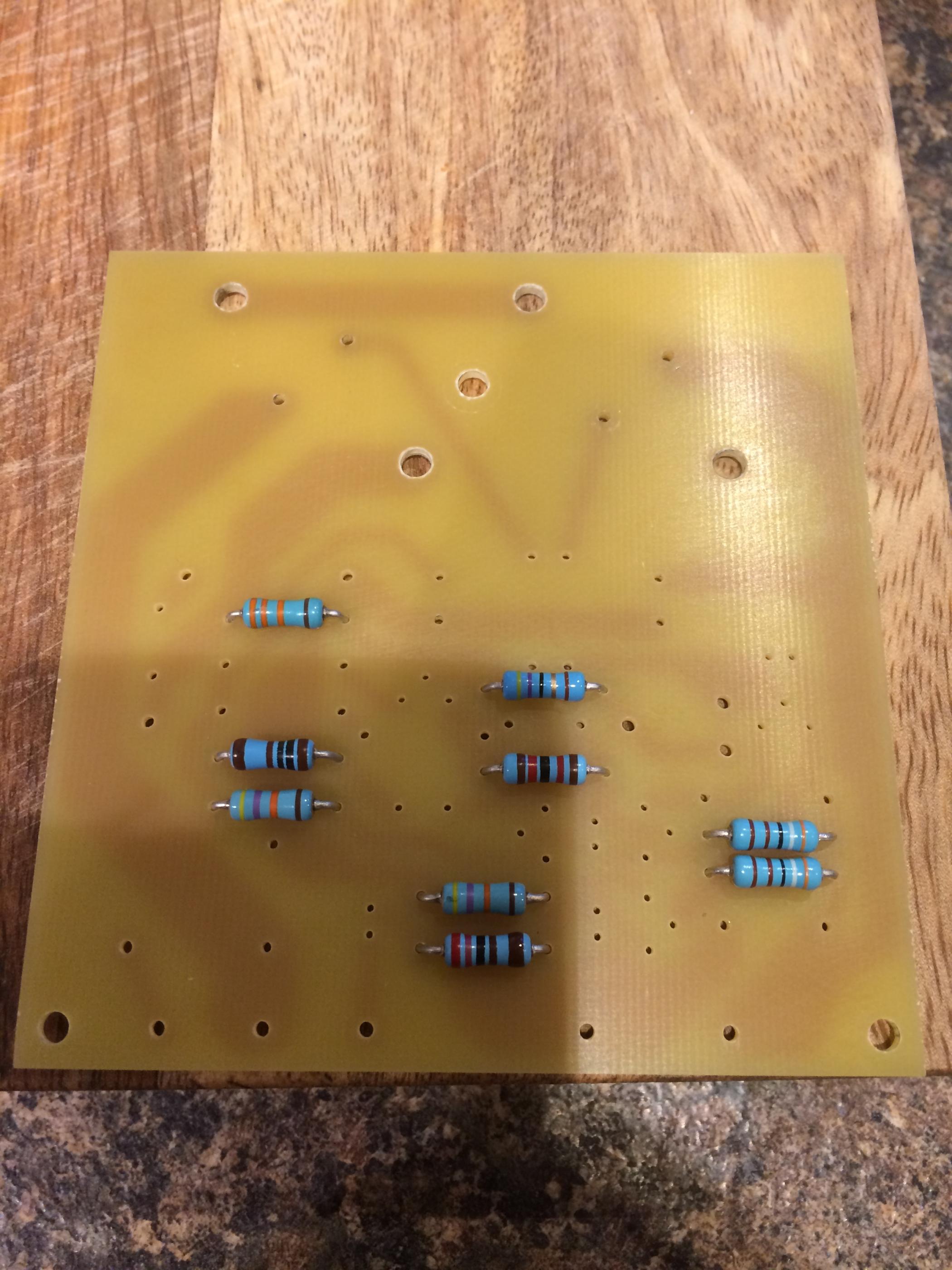

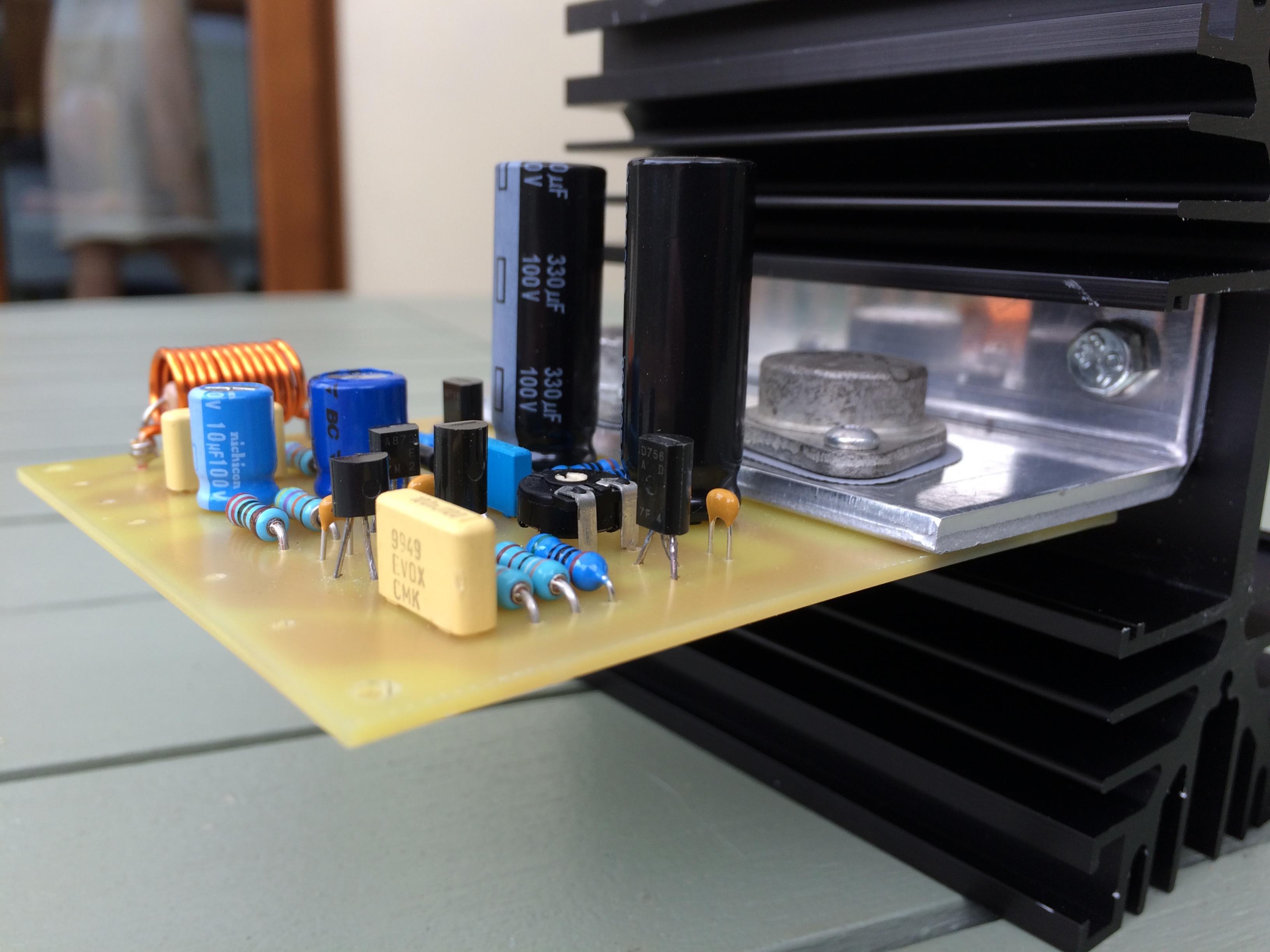

Hello just a few pictures to show very slow progress ... have used NOS 2sk176 / 2sj56 mosfets .. have a few in the workshop never been used.

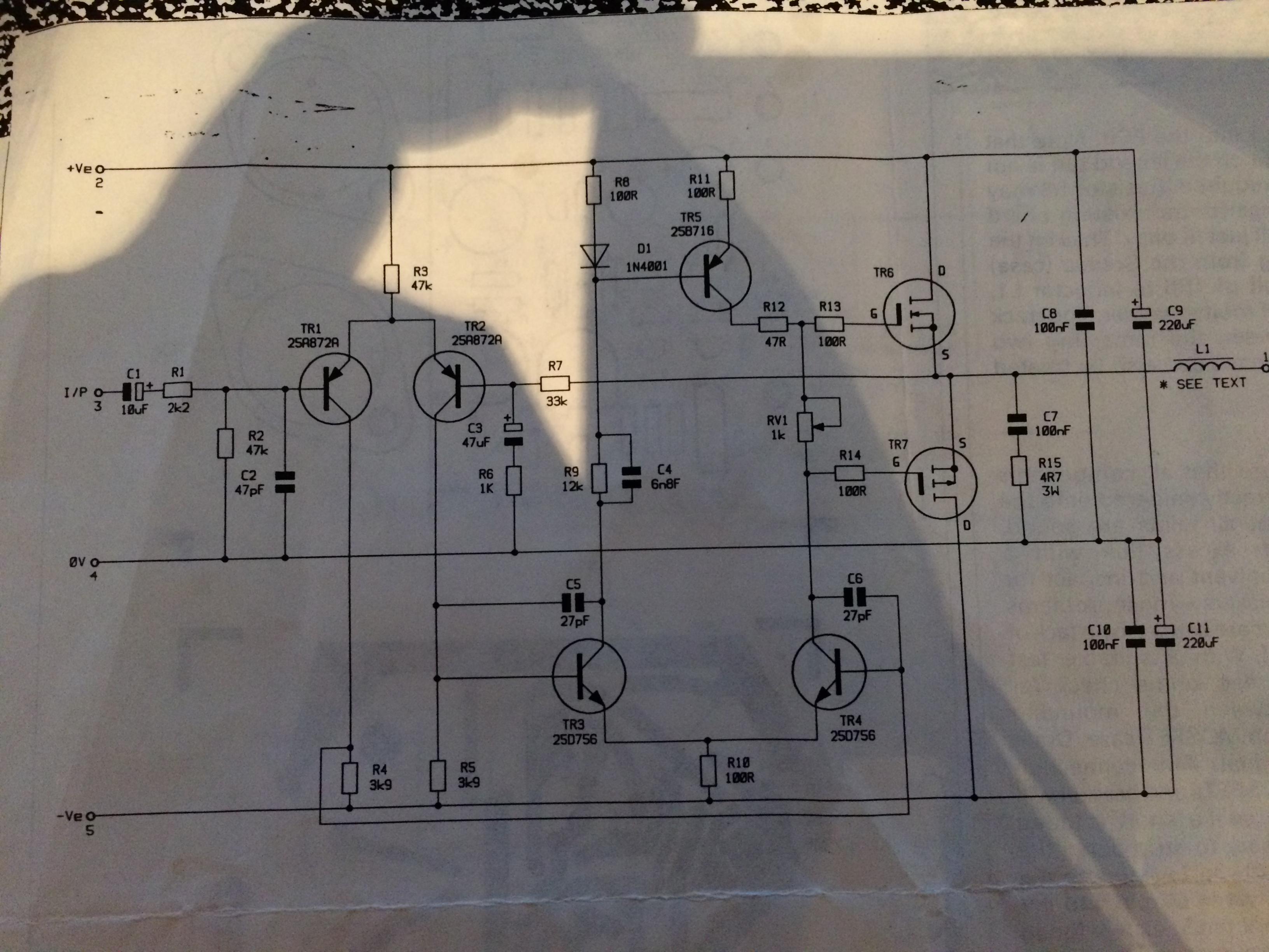

Hello Nigel .. quick question for resistor R15 it states 4.7 ohm wire wound ? does it need to be wire wound or could I use a metal oxide resistor ? I did read at some point that it should be a wire wound resistor ? all the kits had been supplied with a wire wound type for R15 ? ... your thoughts ?
So long as it is 3 watts any type should be fine.
I would try not to use WW if possible.
that is what what I thought .. why is that, to avoid oscillation issues ? thanks for the help
The WW resistors can sometimes be inductive.
Wirewounds are only a problem if used as Source resistors.
Steve.
It depends on the type of WW.
Some are very inductive and some are wound bifilar to cancel out the inductance.
