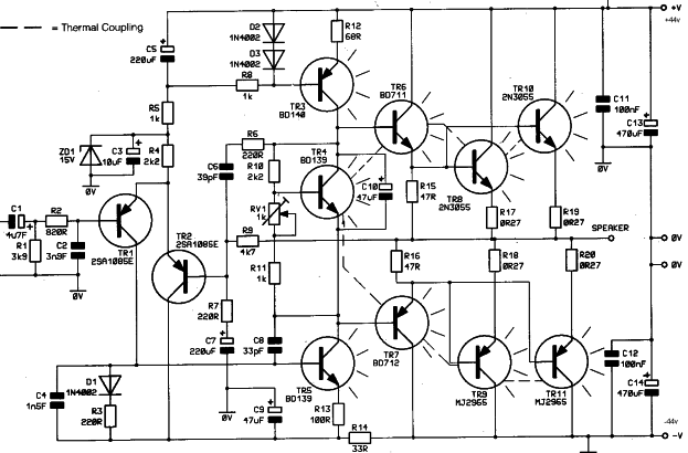

Maplin 160W (225W) bipolar amp design
Does anyone have any info on this amp. Circuit Dia would be fantastic. I asked Maplin about back issues with no luck.
Please help, i'm desperate to fix it.

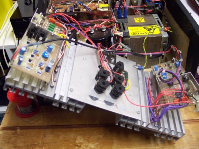

Regarding the 50w, i ran 4 of these in active system. A couple of r's 18/19? were overheating/pcb charred even when the amp was idling, i think the amp was not as stable as others, although i did run them without the o/p ind and probably no zobel.
As for the sound, i thought they were ok at the time, but no reflection other amps ive since used in the same setup proved that these amps lacked clarity.

It presents a low impedance path to AC (audio). Without it the junction of R13 and R14 would be modulated with the audio, the emitter of TR5 would "see" 133 ohms" rather than 100 ohm at audio frequencies and the base network of D1/R3 would also be modulated by audio.
Its reason for being included is to increase power supply rejection from noise on the negative rail.
