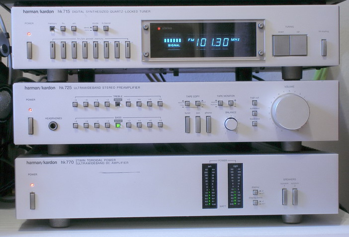

So - Manu and his Padawan (Manu is my Master of Hedonism ) came in possession of two almost identical Towers/Turms of ancient drek ;
even Master "Ihaveitallinparts" , AKA Jaccovitty ...... is sorta jealous ..... and that certainly means more to me , than fact that I have it in fact :rofl:
Manu - pictures please ....... (even if I know that you're pretty busy on Uni these days ) .....
just one tonight from me , with one link :
http://www.thevintageknob.org/THEVAULT2/HK700/HK700.html

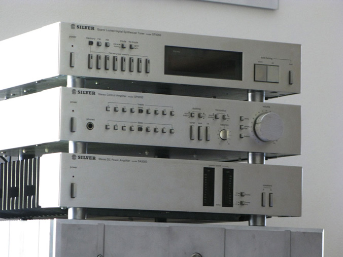

rarely known fact is that these models ( and probably some others ) are made in Japan - by Shin Shirazuna factory ( I must check exact spelling ;) ) ;
so - Shin made them as OEM products for HK ;
in same time - they're made under ( to me completely unknown ) brand
"Silver" for West German (and maybe some other part of European) market .
differences between HK and Silver were minor - logical in mains voltage selection , DIN inputs/outputs in case of Silver (were HK had usual RCA stuff ) , and few minor differences in schematics . I mean - really minor .

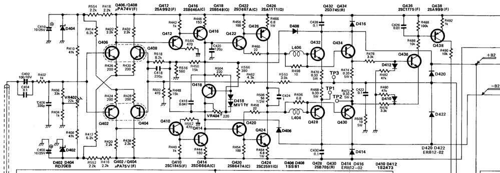

for tonight - there is just one more pic - part of HK770 amp schematic - one output channel shown
PSU voltages - +/-50V for input/driver stage , +/-40 for output stage

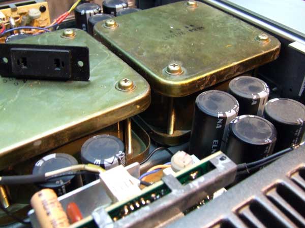

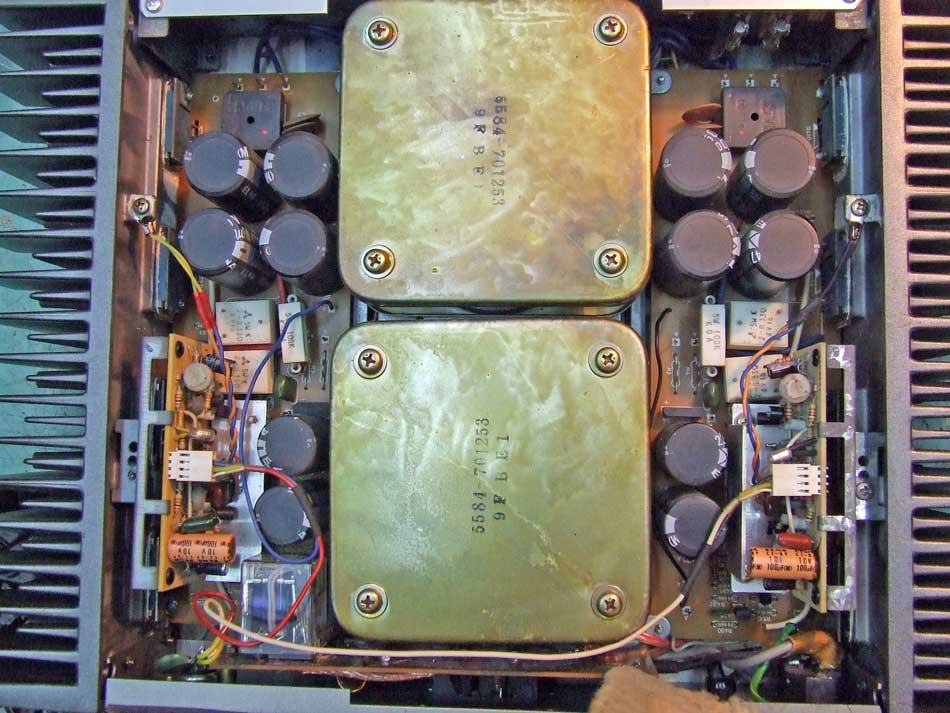

I forgot to say that Manu get them for ~150 Euros , meaning two sets , each for that amount ;
we don't have tape decks ...... so "just" preamp , amp and tuner ;
they're real sleepers ; amp have visible Otala signature , and preamp is sorta discrete OP , with Jfet inputs .
I'll post ( hope , Manu too) more pics ,along with my usual rumbling about "improving" already nice pieces of gear ........
there are few flaws ( from engineering point of view ) but they will be corrected .....

I suspect from your post that you already have the schematic for the power amp. If you do, could you send it to me, I would like a copy for my archives, and to study and learn from.

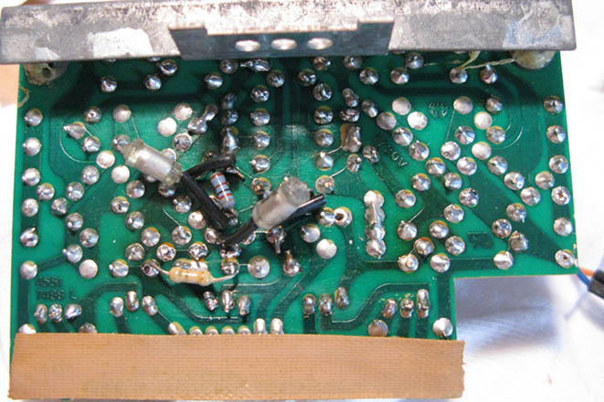

One channel of HK amp was defekt ...
(I said "was" because said module is now healthy, enjoying vacation in Serbia ... :rofl:
Pre is also defekt.
(but Tuner is working ... hehe)
Pic shows one of driver board of HK amp

Manu said:
And subito came the proper punishment :
Pre is also defekt.
yup ;
that little boardie is resting in Silver drek in Serbia , while Silver boardie is resting in HK drek in Ostrich :clown:
clone is a clone is a clone ......... :rofl:
