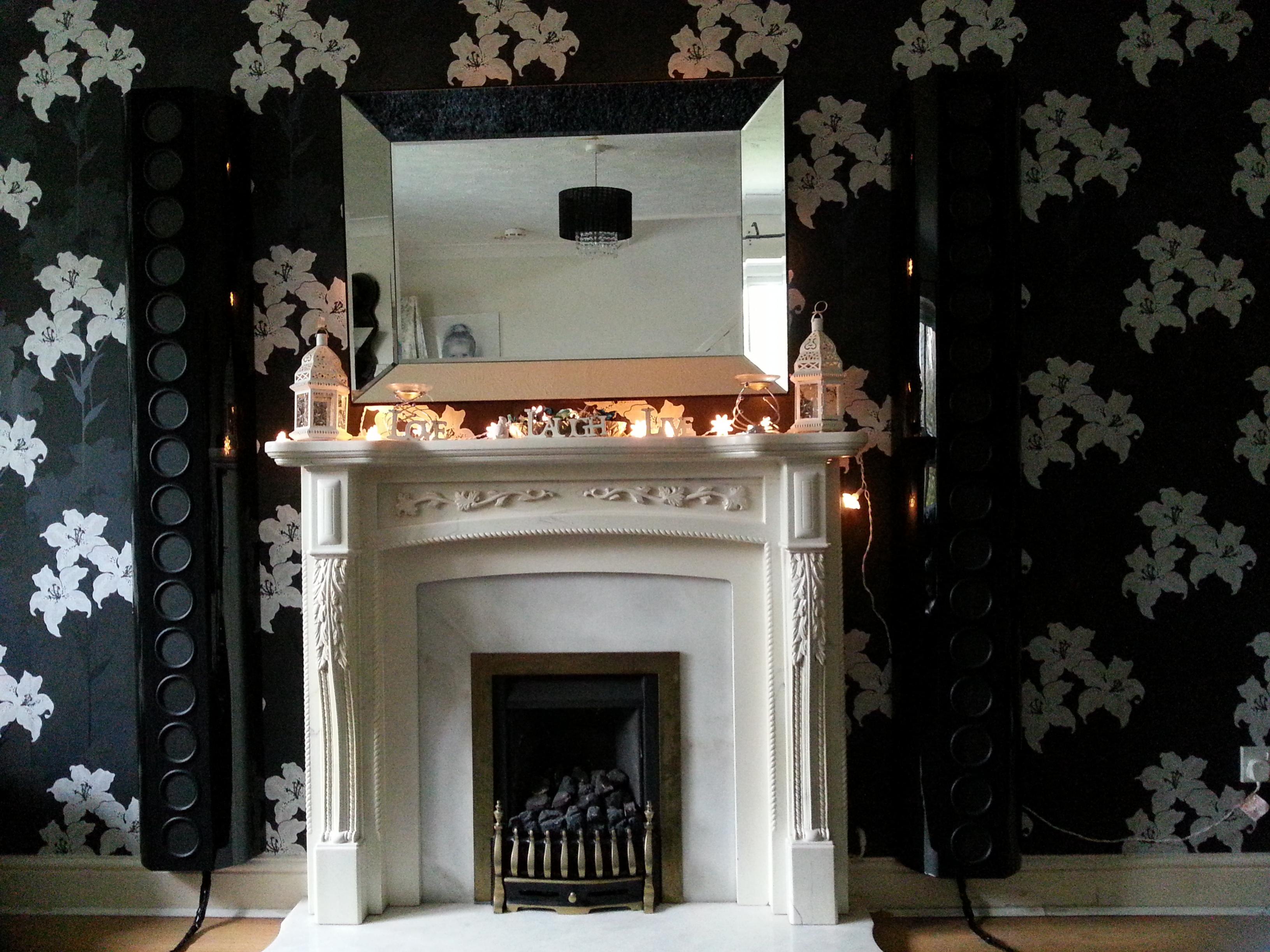

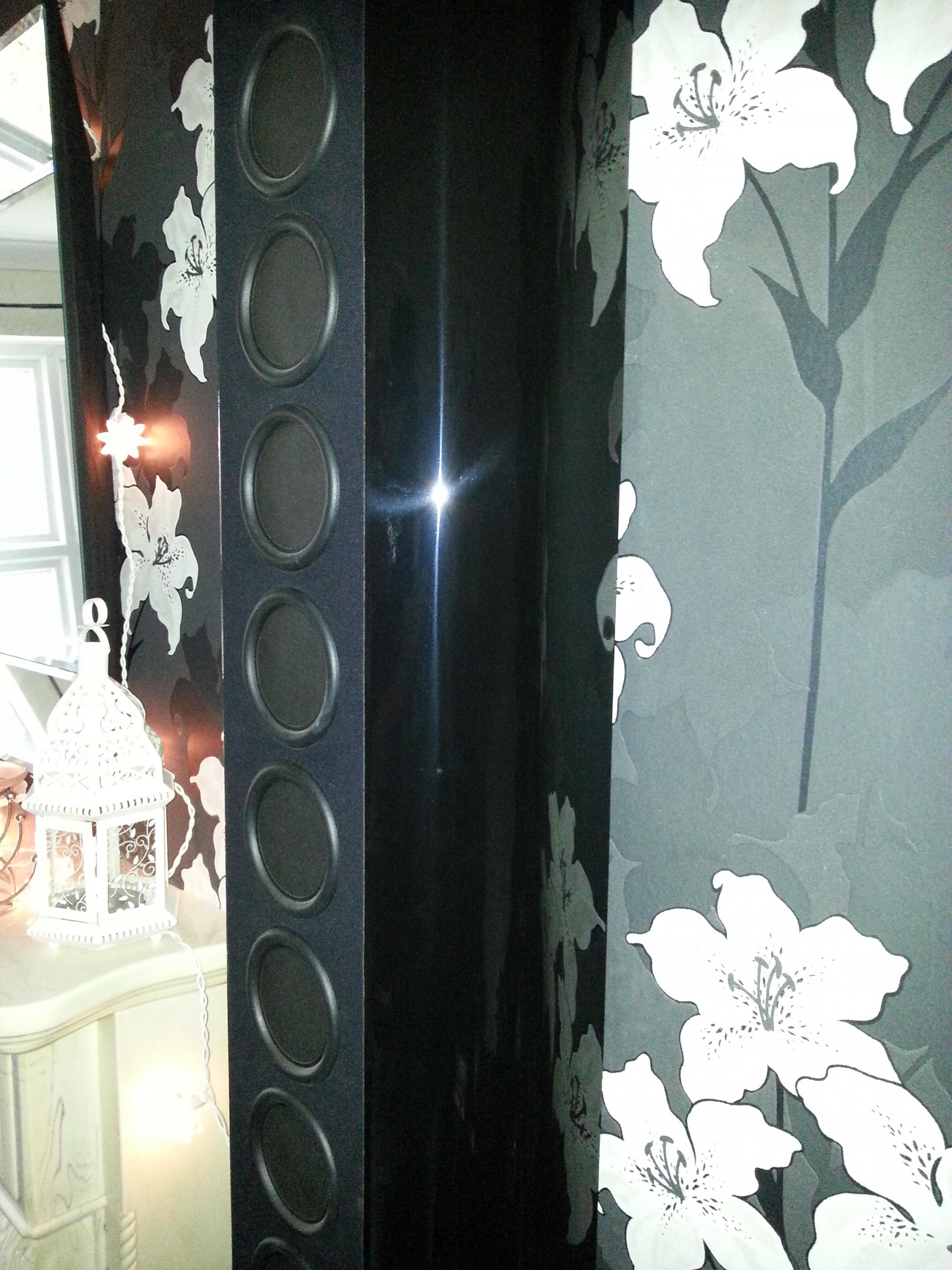

Final solution...
Hiya,
For me its now all about line arrays (on wall or in wall) for two channel and home cinema.
The Manger really spoiled me, it was and is stunning, but not perfect ( nothing is) and it requires massive ££££ to be spent on the bass and low midrange, (three way is optimum) and only state of the art DSP based crossovers will do it justice.
Now I have developed a version of the little 4.5 inch Neo magnet BMR which is specifically designed for multiple driver line arrays and or panel layout.
It breaks all the rules and leaves people gobsmacked...
It does not require any crossover at all!
Plus when used in line arrays of 9 or more has true full range bass performance as well as gorgeous mid and top.
It can also be used in singles, I replaced a Dynaudio tweeter with one of my BMR's, crossed it over at 200Hz using an old AV amp...It was a huge upgrade over the passive crossovers and silk domes....I will post a pic in a mo.
£50 per driver Vs £500 plus for the Manger also helps make it attractive!

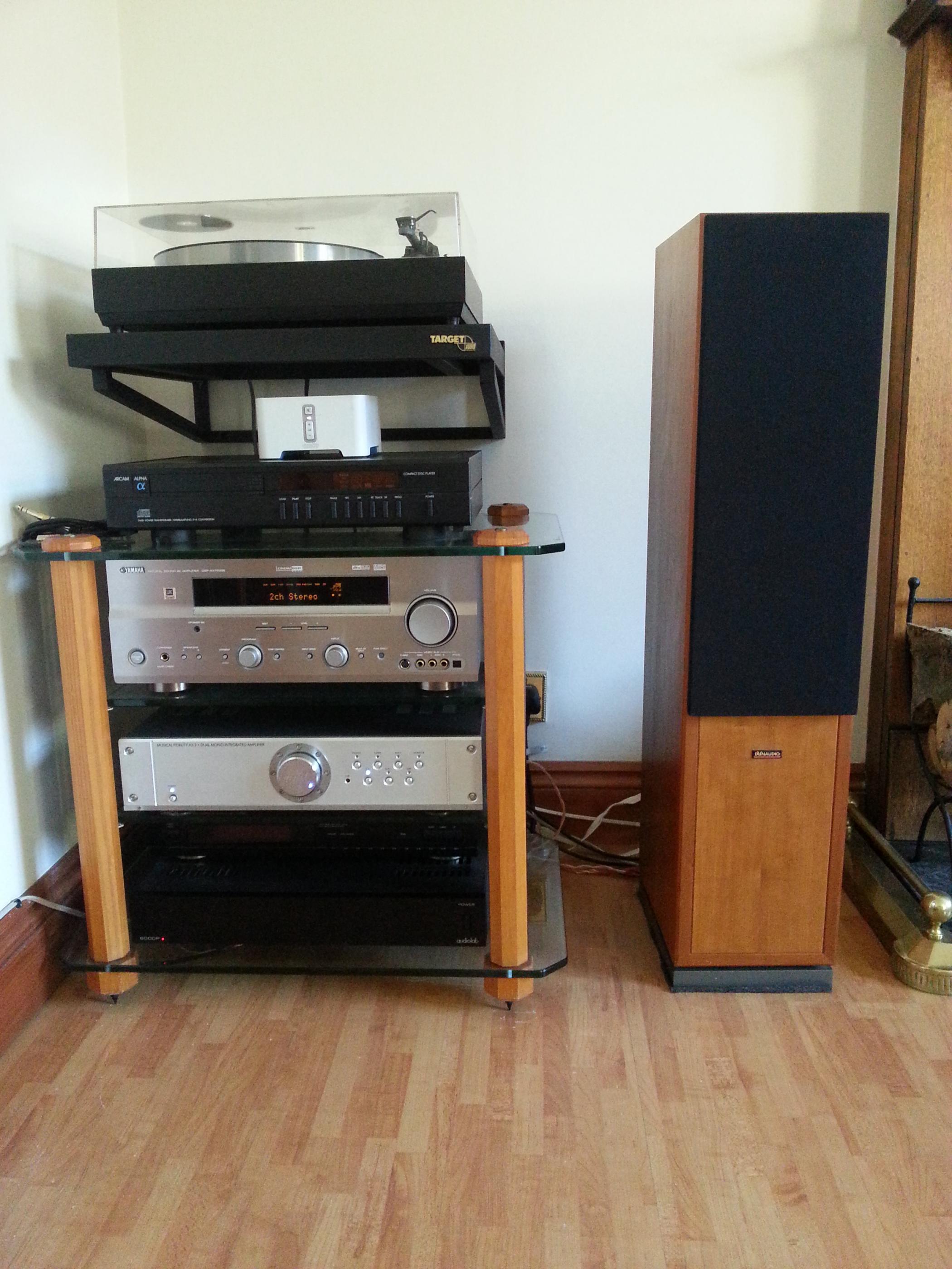

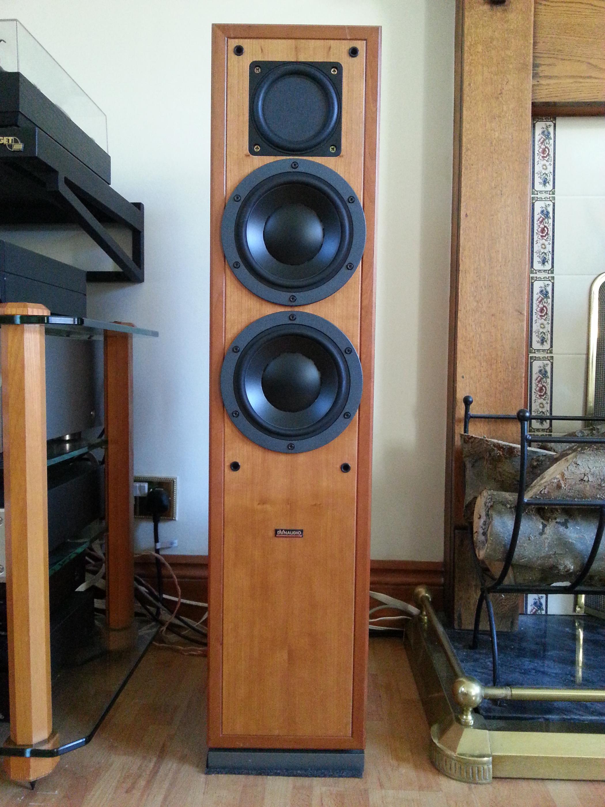

BMR replacing Dynaudio silk dome tweeter
This was very interesting...
Really big upgrade converting passive two way Dynaudio's to active " wide bander plus sub"...
The guy who bought them is a key board player and top class session musician, he is over the moon.
I must admit even I am pretty stunned by just how great these little speakers sound.
Active crossover is via the old Yamaha AV amp, Johns Musical fidelity amp powers the BMR and an old Audiolab power amp drivers the Dynaudio 6.5 inch bass drivers.
I also replaced the useless pillow stuffing and packing foam use in their speakers with proper felt dampening and Twaron stuffing.

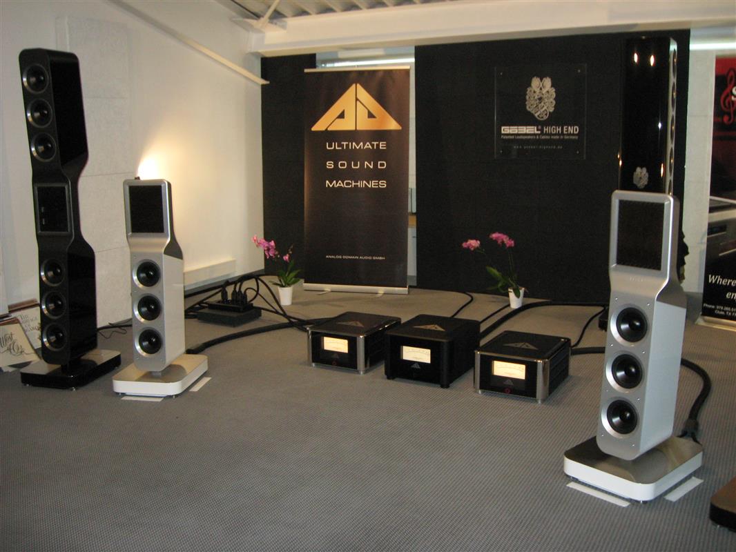

Here's another speaker that uses the bending wave principle. Göbel.
attachment.php
With a low crossover and complete coverage of the vocal with the bending wave driver, the sound is encredible coherent. Just too bad the effiency isn't higher. I missed the transient response and dynamics of horn.

More Bending wave drivers...Yea!
Thanks Omholt...These look cool!
Would love to hear them some time.
I know what you mean about horn dynamics....When I used the Manger in the big front loaded horns ( see a few posts back) they sounded even better than in a sealed box....Just so big and ugly!
Also not safe with young kids running around, very heavy, turned from a giant solid block of MDF.

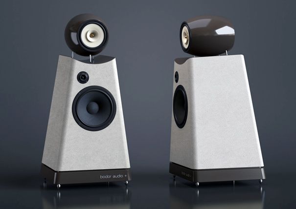

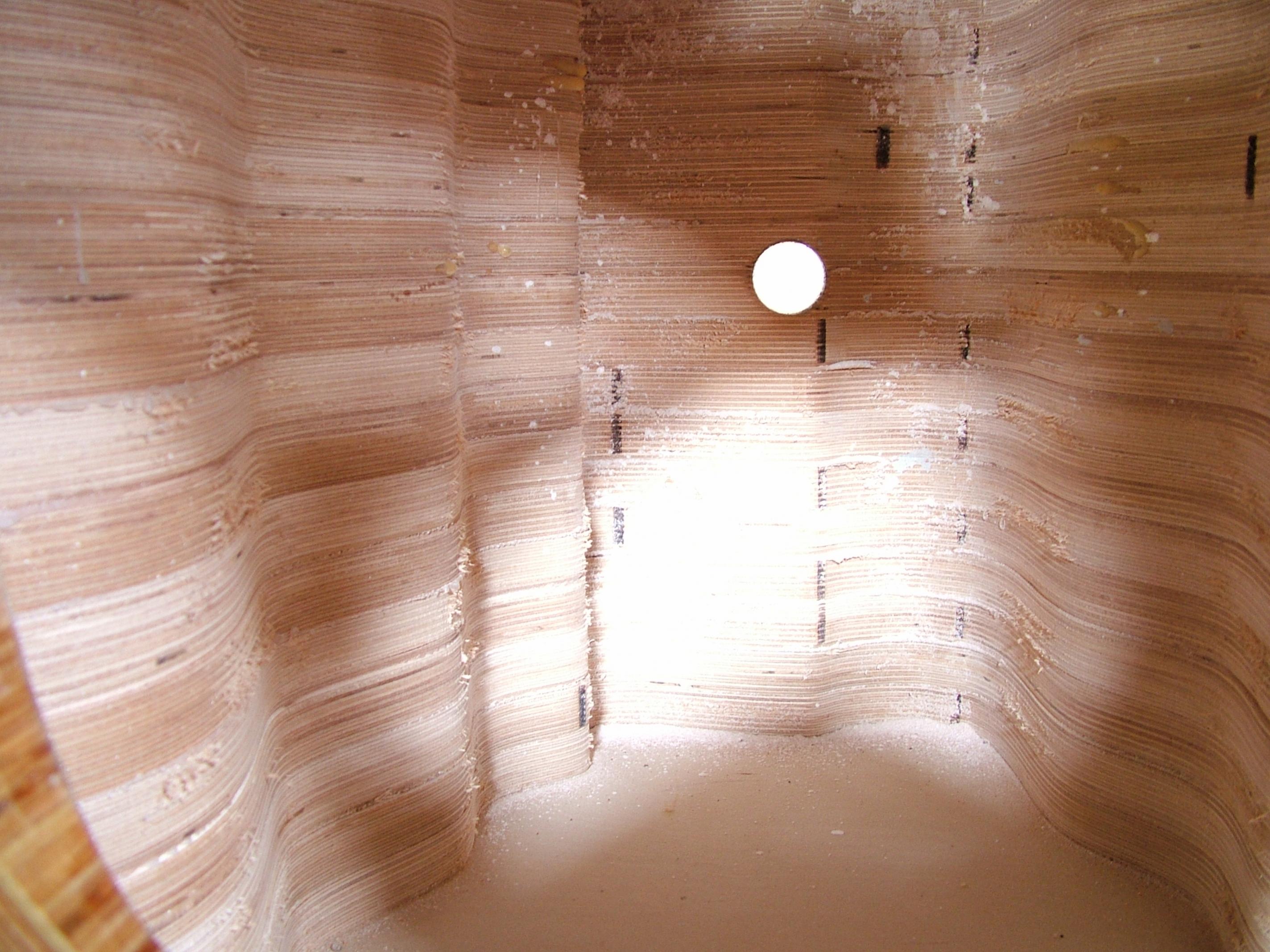

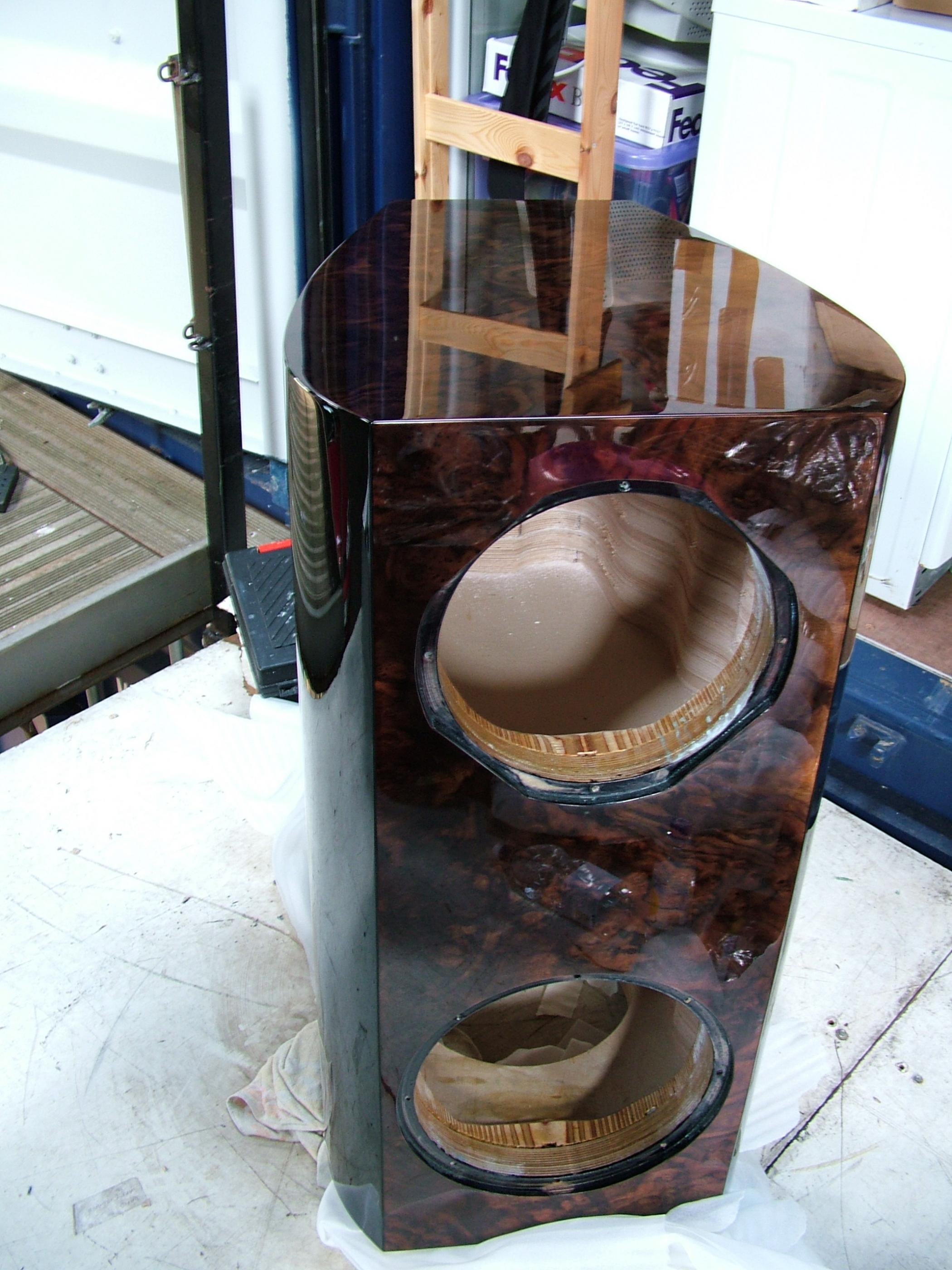

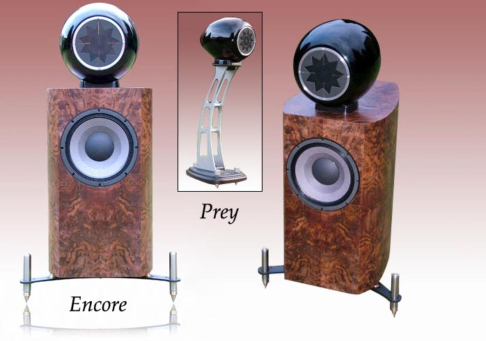

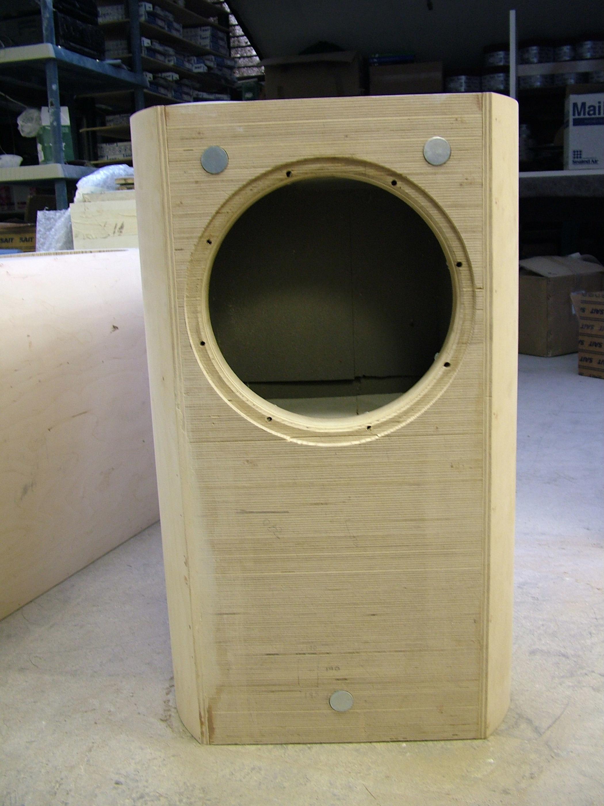

Ovation & Encore
PS
I think these guys might actually have combined the looks of my earlier design, the "Ovation" and the "Encore"...
But they didn't manage to copy the multi layer plywood construction...
135Kg per bass cabinet not including Manger head unit and Sistrum stand...
Or the cladding with curved ply sides and then real wood veneer and piano black with 16 coats of Polyester lacquer...Overkill by name Overkill by design!
Ah how I miss the glory days...Not...Shipping and Installing them was a logistical nightmare!
Anyway, onwards and upwards.
Cheers
Derek.
That's top notch work and finish Overkill, I wish I could do some like that. (not with manger). All I have is drill and jigsaw. Anyway, I am working on copy of Marantz LS-85, trying to make it as nice as possible, but it will be far from perfect. But for me the sound is always first, looks second.
