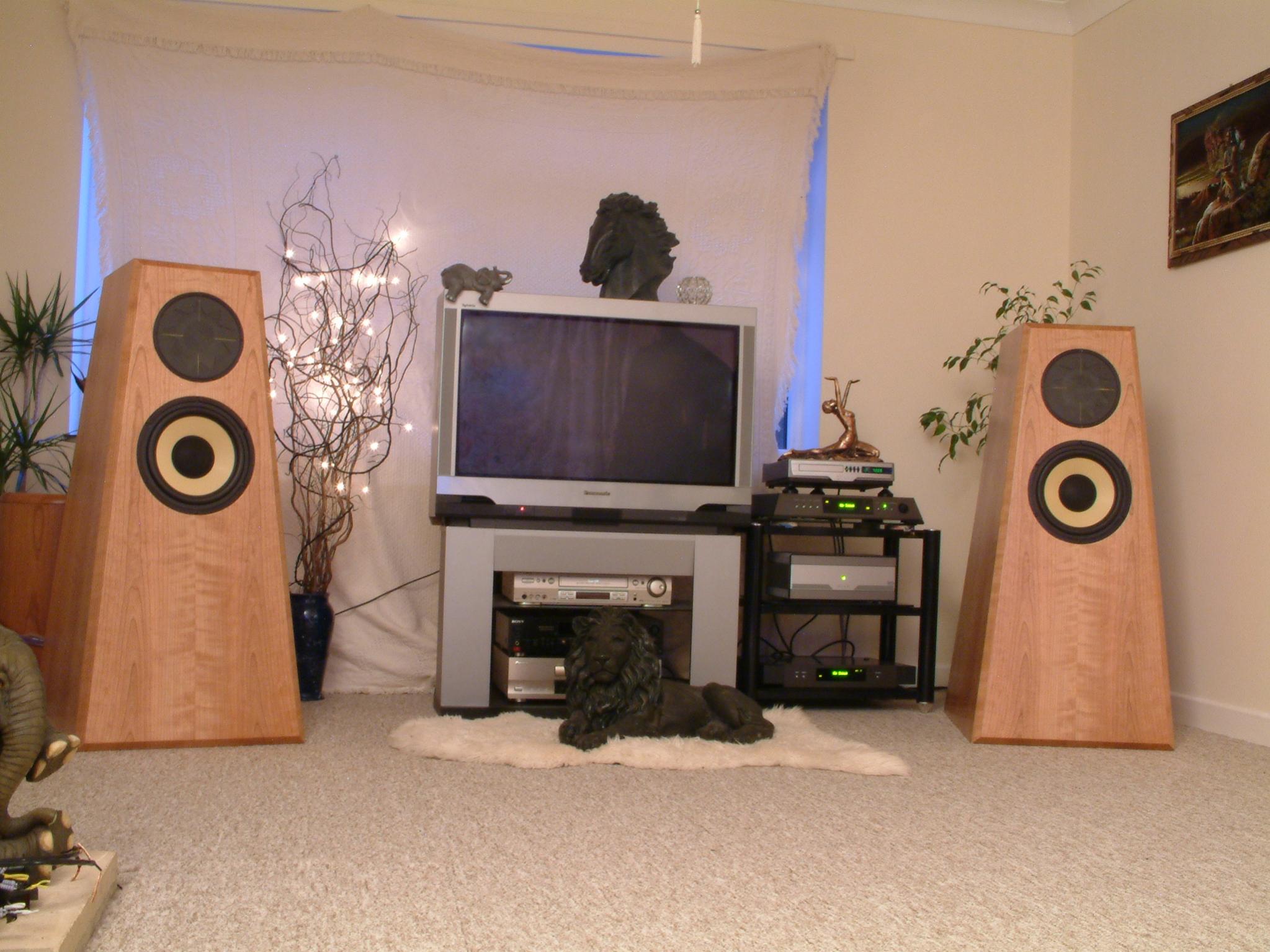

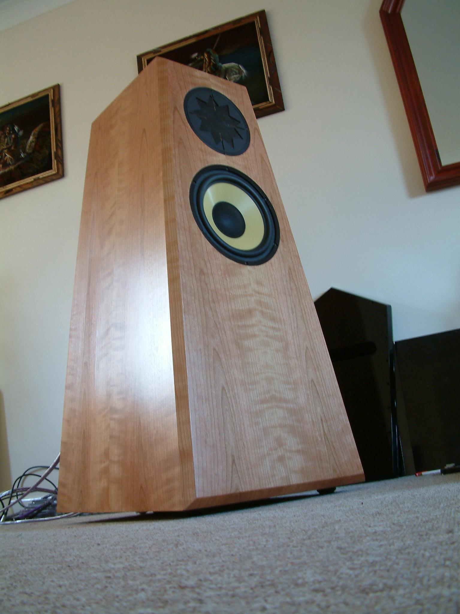

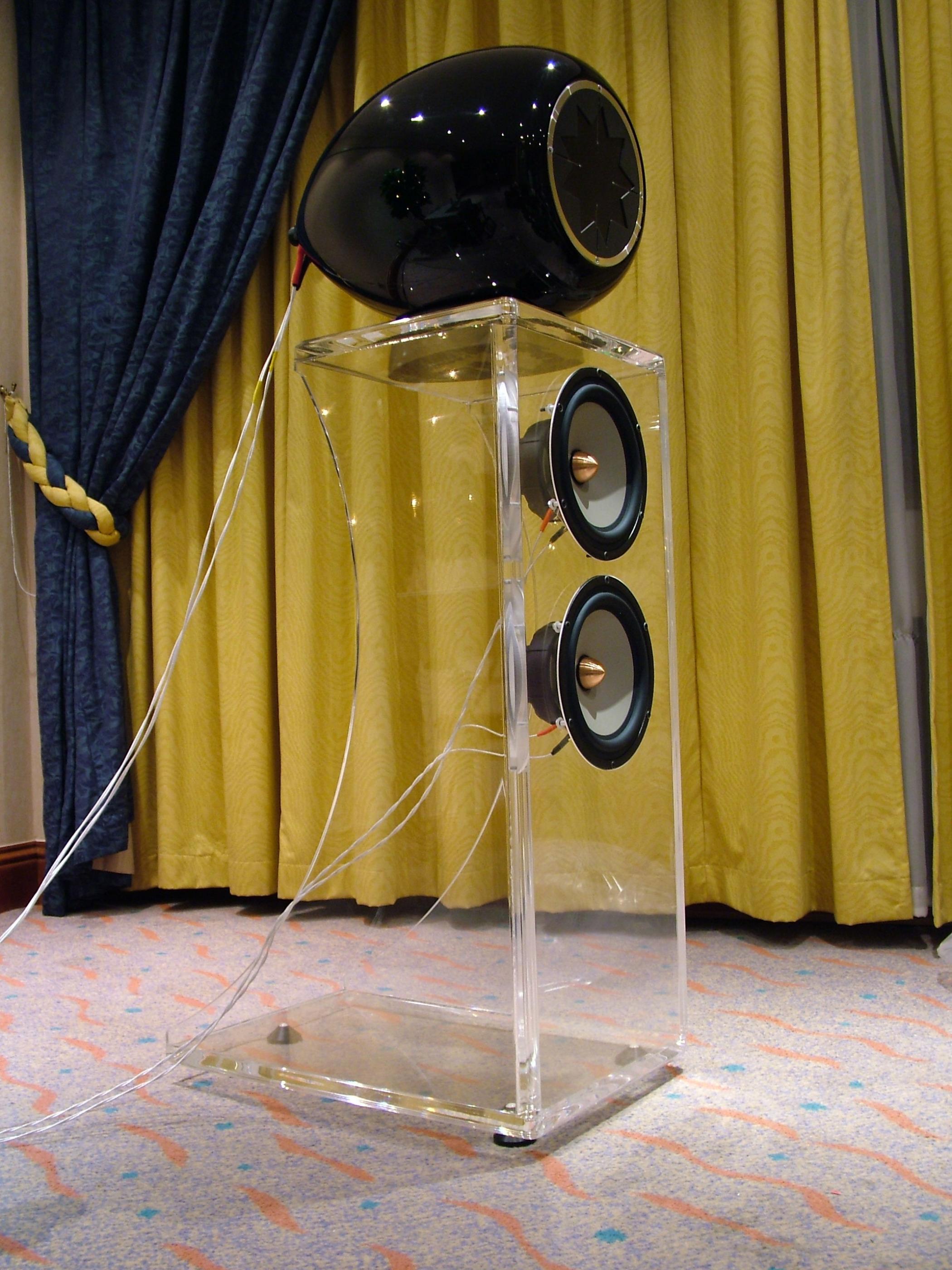

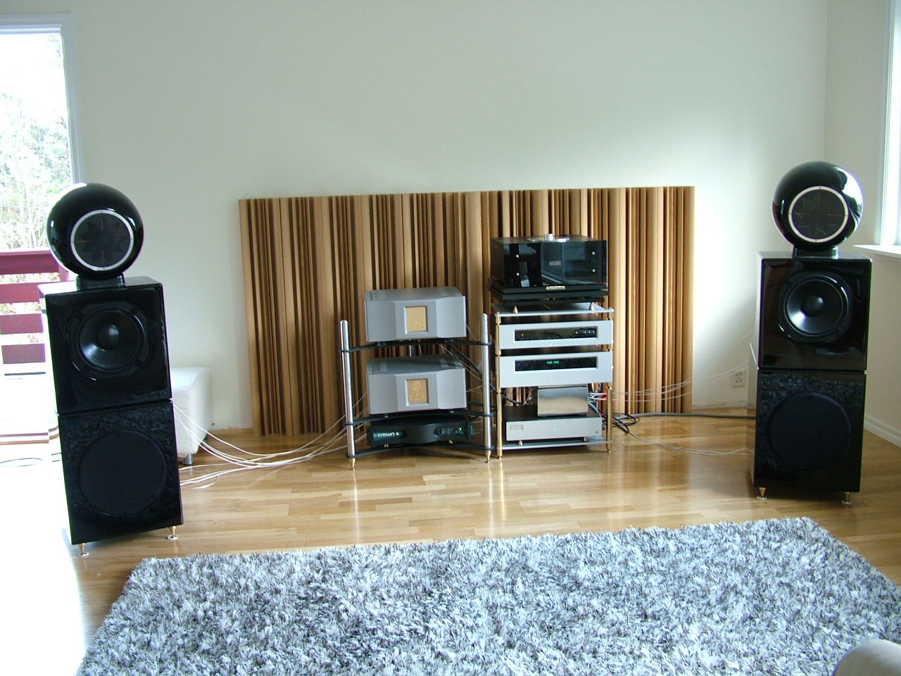

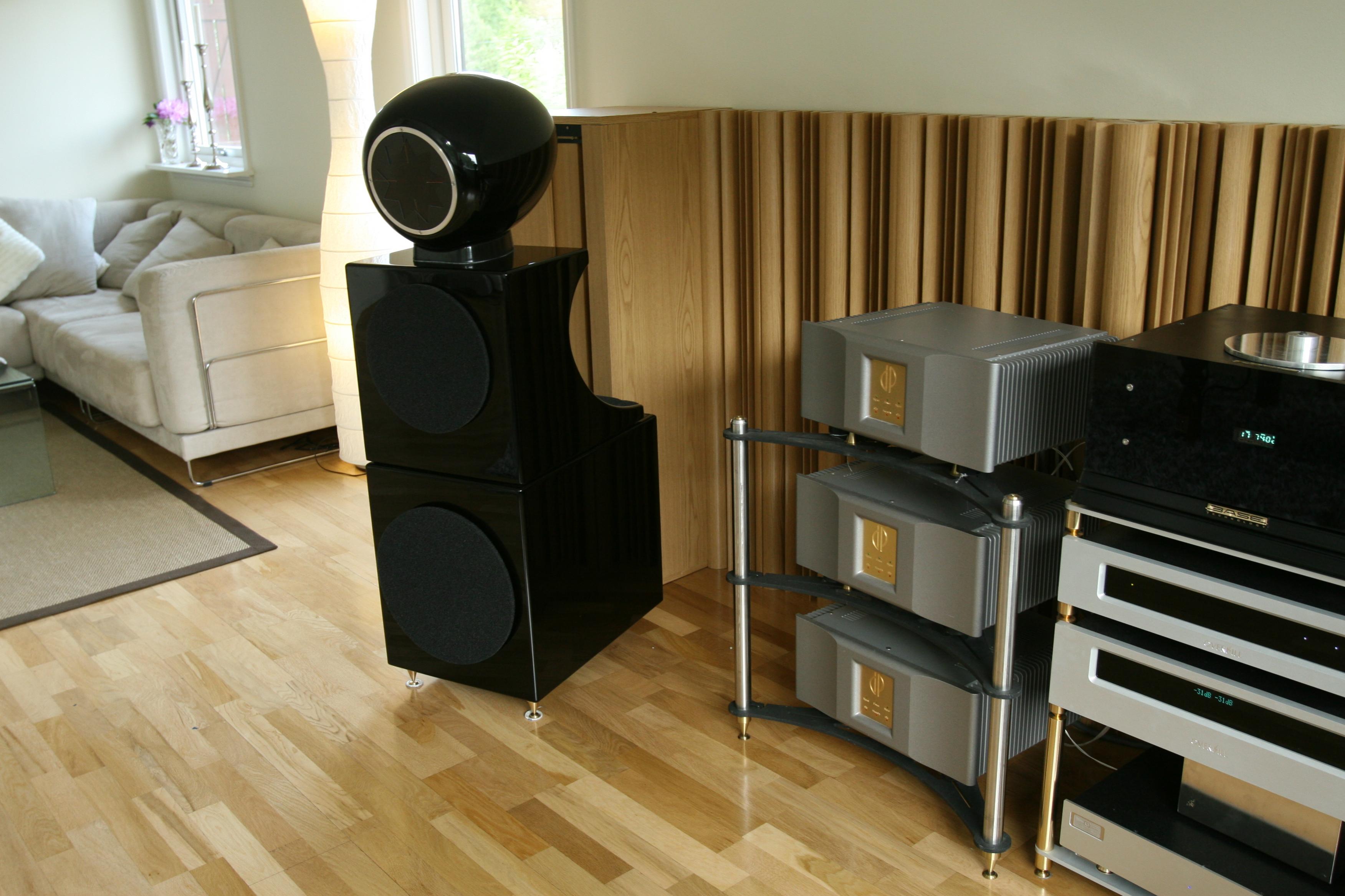

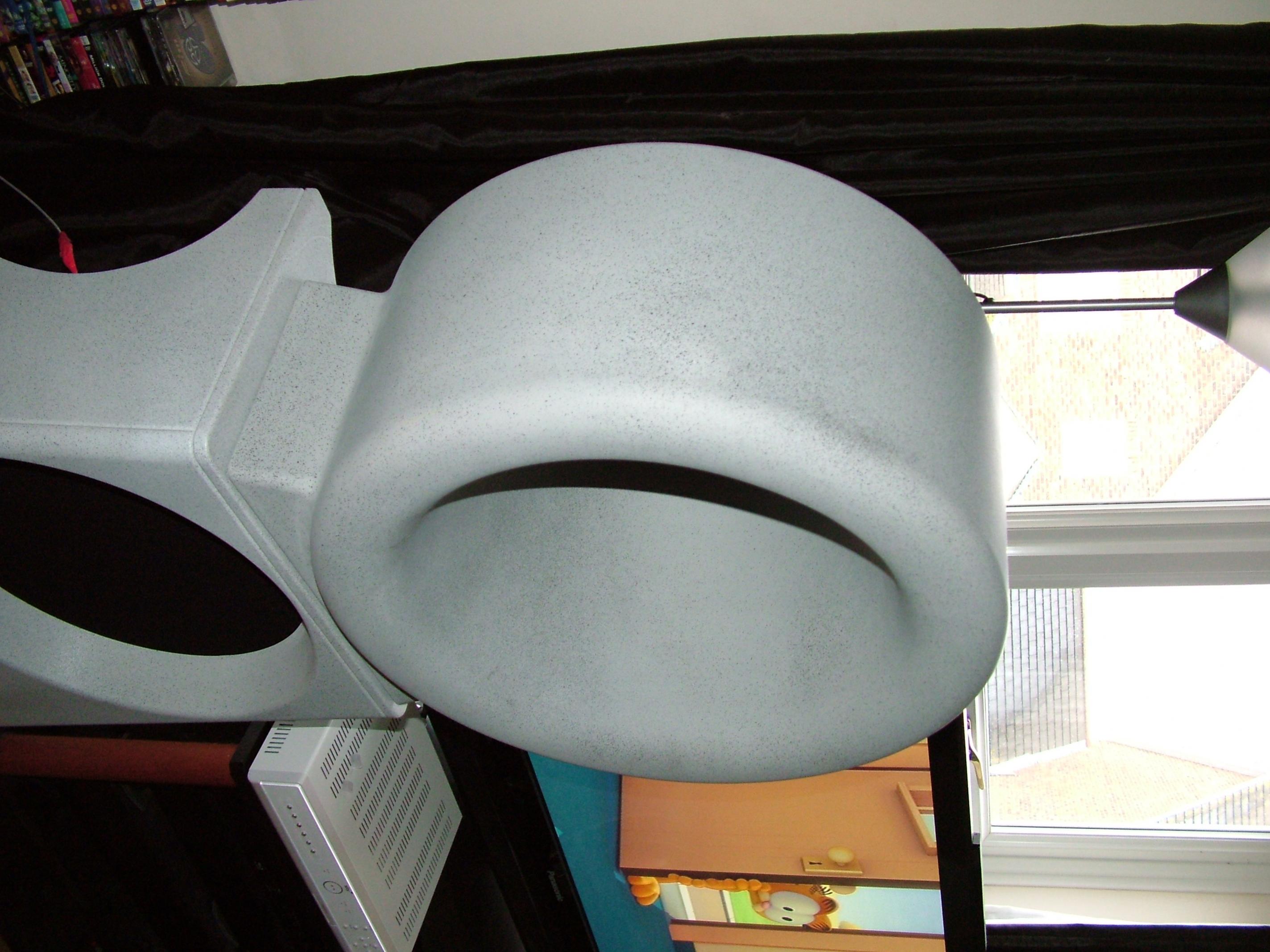

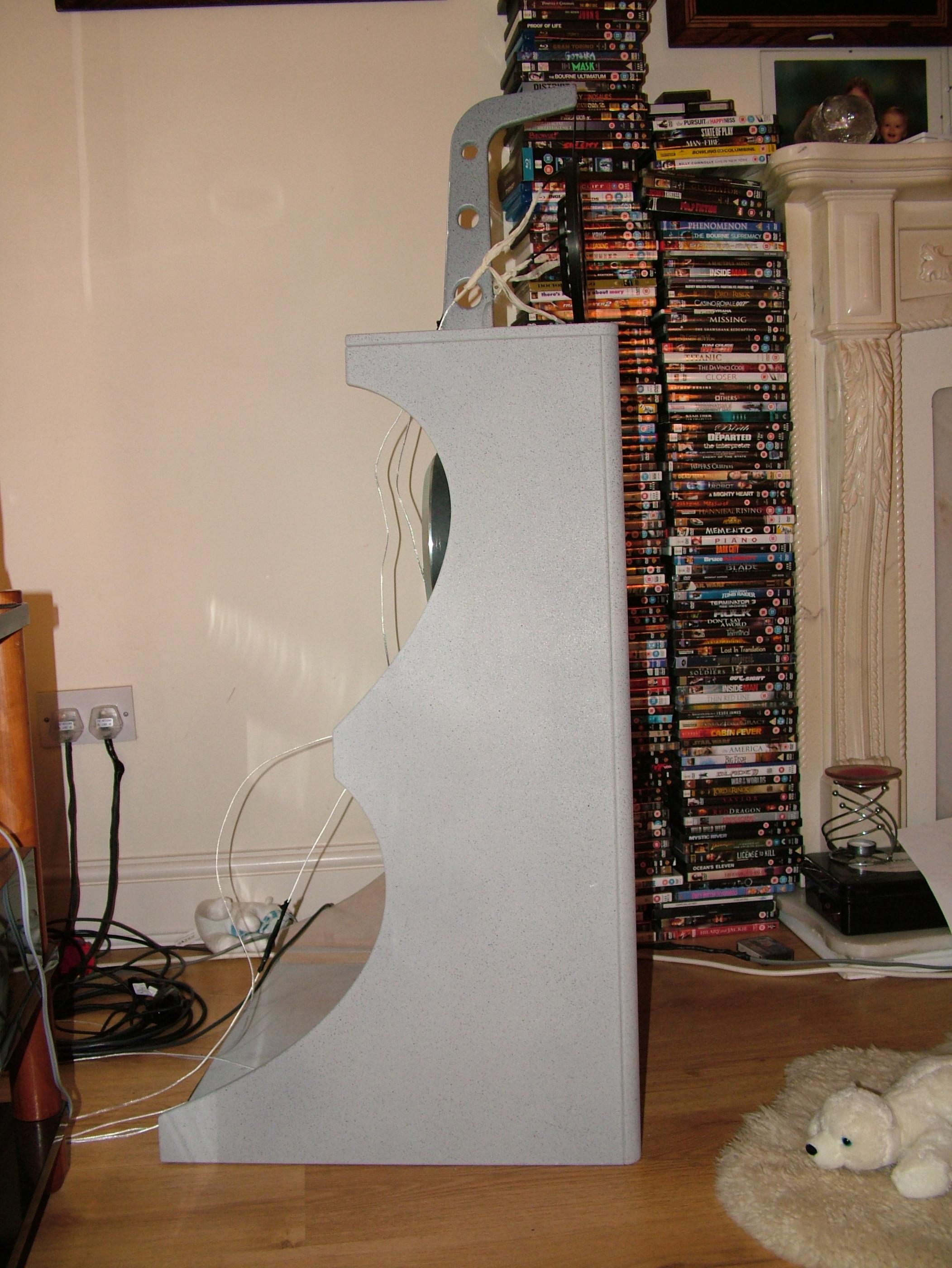

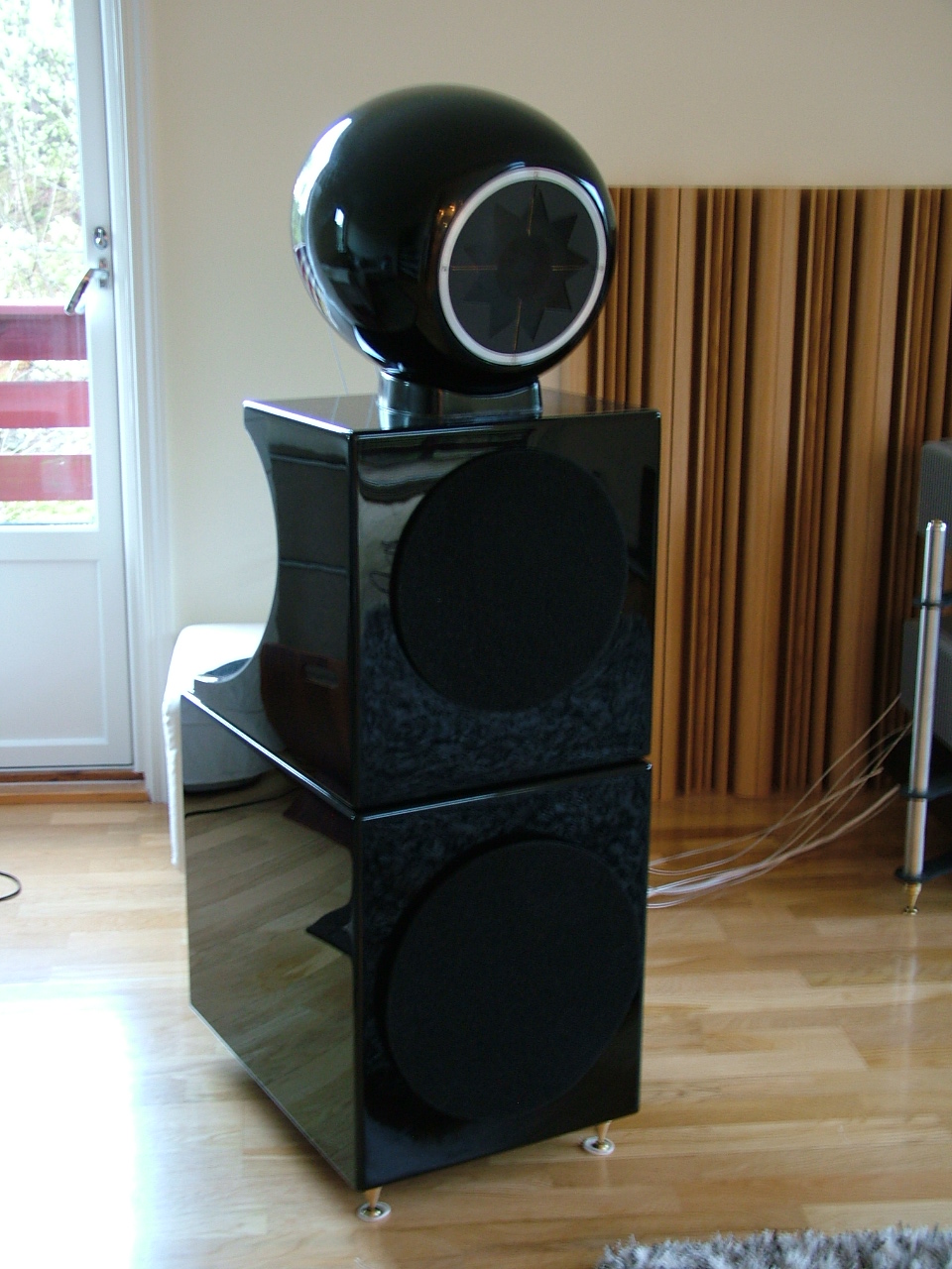

This was an absolute beast to build, but OMG it sounded fab...

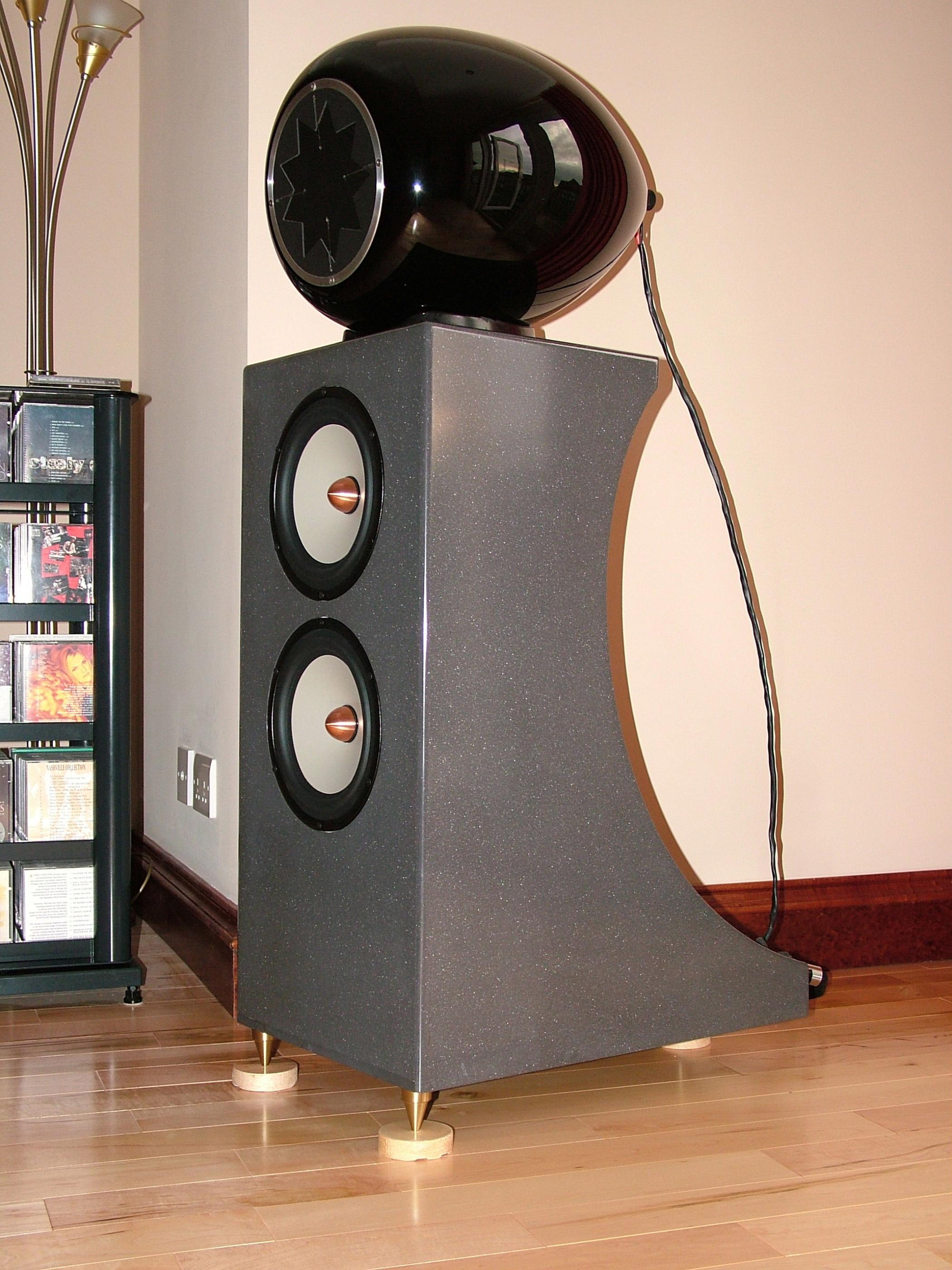

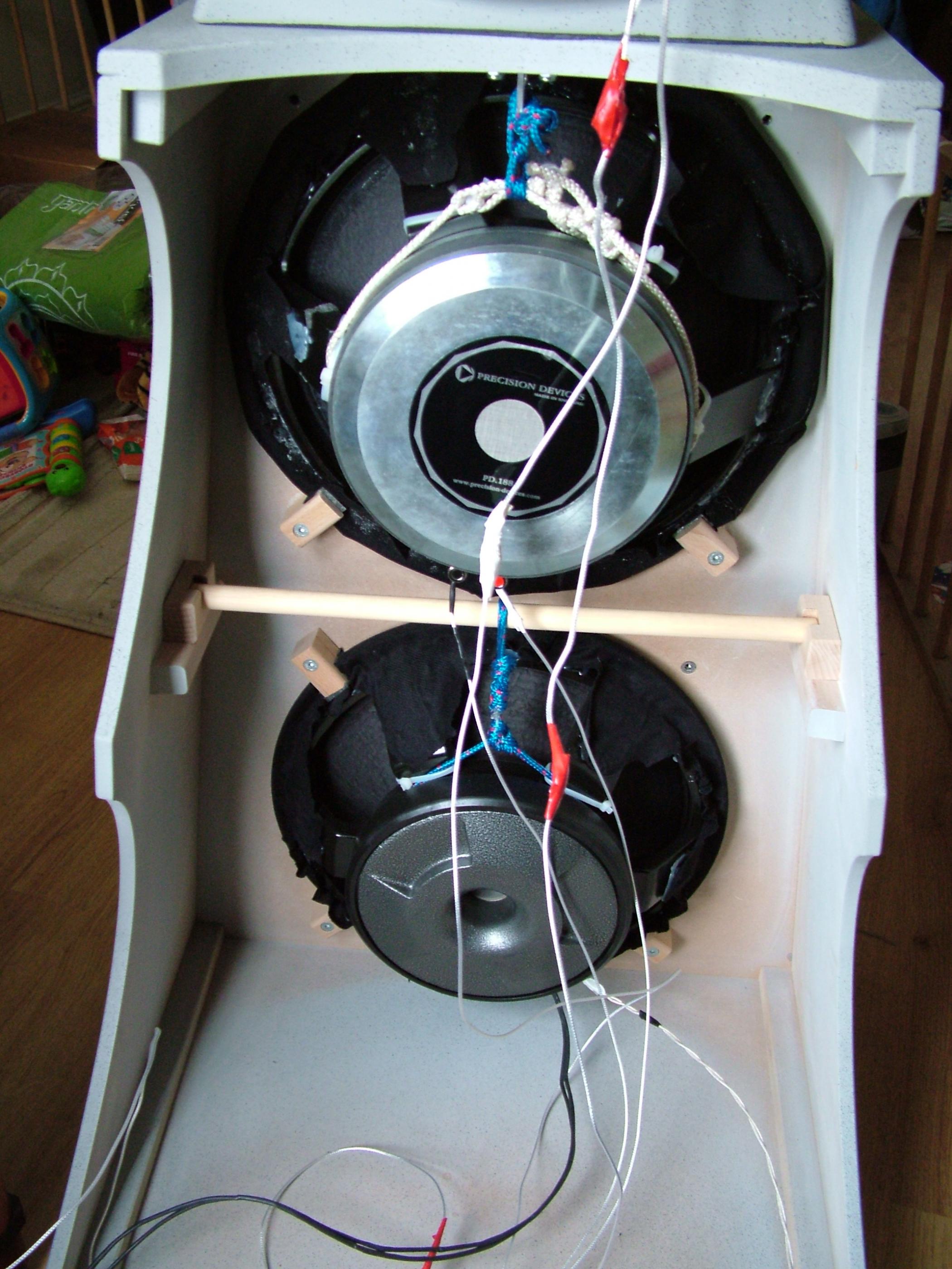

Beyma Pro 12 inch driver : 20Hz to 100Hz, in sealed Corian box
Volt BM 2500.4 : 100Hz to 400Hz in VPL open baffle.

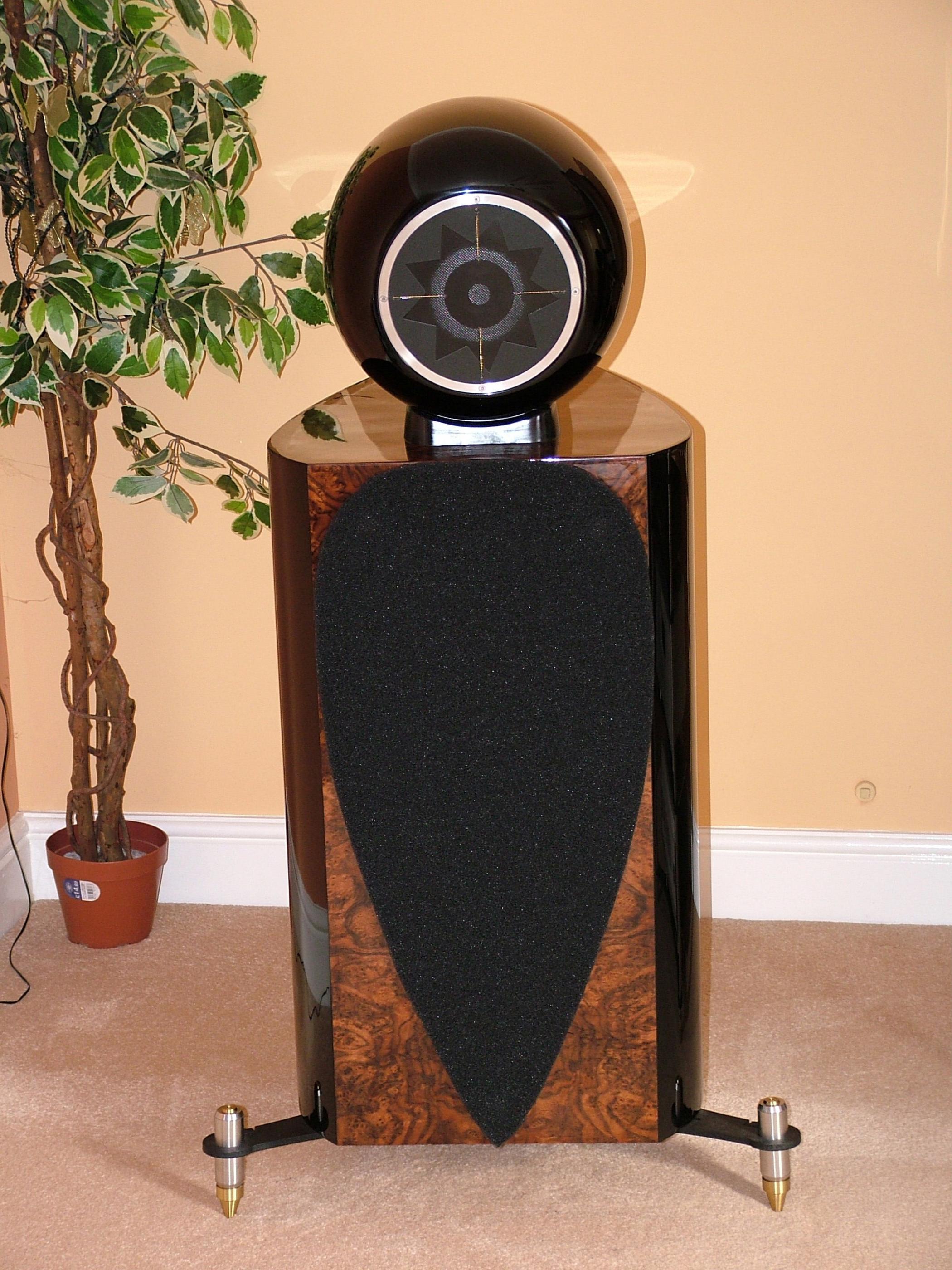

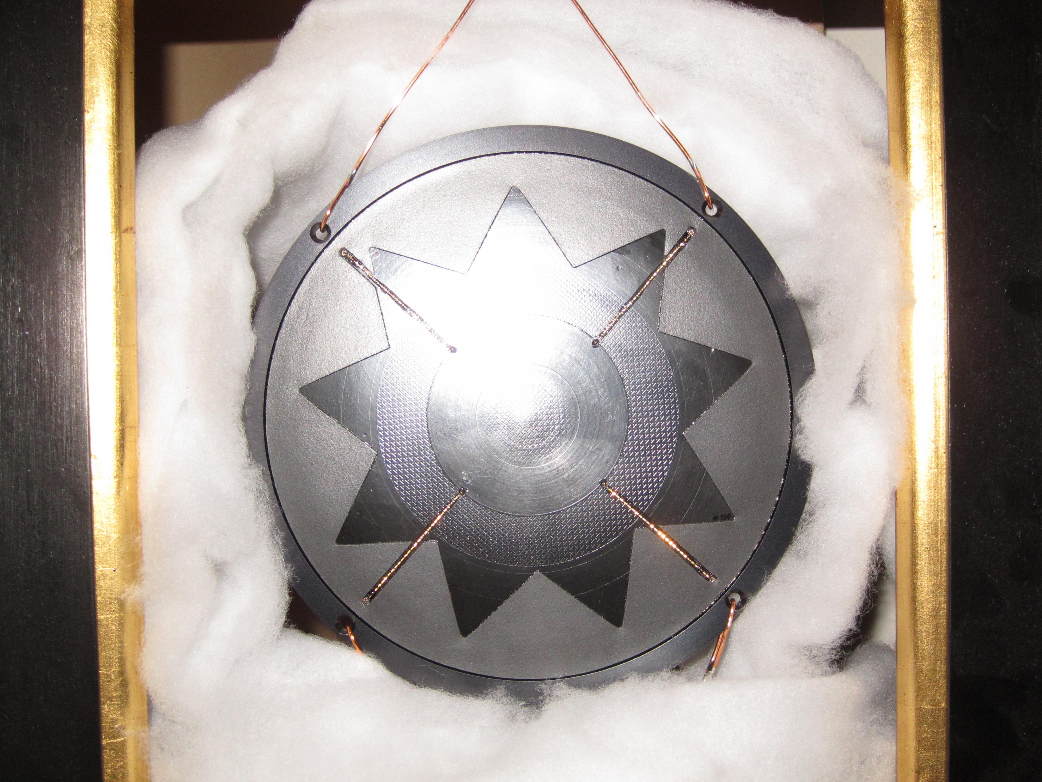

Manger 400Hz up : Sealed polymer teardrop cabinet with multiple layers of 5 different dampening materials and 3 different soft fibre stuffing.
Controlled by ultra modified DEQX and 6 channel DAC in a twin box design incorporated with Sistrum rack....Exhaustive development and engineering...So glad I am not in the ultra high end game any more!
I can concur with that. I heard the setup a few times and it sounded wonderful after some additional work with the crossover settings. Music was just flowing and it was so addictive.

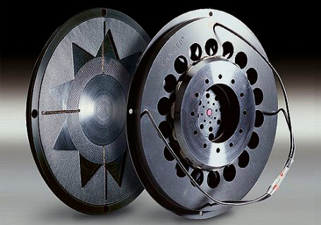

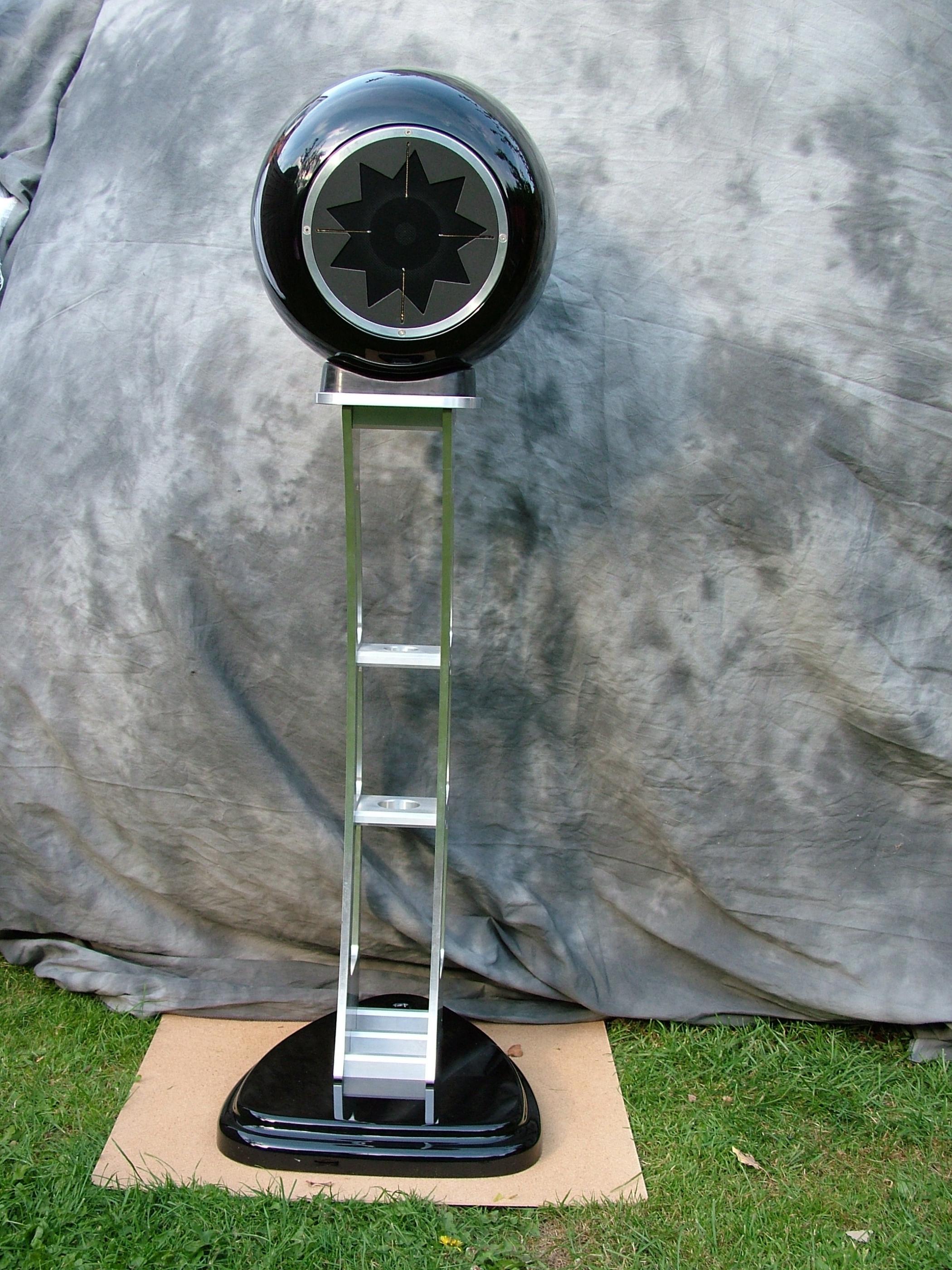

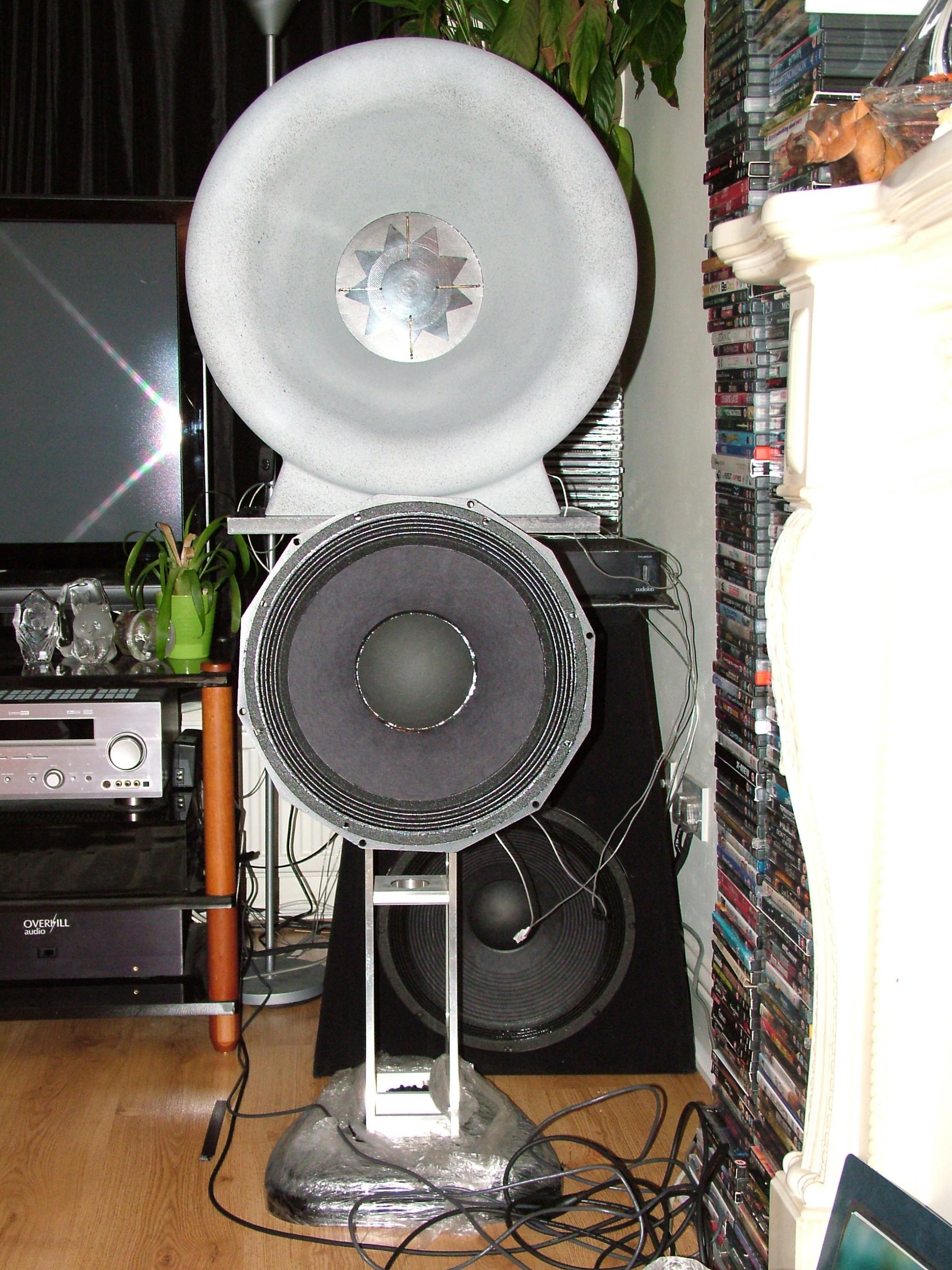

The Mangers sounded great in the 600mm diameter shallow horns, but measured with a lot of peaks and dips...
Some other guys who DIY'd Manger horns said the same and Daniela Manger thinks its BMR Vs pistonic sound generation that causes low level off axis sounds to mess up the measurements.
Never developed it any further as the horns were simply too big and ugly to use in the domestic market...Still got them in storage, buyer collects!!
