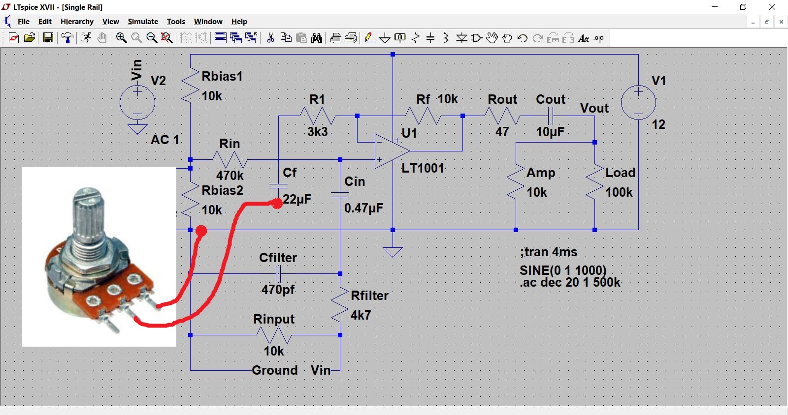

I have another question. Can I put potentiometer between Cf and R1 so I can lower the gain if I need to? The problem is that this preamp will be part of PA system and I can't rely on volume control on the laptop because ppl are always walking to the laptop pumping up the volume

You could use a pot like that. You would need to take care in the wiring to it (keep it very short) to avoid it picking up stray noise.
Always keep R1 in series with the pot, even if you fitted something like a 100k control. R1 prevents the gain going to high and the opamp crashing out when you get to crazy gain settings.
Yes, the end pin of the pot to ground (1st or 3rd, it depends which way up and which way you look at it) and then middle pin to Cf. Only two connections used, the other is left floating. The pot should be a linear type.
Ok, thank you very much. I just got parts for the filter(s). I will add filters and a pot.

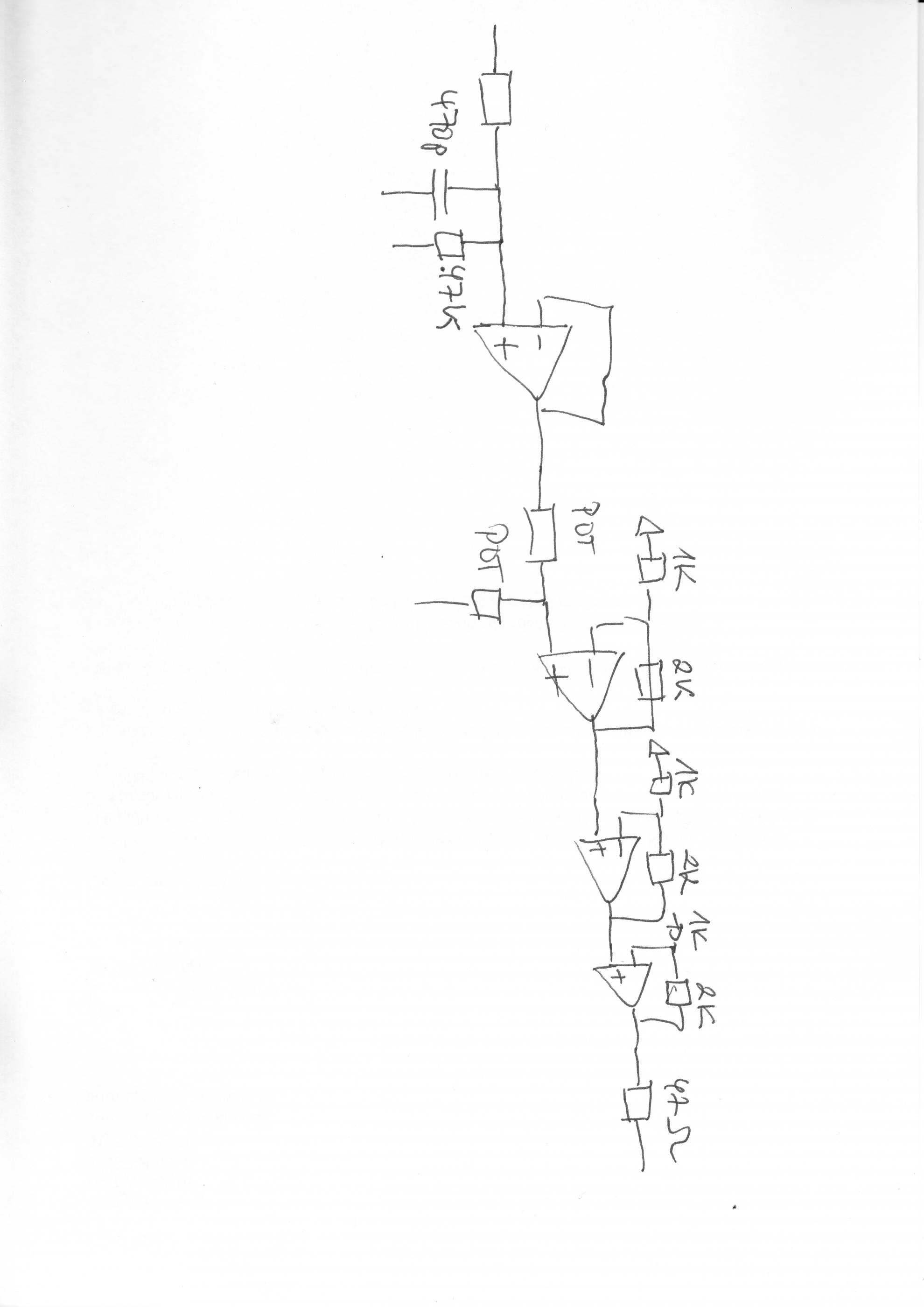

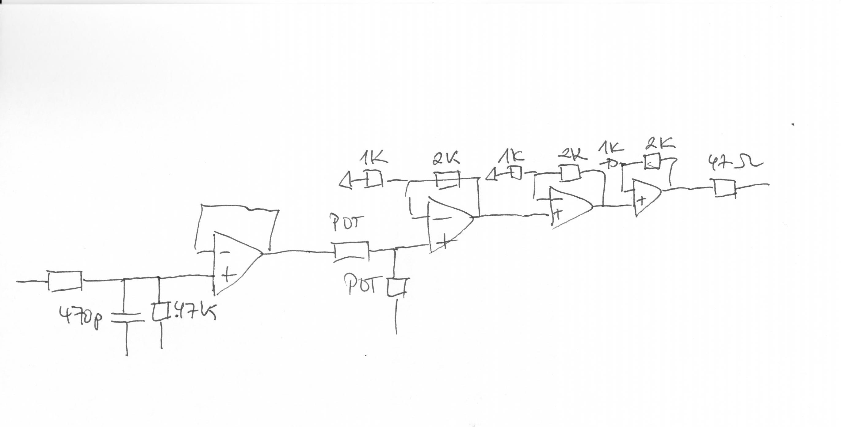

The schematics should be improved....
What part should be improved and what are the benefits? I like the way it plays, sound is clear and natural.

(You can always refine a design, and that is always best done by designing to a given specification that is drawn up in advance. This design was developed 'on the fly' as the requirements became known. Perhaps Keruskerfuerst could post one of his own offerings for perusal )
OK, its a valid design...... and everyone has their own ideas
My comments would be that the OPA1622 isn't diy friendly in VSOM (very small outline form). Its only 3 x 3 mm in size.
You've gone for a voltage gain of 27 (28.6db) in the three final stages. That's pretty high and I think more than the design brief called for.
Not sure on the twin gang pot arrangement. There are valid arguments not to pass the opamps bias current from the input pin directly through a wiper (noise and unreliability as the contact moves) although the arrangement would in practice work. You would be unlucky for both wipers to generate an OC condition at the same time. If that happened the opamp would crash out with a swing to one of the rails.
The circuit would need considerable redesign for single rail operation.
No DC blocking is incorporated which for a general application is always a good idea imo.
