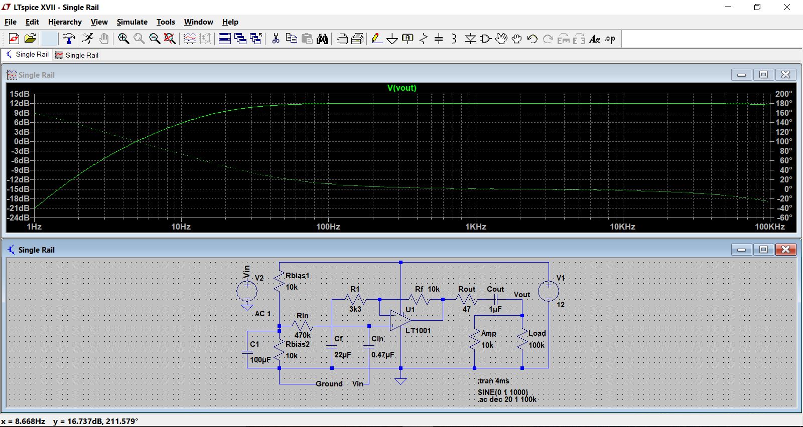

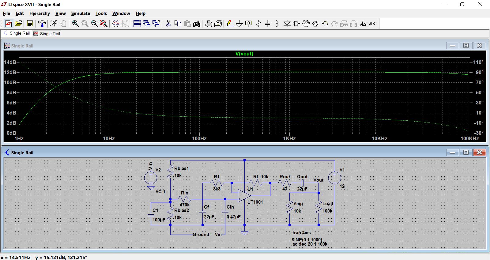

Have we got the right versions here... whatever, and surprisingly, both seem to give identical responses. Load the two images into a photo viewer and switch between them.

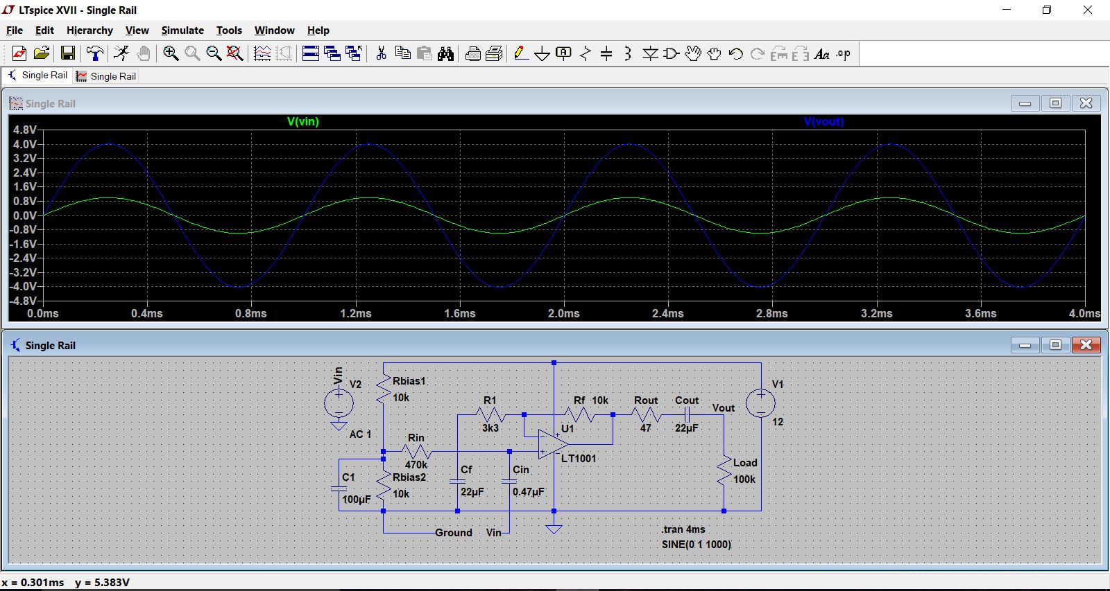

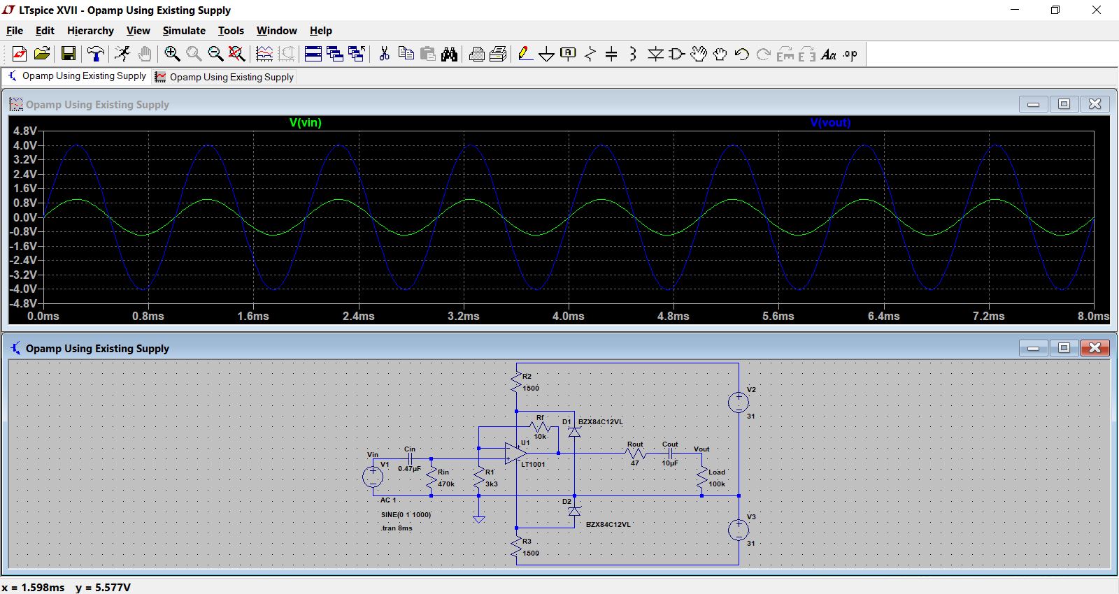

There is something in the simulation I am not happy with.
Does yours sound all right ? or does it distort or clip under certain conditions ?
The problem seems to occur when a critical gain factor is reached and yet this doesn't seem to dramatically affect the simulation of the overall response.
This is with just 10 millivolts peak applied. The circuit breaks into oscillation.
The feedback gain setting resistor is then reduced from 10k to 5k and all is normal.
