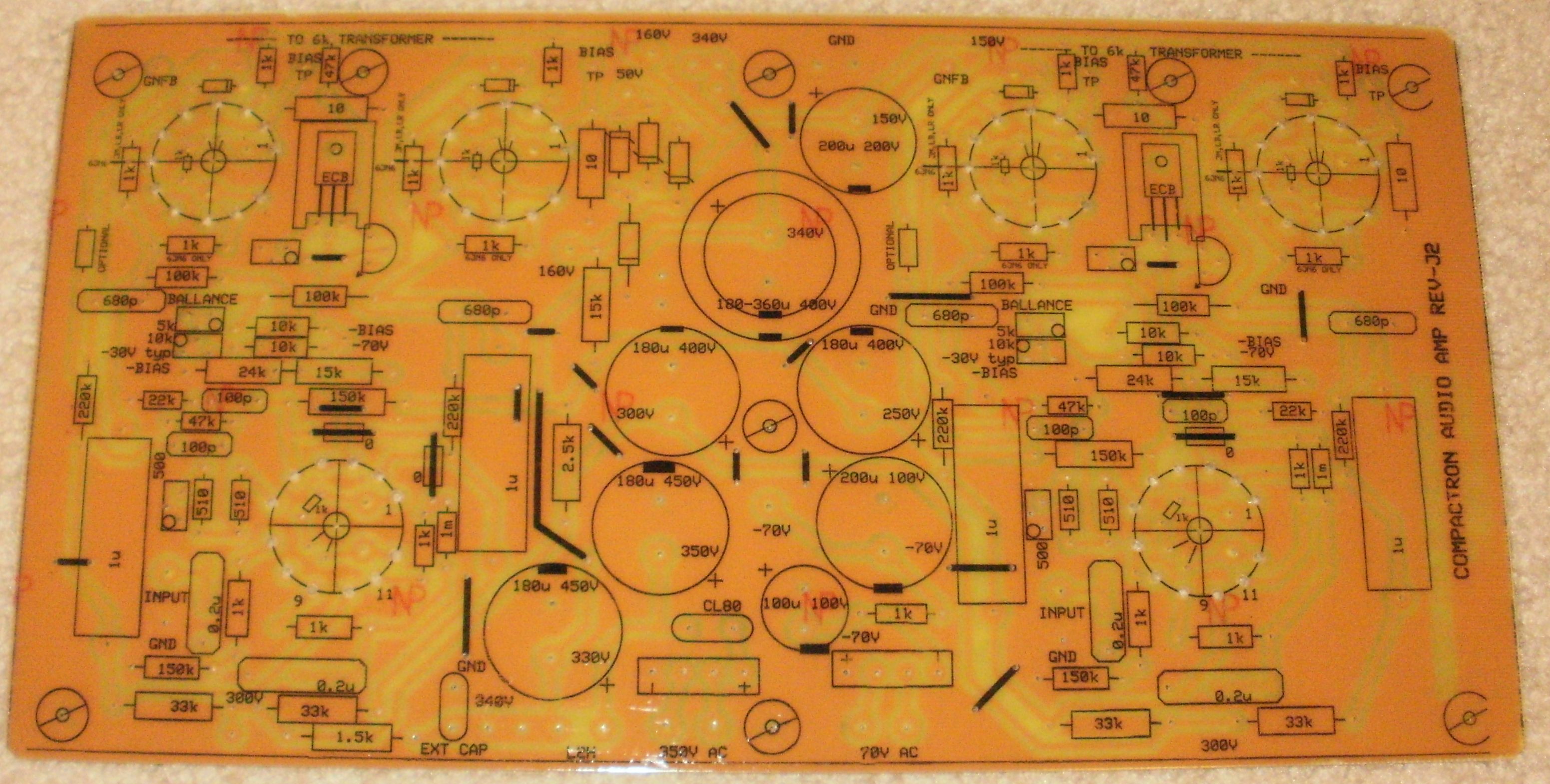

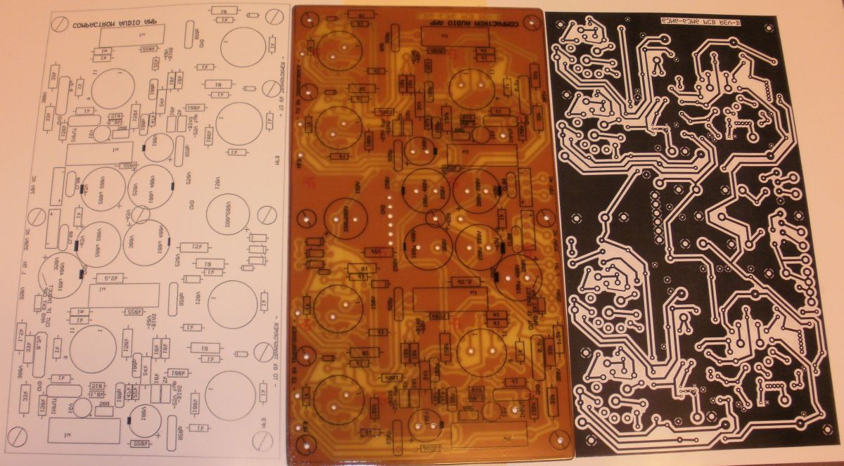

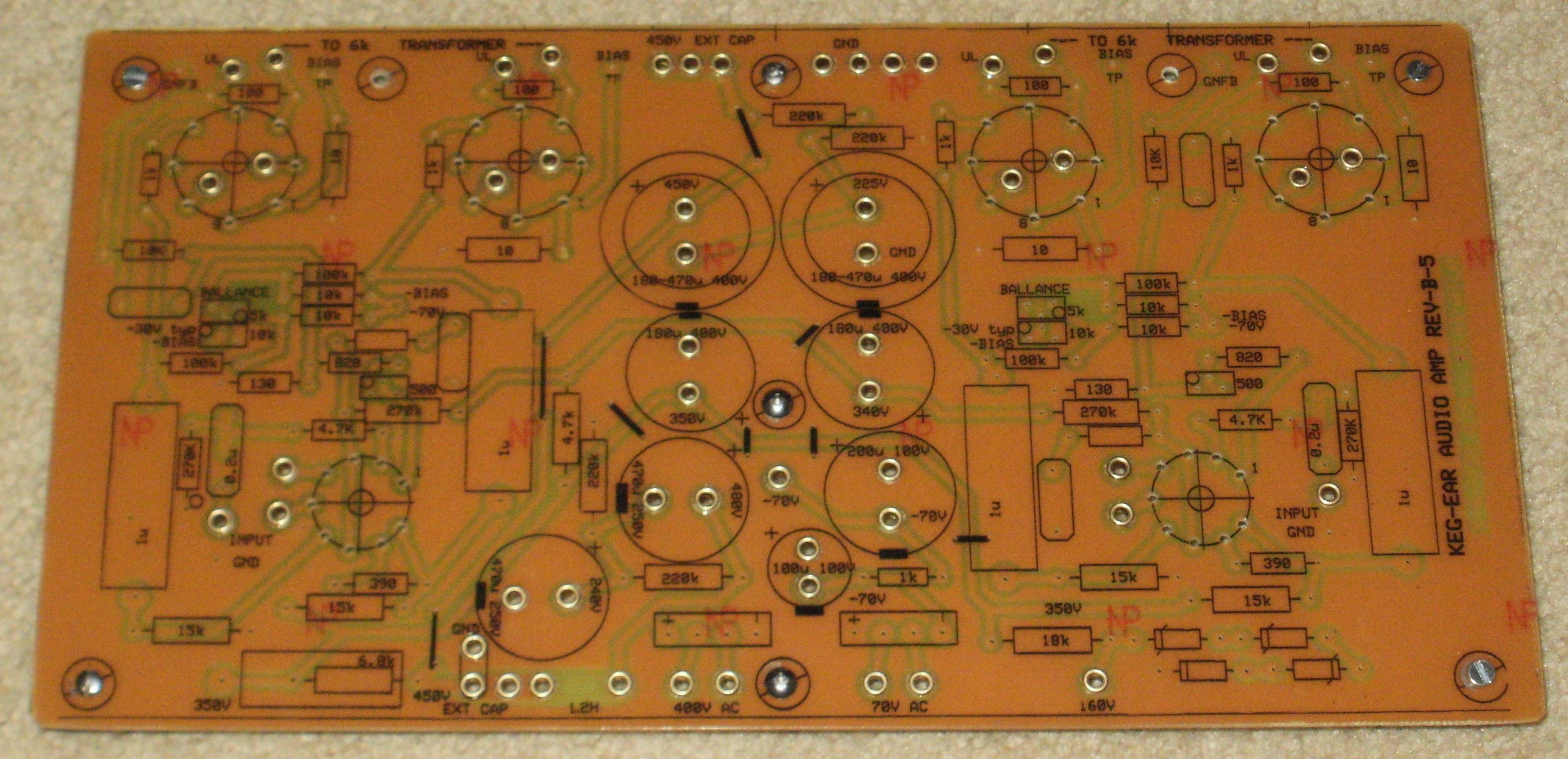

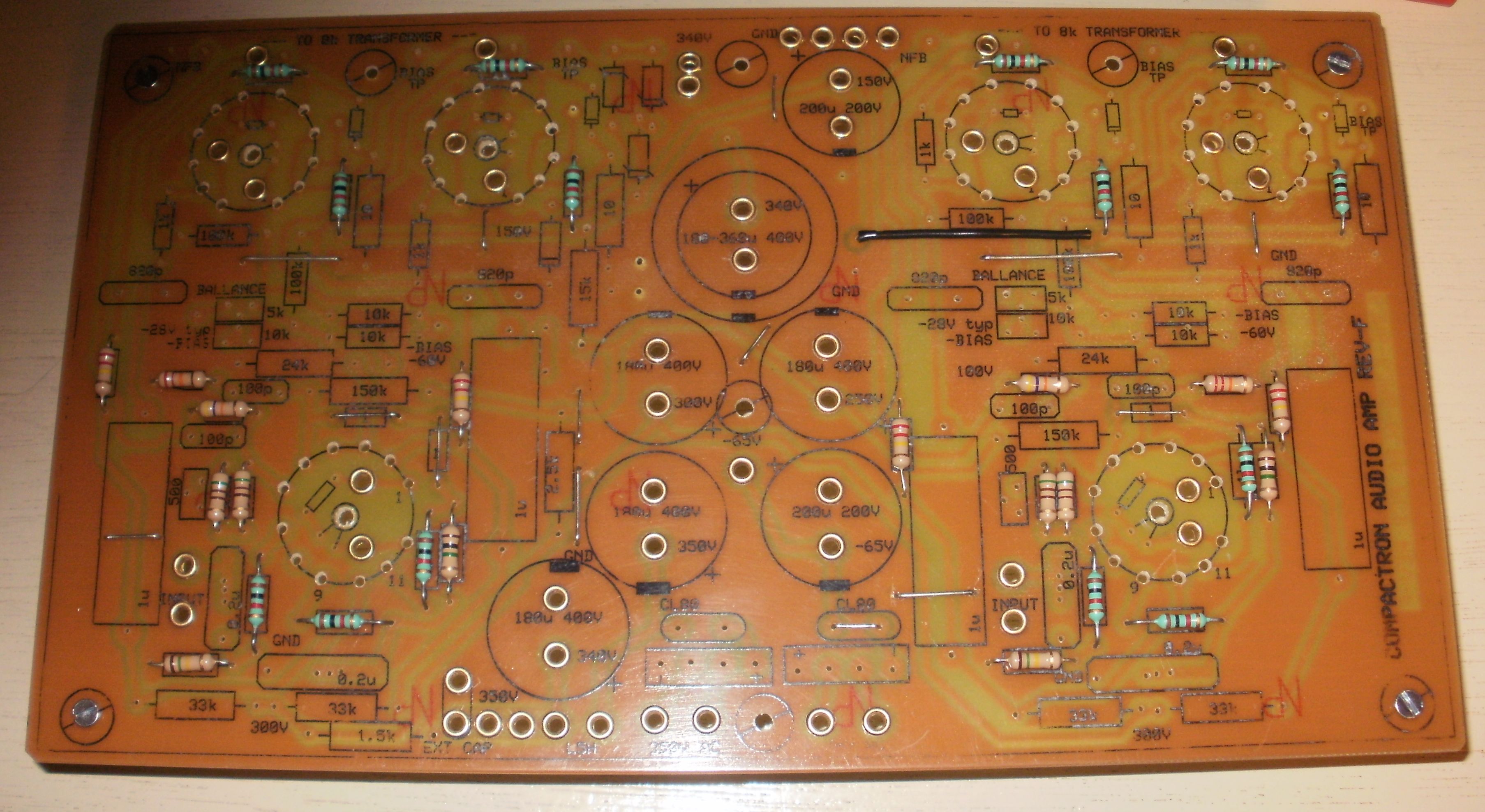

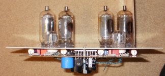

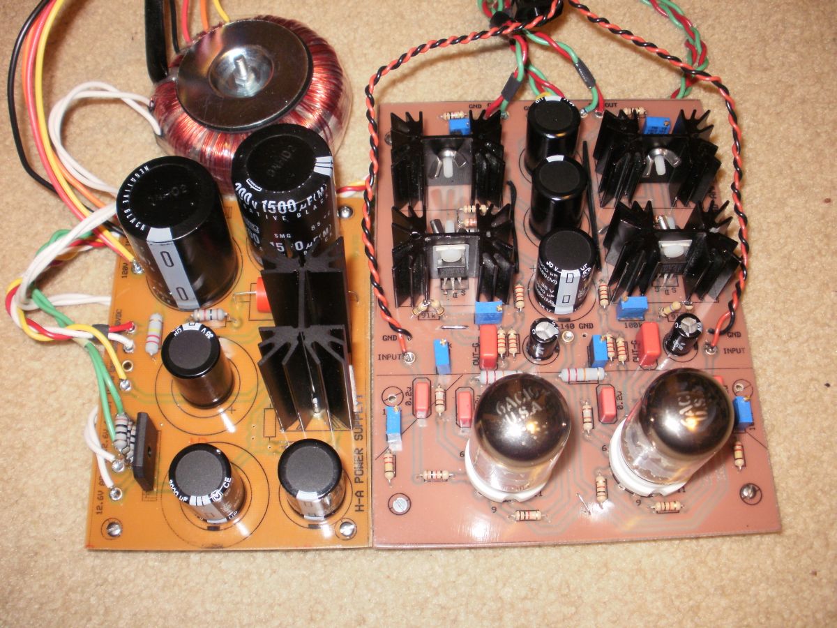

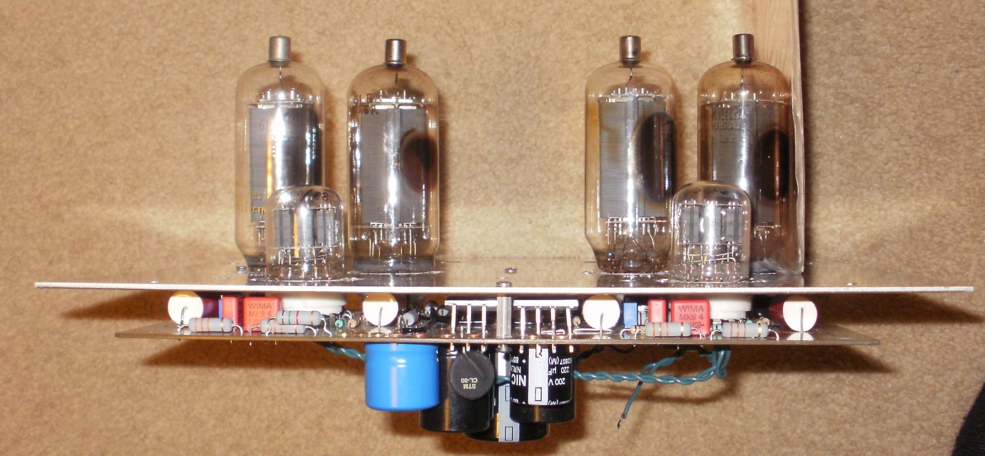

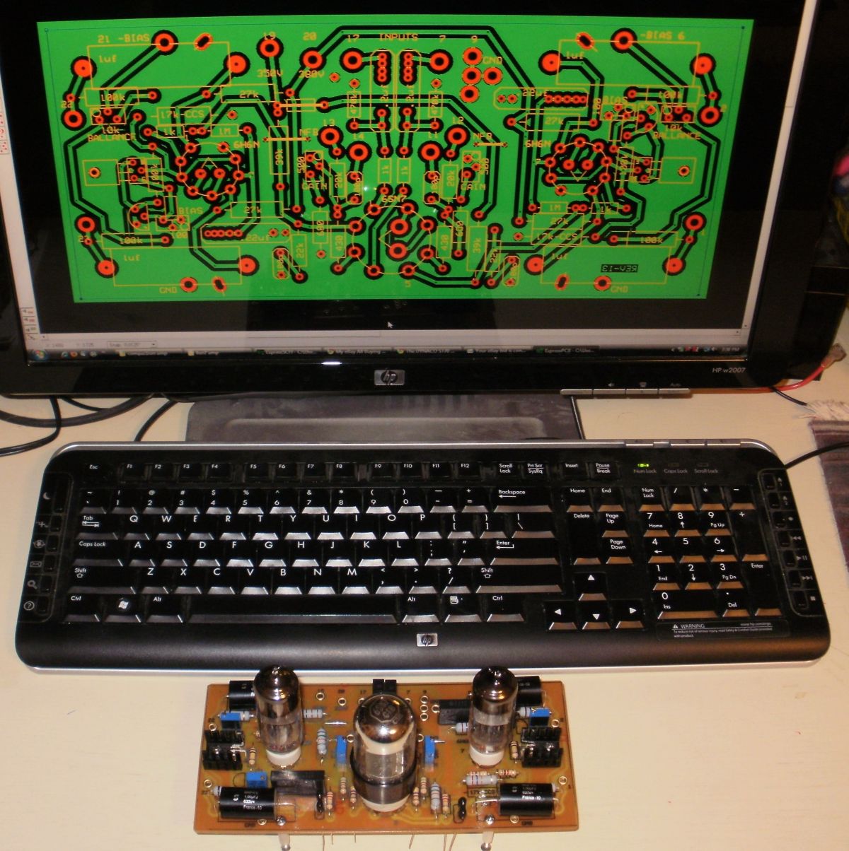

Examples of Toner Transfer PCB
Examples of the toner transfer method for single sided PCB's. I use eyelets where I wish to mount to the back side and solder to the front. Example would be large caps in the back side to allow the PCB's to be mounted where the tube sockets will poke through a top plate.
PCB's for a 6550 based amp, Compactron based amp, ST 70 pcb with 6SN7 and EC99, a couple different headphone amps etc....
