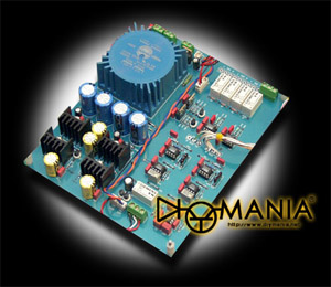

toner transfer PCB
Still at it with the next project, RIAA preamp. Toner transfer method as my previous post. The last pic is after soaking the pcb in cold water to allow the paper to disolve and lift from the melted toner on the copper. All that is left on the top of the toner is a layer of the clay from the paper. If there are any small voids, I use a paint brush with modeling enamel and do a little touch up. The top of the PCB is black toner with the white clay layer removed. If you scrub too hard, you can remove the toner as well.
Also working on a hybrid tube Mosfet headphone amp with boxandall tone section and a couple of power supply pcbs.
I use green stiff floral foam to mock up the pcb to verify component count and lead spacings. When the PCB is etched and drilled, I just transfer the parts to the PCB.
