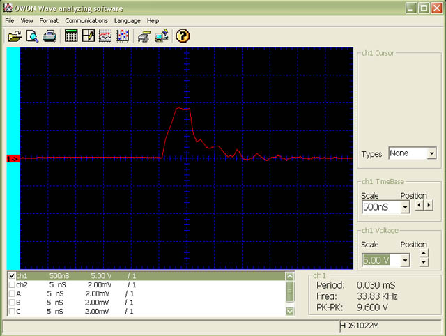

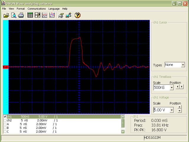

Here is what i see at the output of SG3525....
notice that one output is different then another.....
I have no clue on why its like this....it should be equal...right?...

Perry,
I have increased the dead-time.....and replaced 100-ohm resistance with 220-ohm
results are much better then before !!
heat is much less then before...
any more suggestions based on the scope output ?
The schematic seems to be OK. You simply need a good buffer.
