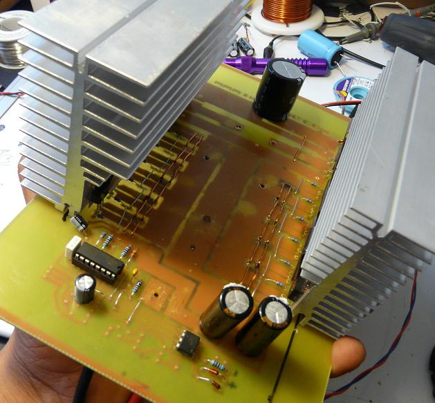

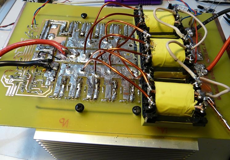

here is what i am doing.....its on a proper pcb...with perfect heatsinks...
at the moment, i am using 3 transformers....from another smps....and using the output of them in series which produces 70v....and then regulating them on 44v....
this setup is working just fine....without a 0.1v drop....
as you said, i am using 12 irfz44s....
at the moment, i am using the primary of all 3 transformers in parallel...but, i am gona divide 12 mosfets in a group of 4 for each transformer and use the output in series from all 3.
I have tested this setup on 650-watt of load and the mosfets are just a little warm....
except on that load, i hear a high-frequency sound....
i am using 30khz of pwm from sg3525..
i have actually used the same pcb design and modified it in photoshop to add more mosfets in the same line....
what do you think?
what do you think?
I didn't realize that you made a board for it.
The noise could be from instability in the regulator. A capacitor across the output of the opto-coupler may help. You could also try capacitive feedback (0.01uf? - experiment) from the inverting input to the comp pin. Too much capacitance will slow the reaction time of the regulator (may not be a problem for your application). Too little capacitance would not stabilize the reg.
