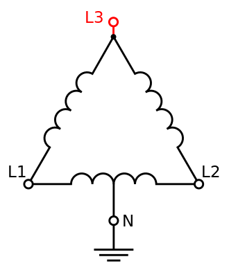

What is confusing is that the neutral (blue) is really a phase and that ground (green/yellow) is both neutral and ground. You can connect as 127V between blue or brown and green/yellow.
I said days ago the colors are odd compared to current EU custom; however colors have been changed before and are not always followed in the field. Never Trust Wire Colors!!
The green is NOT a Neutral! It is only Protective Earth.
Where is it written that a power company must give you a Neutral? I agree that no-neutral is very unusual, but I see no need to demand it.
Taking the 127V from phase to PE would be as illegal as me getting 120V phase to Green. Yes, the lamp would light. No, you are not supposed to put load current on a PE. A further fault in the PE network would make ALL his appliance cases LIVE. Do not do that.

The neutral is the mid connection of the Y. (XYZ of each transformer coil). Here it is connected to ground. If one of your clever neighbours plugs in a 110V device, using the ground as neutral.
Can't speak for the rest of the EU but this form of power supply s not allowed in the Netherlands.
in a delta system, XY, YZ, and ZX are single phases that can be used individually, no neutral, protective earth can be used here....
in a wye system, single phases are XN, YN and ZN, the neutral is common to all three phase arms......
the two systems are distinct with each other...
