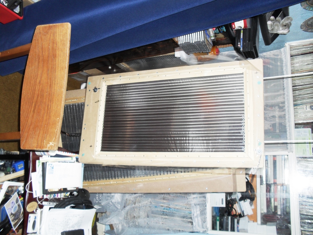

Thank you Wrinex for the extra tape information, I have just bought 10 3mm x 50 mtrs tape rolls will save me cutting tape in half with scissors. I have sent a picture of my latest creation using rubber magnet strips, for your perusal. As you see in the picture I use penny washers to trap the foil never had to solder any aluminium tape ever!. The distance between the diaphragm and the magnetic strips is approximately 3mm although this depends on the front MDF sheet thickness, so you can vary it if you so desire. I never use a heat gun. I always use a wood surround and screws and finger power!. This design is about 12 db down on my 4' x 2' design using ferrites and tape in the same design layout of the diaphragm. Hope this is useful to you all!!
