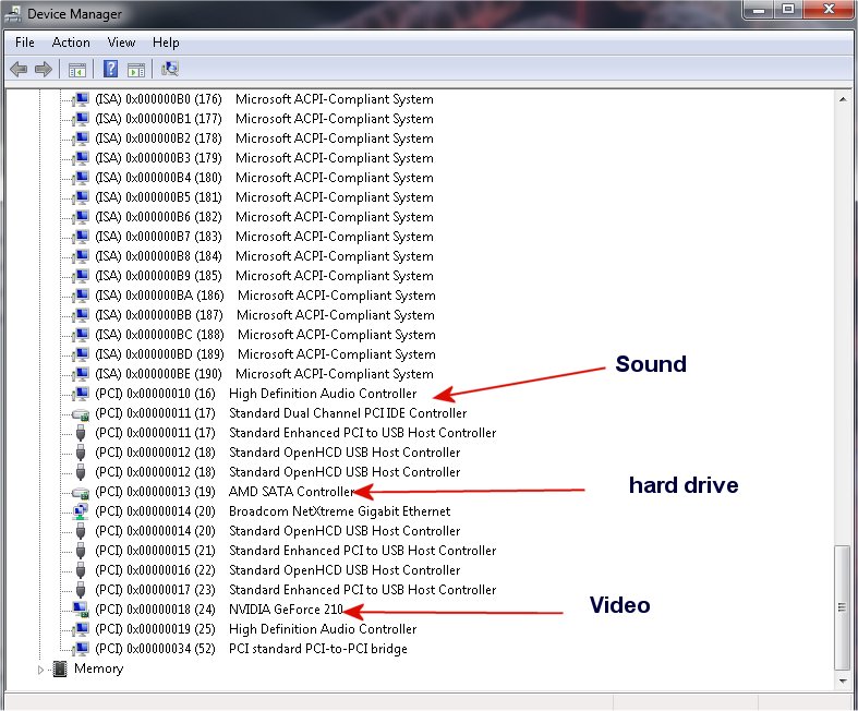

Sounds like a conflict (IRQ).
Sound cards , Video , and ethernet should have separate IRQ's
or just share with a USB host controller.
Change slots.
Look (below) , only my ethernet is sharing with a USB.
Sound and Video have a single dedicated # IRQ.
Computer > properties >device manager > view > resource by connection >
IRQ.

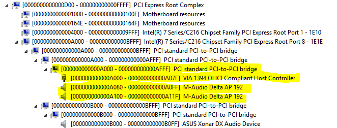

It looks like that PCI slot was sharing with the Firewire controller on my board, I disabled the firewire port, and I'll cross my fingers that brings me back to only having to disable and re-enable my audio once in a while

Also, since disabling the 1394 controller, I've had not a single instance of the audio drivers becoming corrupted. My only remaining issue is the sleep/power problem, which I can live with tbh, but would like to fix for power bill reasons

Z77 chipset has no native PCI support. They use a bridge
to the PCI-E bus. new motherboards:no pci native support and possible problems | Hardware Heaven Forums
My "new" MB is a older AMD with 3 PCI/4 PCI-E .AMD south bridge has
a dedicated PCI controller. Newer Intel's are best ALL PCI-E. They
want you to get rid of all that "legacy" hardware.
There might be NO fix for this issue.
The M-audio might just be incompatible with the bridge - it might need a real
native controller.
