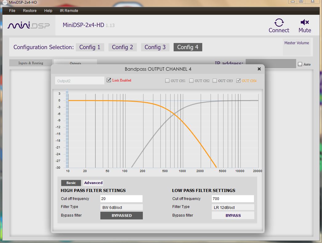

I do know Pluto have xo at 800 Hz...
And this about xo 700 Hz:
"The spectrum between 50 Hz and 10 kHz is evenly divided on an octave basis by a 700 Hz crossover. Having 5 dB to 10 dB less peak signal capability for the upper frequency range is of some concern to me. Putting 10 dB of gain between DSP and power amplifier would make full use of the amplifier's capability and raise the noise floor, which is of little concern. But after many hours of listening to the LXmini I have only run into the expected woofer driver excursion limitation. So I am happy. The drivers are the limiting elements and not the electronics."

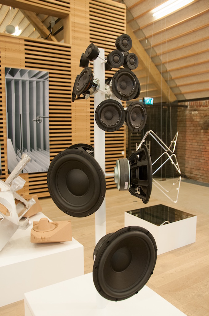

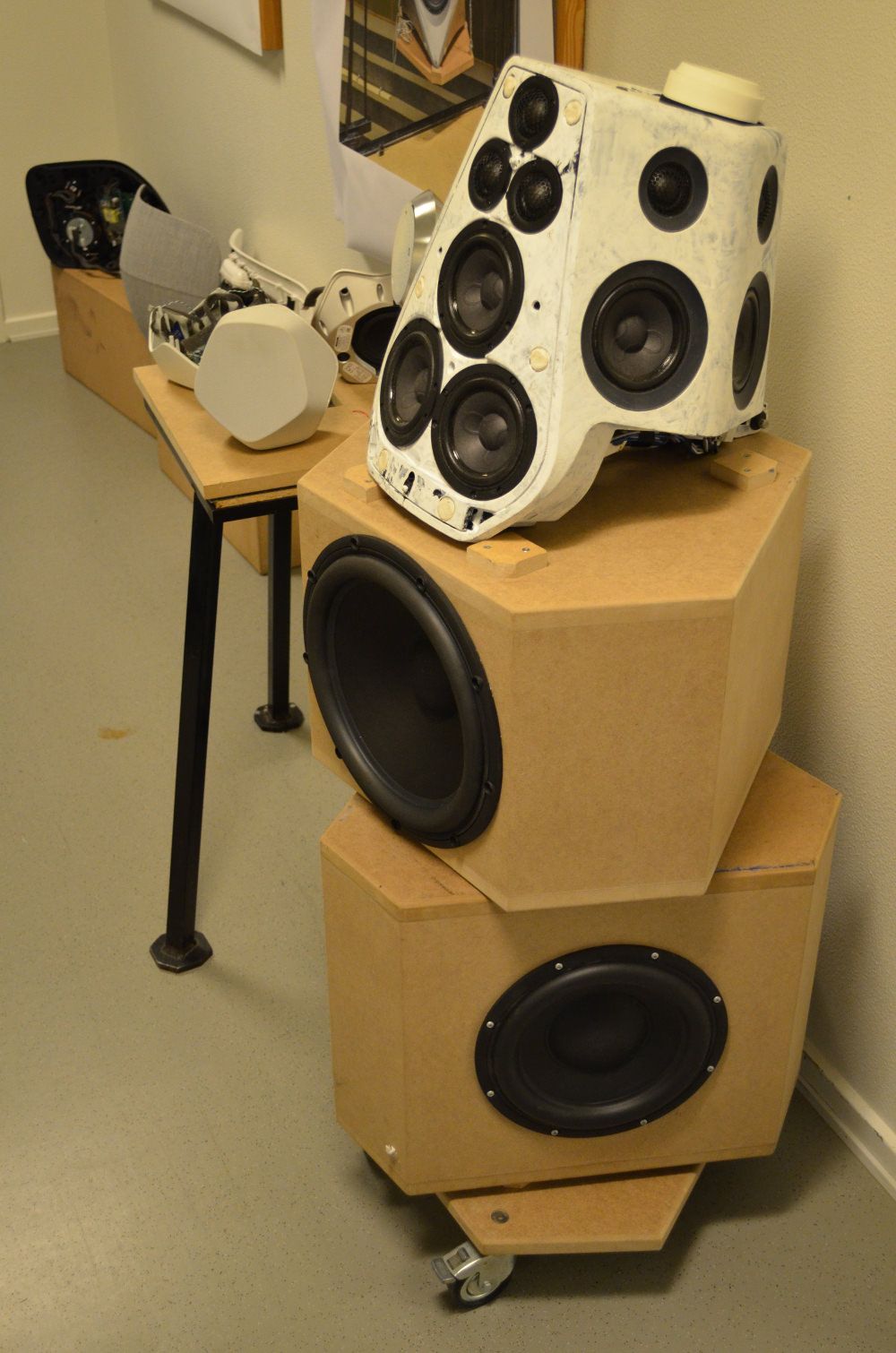

The multi-driver objective here is omni/cardioid/dipole.
And no, both versions of the Pluto were designed with a 60Hz cutoff at second-order.
Dave.
I don't know much about Pluto design ,but I have original LX mini filter settings...it did boasted 50 hz...
Dear,Dave would you expend a bit more on subject ...omni/cardioid/dipole....
honestly it is interesting subject to discuss it.
B&O did used multiple drivers to have dipole/ loudspeaker
