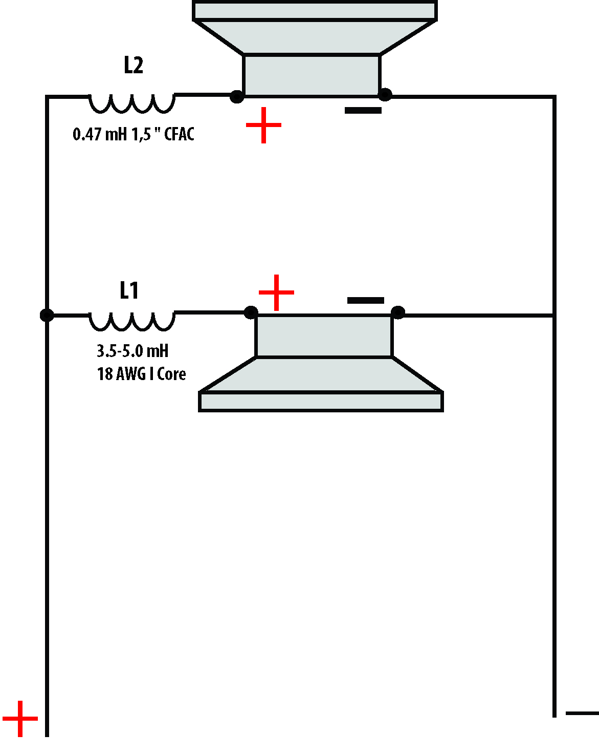

-Run them with same polarity. If not, you'll get an unloading below Fs.
-I would also try a 2.5-way if you use 2 woofers. This will negate the distance between the woofers, and the lower woofer will not have to struggle to meet the widebander due to the distance they are separated. It just takes a largish I-core coil in series with the lower driver, and the L/driver series combo then in parallel to the other woofer, to facilitate the X.5 implementation.
Later,
Wolf
Thanks Wolf,
Haven't thought about driver unloading below Fs. Thank you.
Crossover ...do you mean same thing like this ?
