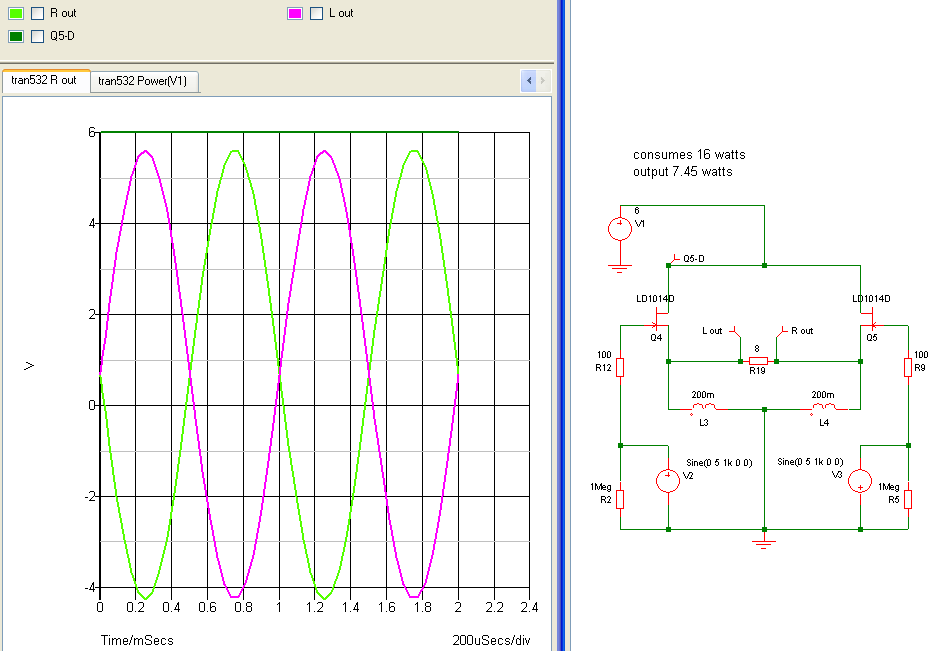

LU1014 differential amplifier

This design is Constant Current Source IN/OUT, like F1?
Hi Carpenter!
he way this amp is laid out, the LU1014 runs more voltage than current compared against the triode curve on the LU1014 VDS graph: the sim states 5.4 volt diff with 1.6 amps--the graph curves asks for 8 or 9 amps at this voltage diff.
Could you show me that "triode curve on the LU1014 VDS graph" ?
Which VDS graph curves asks for 8 or 9 amps at this voltage diff?

Hi Tyimo. You can find all that information on Nelson's tutorial regarding the ZV9 (I think... maybe ZV8) He has a graphic like that in your post and describes where the sweet spot is located on the graph.
Woody: I don't have the formula, and most of the time, I use Simetrix to determine how much choke I require for a particular project. If you use a 100mH choke, you'll have ample support at 200hz. To be quiet honest, you could probably get away with 50mH. I believe Magura uses 80mH hand wound air core chokes for full range performance -- probably keeps the phone number for a tow-truck in case he ever wants to move the amp to which it's attached. ;)
