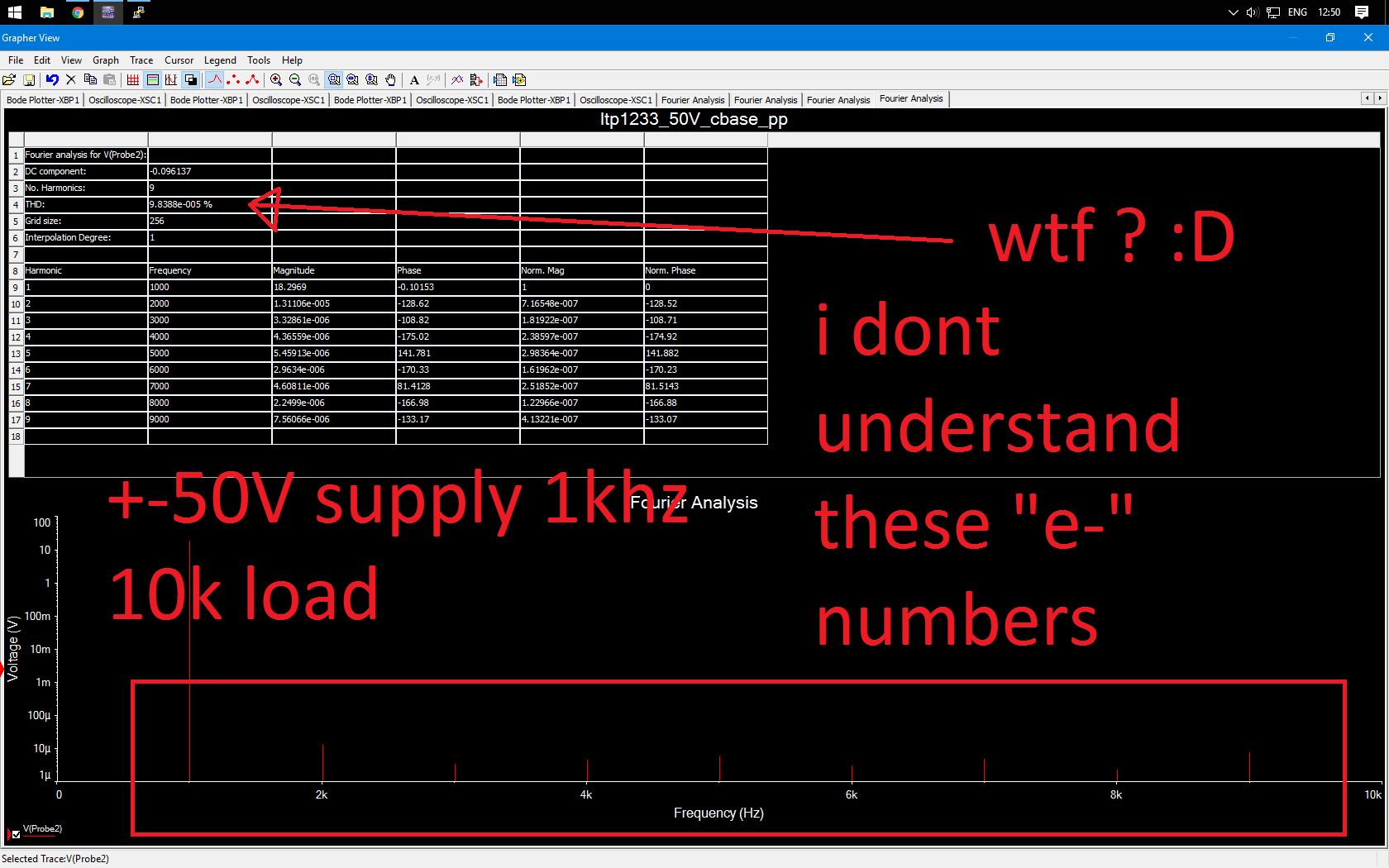

Im attaching a circuit like the last one but without the CMs. It seems that it gives the almost same THD, so you are saving 4 transistors this way.
R6 is better to be 1k in this one.
Can't wait to test it real life and maybe I'll test it now. I have a working LTP+CM front-end on a prototype PCB that I can modify to this.
The problem is I don't have 1Mohm resistor and I need to go with 2x 470k :D
