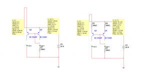

LTP works better with more current in the right collector

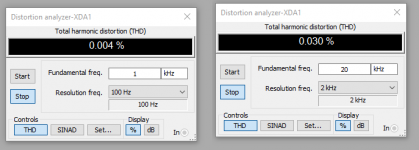

See 0.004 and 0.03 and this is with 100pF compensation.
With 30p the distortion is 0.003 and 0.014 : veeeery good for a clean ltp circuit.
Its because the feedback needs more current.
I think 100p compensation is needed only with current mirror.
I think this way its better than current mirror loading.
With a current mirror I get 0.009% @ 20khz with this output stage but Its not worth the risk. 0.030 is plenty enough.
I forgot to mention: the load is 6 ohms and the Vrms is 3V with supply +-12V
Just tried: the distortion is 0.030 @ 6V rms , 20khz and 30p compensation cap.

Conventional wisdom actually says the leg with the VAS on it needs more current, but I suspect there may be some distortion cancellation going on. That or external impedance levels.
R2 may benefit from some bootstrapping action here or going CCS altogether.
Why do you have both a bootstrapped collector load and a CCS in parallel? What's the reasoning behind that?

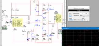

Look what I made today, Its very stable at square wave without compensation caps.
I think this topology hates these caps because in one of my tries it oscillated with C10 and C11 :D
I removed them and everything went fine.
This topology is my favourite because u dont need an emitter follower to amplify the current of the feedback when u have power resistors and infinite current from the output stage..
The THD is the same with all comp caps connected. Also notice that there is 6 ohm load attached.
0.008% @ 20khz with 6 ohms and maybe this is limited from the feedback impedance.
capacitors doesn't play role here because i use high current.
Look how I kill Q7 and Q14's capacitors.

try to change the R2 to 15k.
Sajti
Worse
edit: I saw that the results in my 1st post were with lower Vrms, with 100p comp and without C6
Resimulated and it gives me 0.030% which is worse again when compared to mine in the 1st post.
