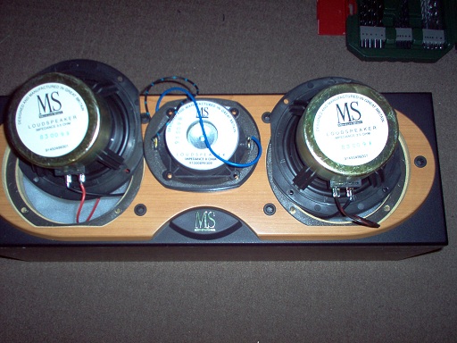

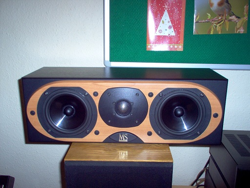

I've been whizzing along with my bargain 3.5 ohm Mordaunt-Short polycone bass drivers. Even found a promising crossover which I think I can adapt. Thing is they were used in the Epos ELS-3 AFAIK.

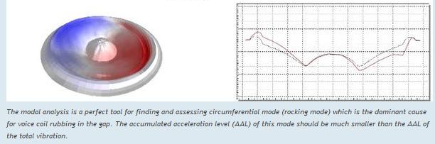

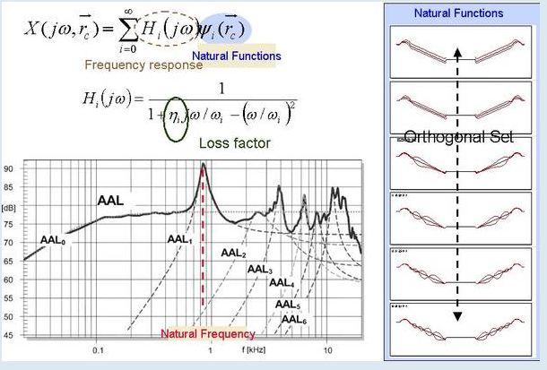

If I was looking for the explanation, I would say that 1.4kHz here is where the paper speaker ceases to be a cone and slips into radial and rocking modes. Material damping and rigidity then becomes a critical factor too. This link is quite deep but is a precise analysis:
Vibration analysis

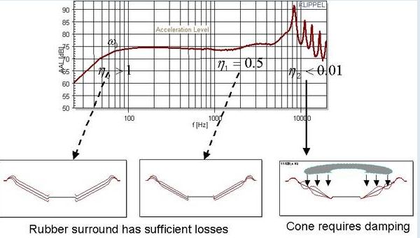

Bextrene coned drivers even with applied damping nearly always
exhibited the sort of peak S7 is talking about due to lack of
inherent damping of the material.
Polypropylene (and paper composite) has more damping but
there still can be issue depending on the cone to surround
termination, which makes or breaks a good bass/mid IMO.
Trouble is optimum mid termination is no good for bass.

Optimum cone termination is quite stiff, first done in the Mordaunt
Short Signifier years ago, and currently done by B&W's FST, see
Zaph|Audio and control F FST.
Suspension Xmax is low and Fs high, ruling out bass use.
