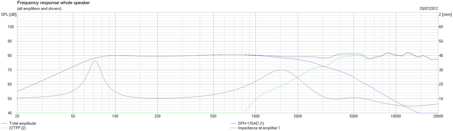

Had a fiddle with the inductor resistance values in boxsim which seems to have sorted the problems i was seeing. (don't know the actual resistance values so i've put in values that seemed to iron out the response) All the other component values are original.
I've added the -3.5dB L-pad to the tweeter. (I've now summed the adjustable tweeter attenuation so it takes up less space)
I've attached the response plot i get with the crossover design above.

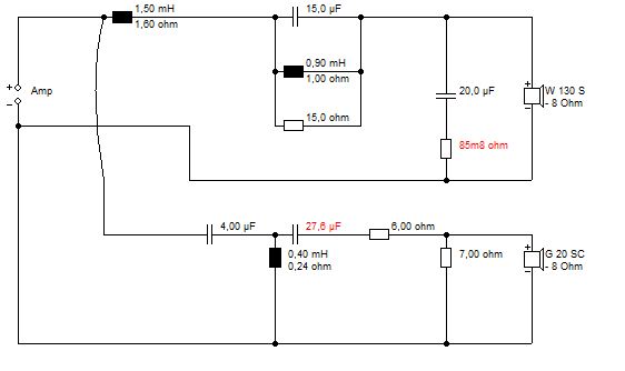

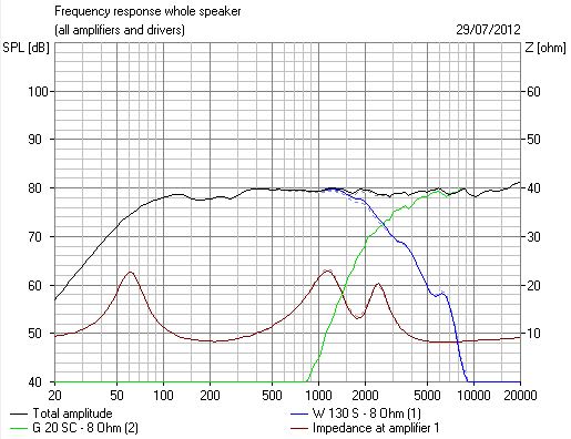

Kei, your sim isn't right at all. The two 6.8uF caps in the bass trap are shorted out as it stands. 😉
What you've got there is a bass trap (1.059kHz RLC: 15.8uF, 1.43mH, 16.5 ohm) on a second order with about 2.53mH total bafflestep. Notice the 9uF rolloff capacitor has 2.2 ohm resistor to avoid peakiness.
Alan Yates' Laboratory - VK2ZAY's Engineering Calculators - LCR Resonance

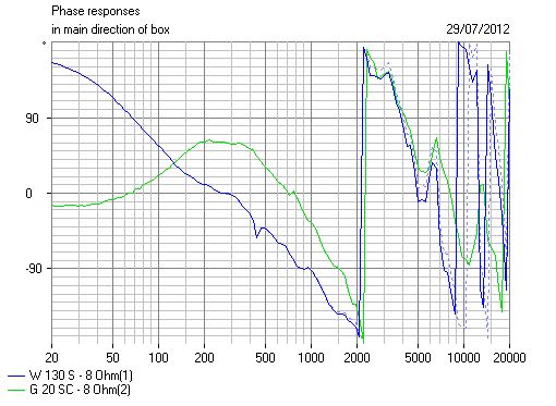

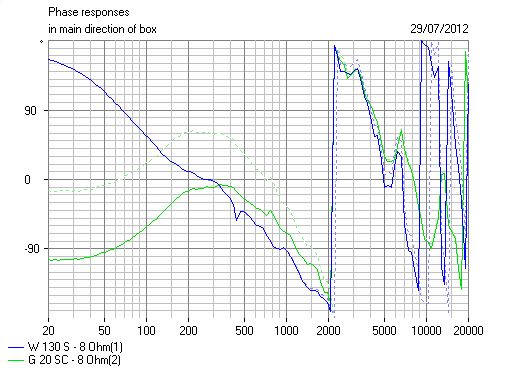

The tweeter is third order with a pad and a 2.2uF/8.2 ohm Zobel impedance correction. In fact a modern ferrofluid tweeter really shouldn't need the Zobel in the presence of a shunt resistance of low value around 8 ohms. FWIW, I found second order tweeter actually worked best on phase here. I simmed a nearfield (standmounter) response on a paper bass/dome tweeter, and the last phase response is second order filter where you just lose the second 27uF tweeter capacitor. I'd say that is using all the BBC techniques on the filter.
All that remains is the light damped plywood box with screws holding the front baffle and light battening and you've got a BBC derived Spendor or Harbeth! OK, I didn't use polypropylene bass, but the W130S IS lowish inductance at 0.6mH. 😎

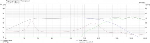

I've re-done the sim with just a single L, C & R value based on your info, steve and it doesn't work quite as well, but i know that the values in the crossover are not right anyhow as stirling have adjusted their crossover to suit the monacor SPH-135AD woofer that i'm modelling with. What we do know is that the woofer section is correct for the woofer that i'd be using, i'm just modelling the lot to get an approximate idea of how the tweeter will integrate with the rest of the system. The crossover integrates + & - 1dB adjustments with 0.5dB steps to make fine changes. Problem is, I'd have to build it and listen to it in order to get a good idea as to whether it really works or not.

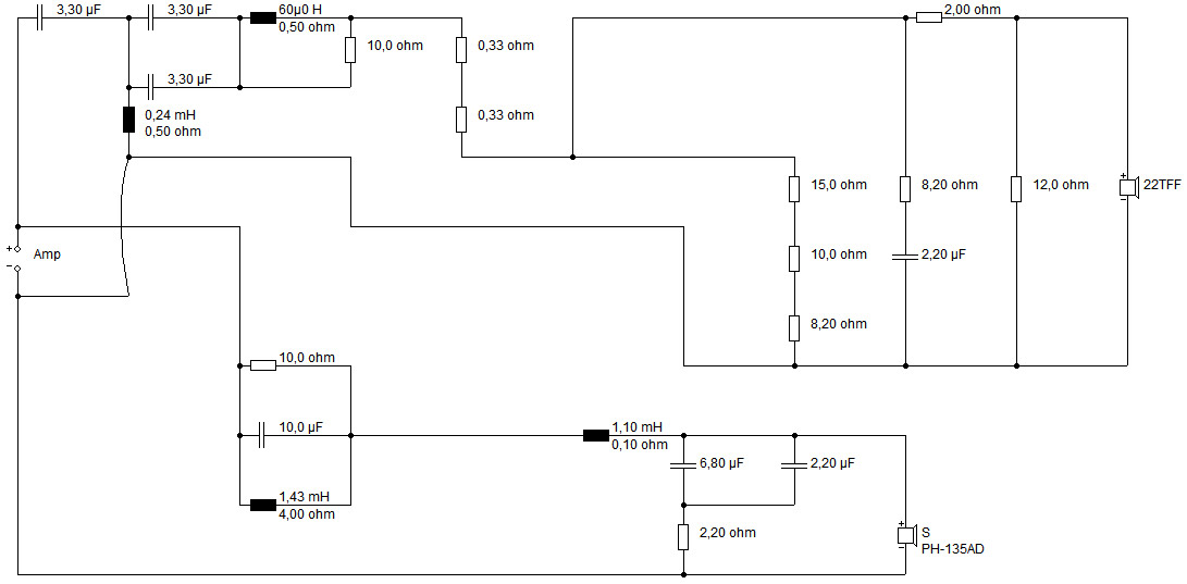

Changing the values to this seems to flatten out the response again. I've attached a schematic of the changes. Increasing the 9uF rolloff capacitor to 12uF drops the small peak at 2.5-3k back inline, but i've left it as is.

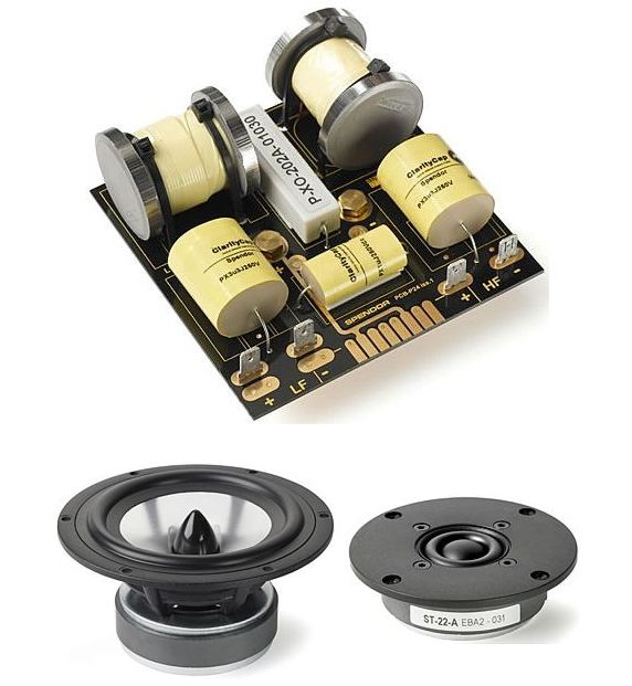

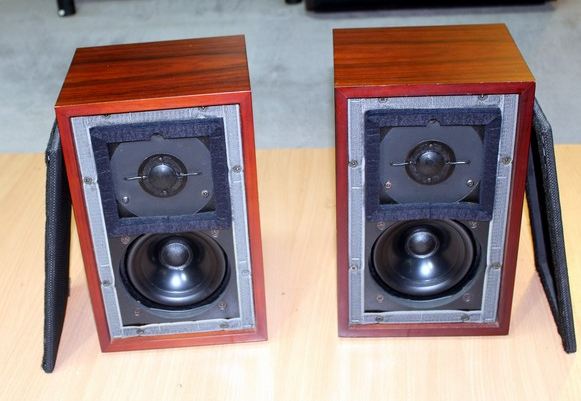

I'll suspend my disbelief that this can be done at all while sharing some investigations of a modern equivalent of the LS3/5A. Problem as I see it is you need accurate modelling files of the Monacor SPH-135/AD and SEAS 22TFF to get an accurate result.
The Spendor SA1 is a good place to start. This is light years ahead of the LS3/5a in driver technology with a crossover at 4.8kHz and a polypropylene rather than bextrene driver. But has the same sealed plywood cabinet style, and by luck uses your SEAS 22TFF tweeter. By the look of it, it doesn't need the bass trap and looks like simple 2nd/3rd order filter. FWIW, the bass driver looks like a SEAS special not dissimilar to the U16RCY/P . If you want to read how GOOD this little SA1 is, here you go:
6moons.com audio reviews: System Review 2
I enclose a picture of the original LS3/5A, a Spendor SA1 and its drivers and very lightweight cabinet construction. Bear in mind the LS3/5A had all the adjustments because it was built to a tight BBC studio spec. Hardly necessary these days. The cabinet is interesting too. I think it becomes almost aperiodic at low frequency with its ability to flex in a damped way.
