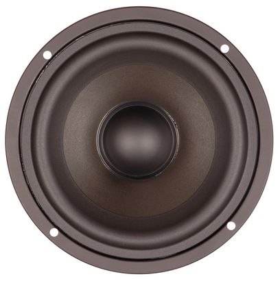

Here, Troels Gravesen uses a metal 5" bass, of all things, with a Hiquphon tweeter:
W15CY001-OWI
Lots of notch filtering to keep the bass civilised. But nevertheless a 8L reflex cabinet and if I'm not mistaken, a near LR4 24db/octave filter rather than 18db/octave BW3. Even so, is that sort of little cabinet going to fill the room? I don't think so.

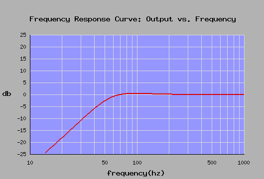

I went to Lalena and looked up the closed box cabinet size for a driver with the specs of the Kef B110: Vas 23.6l and Qt of 0.31. For a system Q (Qtc) of .707 it gives a box volume of 5.62 litres. (5 litres gives a Qtc of .74)
Could someone show me how I am ending up in the wrong place with the impression that 5 litres or thereabouts is ok for a B110.
