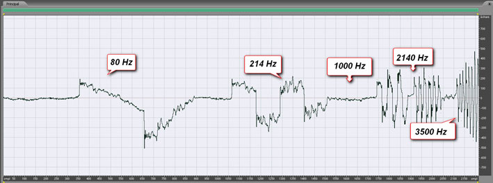

Radugazon,
You've mentioned those test tracks to me earlier. I've downloaded them already, and am now finding a way to put them on to the player... (I'm old fashion my PC is not connected to the audio system .... )
And as mentioned, except for cymbals, (or triangle... ) etc., all other 'normal' instruments are all fine (or excellent) in imaging. Their fundamentals (tend to be ITD) indeed do the job brilliantly.
Those 'pure HF' instruments I brought up have relatively very less proportion of lower frequency fundamental. They give mostly the leading edge of attack. ( No? ) Hmmm.... so that leads to ....

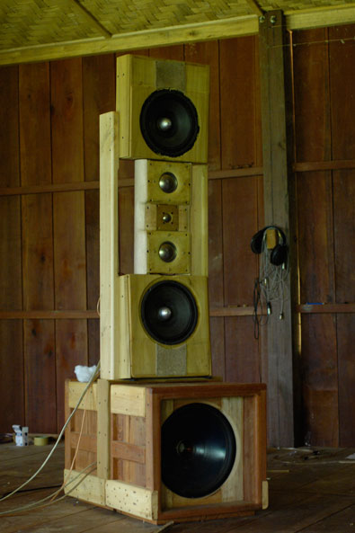

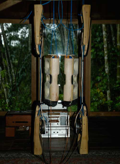

A Compromise
I tried relocating the midtweeters to the (inner) sides of big mid horns. See attached picture. (the boxed mini monitors beside TV are not in the main system, they are for TV only)
And the supertweeters are now 2 units (in stereo connection), spaced by 35cm or so, firing almost vertically up with a little angle toward the front. Large proportion of indirect sound in this range is indeed very good. I like it a lot and can't go back. (Thank you, Elias.)
I spent some time trying the toe-in angles and found a compromise among image focucing/positioning, spaciousness, listening area, overall in room response... etc. Now it's kind of an all-rounder, or I should say a compromise.
You may see in the pic that the midtweeters are toed in a lot. I suppose the objects nearby might probably cause some problems. I'll try some absorbing materials later. Or bringing the midtweeter higher. Or both...
It's alright for now. To be continued for sure....

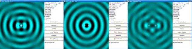

This has the potentiality of creating a huge spaciousness, but at the price of a serious imaging. As I am a pragmatic guy, I use some diffusers to correct this (see the picture...).
OMG, they are not quadratic...It's randomly sized bamboos. Following the diameter, I suppose they must work over 6000 Hz and reflect a part of the spectrum on 180°.
They finally narrow the image too a realistic size on a little formation, but keep it wide on a big forte. In any case it preserves the repartition of the sources. But you know, all this is subjective stuff.
Then, their orientation on the floor horizontal plane has little effect, but the vertical orientation is the key:
oblique inside, it widens, oblique outside it narrows...
An other way of controlling the "center channel" is precisely to toe out the HF group....

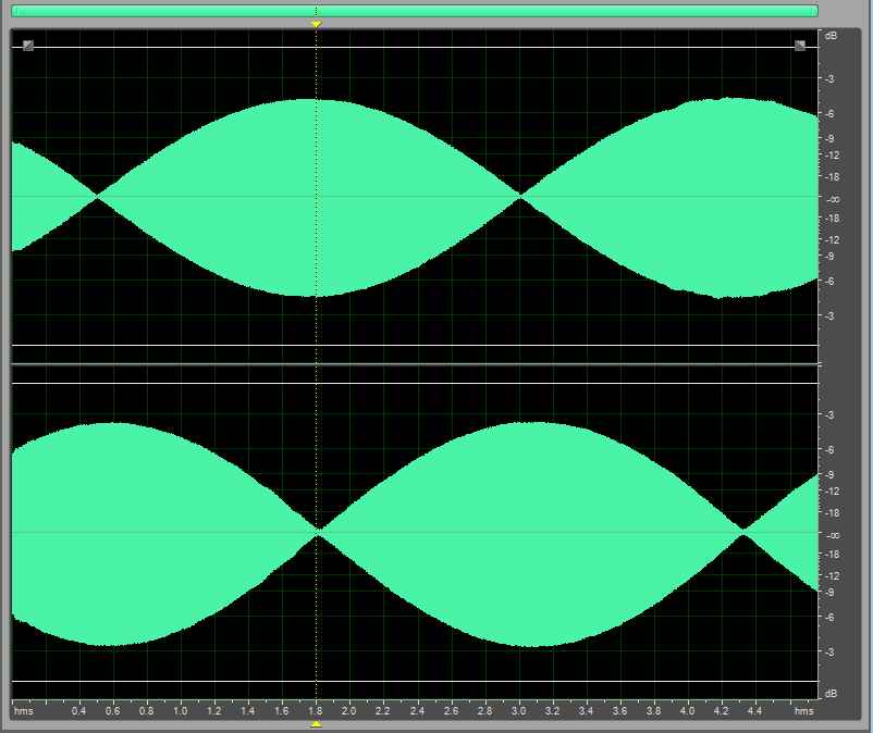

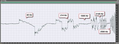

Here the subjective approach has a good helper : the phase analysis, I mean the stereo phase between each channel, not the phase between the drivers of an isolated speaker.
On the joined pic, a binaural record of a 1000 Hz signal with 180° rotation of the field taken from the listening spot (5 meters).
Normally, when it's like this, the system images rather more accurately than ultra wide. Work are still in progress, I try to conciliate both aesthetics. Many factors have some importance, as the foam phase plugs that change a lot of things (thx Mr Geddes).
Last word: on a rotating phase test, a classical basic system produces a Right/Left alternance, but in a system like this one, or like the stereolith, it's easy to perceive (or imagine...image/imagination) a rotating source around the system.

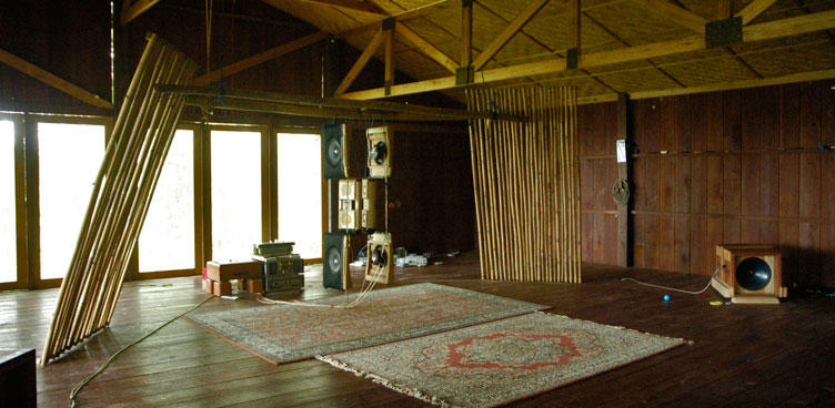

Hi Scott,
I've breifly tried toe-out, or even side firing. Unfortunately that didn't work properly in my place. Ah~ in fact I don't know what 'proper' is. Anyway toe-out or side-firing was not good to my ears (and mind)...
In the pic of post #43 you may see a drape on the left corner. There's a big pillar behind that. While the space on the right is open. So if the refections form both sides are stronger than a point (in proportion), the images would be pulled to the left too much. OTOH, large toe-in setup sidesteps that problem ( -- side reflections are largely delayed, attenuated, and appearing on the opposite sides... )
I thought of diffusers, too. But it's not easy to get a good balance among all dilemmas in my case. There's always practical reason, sigh~
In the experiment of up-firing tweeters, I got a feeling that omni might be the way to go (-- or very close to omni, like Radugazon's LQ...). Now I'm working on it.
Recently, I’ve put the system in a classic configuration (takes 2 hours only) that produces almost square waves and that’s average in off axis dispersion. This has some qualities, but it’s not playing music, just HiFi. Before I was biased on it, but now, it’s really kicked out.

This is an old picture, still with temporary boards on the sides, but basically it's the same architecture. This one has the domes facing the listener. No LQ here, it's all dipoles (but you know that dipole in the highs is an other story...)

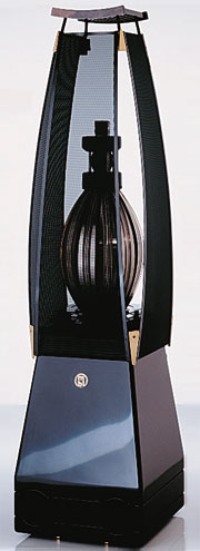

btw.
http://www.stereotimes.com/images/mbl101d_black_180x495.jpg
I always doubted, that especially the MBL 101 'big midrange' unit radiates
a coherent spherical pattern. But i might never have the chance to analyse
the vibrational behaviour of that unit, so just guessing.
What i want to say is, that you may have 'modeled' more and even important
aspects of that trancducer, which seems to have inspired you, than you might
have noticed. And even if my assumptions on MBL 101 should be incorrect,
you have introduced an interesting property, which has value in itself regarding
speaker/room interaction.
OK, i noticed you and some others being involved in OSD and
also analysing the "stereolith".
My comment is not on that, but on your LQ midrange
configuration posted in "Sound of the Jungle" ...
By using that midrange LQ you managed to get a sound source
which radiates a virtually spherical pattern.
But there is only one frequency - given perfect drivers - where
the spherical pattern is perfect and the wave front emanating is
coherent, right ?
That 'adjustment frequency' or 'mid frequency' is the one, where
the distance is right. For wideband opereration, the distance has
to be tuned to a 'mid frequency' as a compromise, as i understood
your description.
For differing frequencies, there will be an interference pattern, which
may maintain the gross spherical dispersion to some extent, but the
coherence is lost and the phase you get at a single point in space is
somewhat 'random'.
That behaviour from the midrange LQ in itself
- diffusivity and wideband spherical radiation pattern - may contribute
to mitigate early (room) reflections correlated to the direct sound.
The system sounds more 'airy', there is an increase in 'depth',
the speakers are less localizeable as sound sources themselves.
You feel that tonality is not changing much when moving around
in the room, even when outside the stereo listening zone ?
Spaceousness remains, even when localization of phantom sources
may get fuzzy for listenening places in the periphery ?
The recording venue - as a tendency - seems to dominate the
listening room, which (better than with classical conf.) may disappear ?
I guess your midrange LQ as a "diffuse like omni" makes a large contribution
in making that kind of 'music'.
It is not only from the overall OSD configuration, i am convinced.
But please, go on ... you're doing admirable things ...
btw.
Explaining things to somebody that understand better than me is challenging . .Consider then it's some real life opinions.
I've tried a lot of LQ variations, bare drivers, bigger baffles, great an small
inter-driver space, cones inside, cones outside, radial, horizontal (actual
config) and even oblique. I put them in concurrence too with the dipole wiring.
the LQ has at least two big negative points :
Then, when comparing it to the theoric model, the famous recessive inverted lobe only exists in the inter driver space with good impulse and no high pass.
The outside lobes dominate.
other unknown points :
the only sure fact is that the sound is pretty dead when the drivers are very close.
now the positive:
as you see it's almost a complete confirmation of your deductions, except for the first paragraph.
Comparing radial LQ vs Horizontal allows a better understanding of each formula
this proves that finally this setup is not perfectly omni if it's bandwidth is too wide.
BTW, with the diffusers, the image gets more narrowed but can extend much more with the horizontal LQ.
Depth is the same,looks like the imaging is accurate for me (difficult subject).
But the horizontal LQ renders better a 360° rotating signal.
both of them can be listened laterally,some one can turn the head or even plug one hear, the general localization remains and it's hard to localize a speaker.
but the priveligiated seat is really on axis and at 5 meters.
Is this system faithful with the recording venues? I have some very contrasted records, so it makes the difference, but the room has it's personality superposed. Difficult to investigate a bias.
This makes everything bigger only IF there is enough SPL. I listen mostly at a level that would be forbidden if any neighbors. Listening at low levels makes it cheap and slim. Bias again.
This is for the mids, but they are not alone. I think that an innocent listener would notice more the bass and the sparkle of the HF, as always...the mids are the forgotten relative.
long question, long answer...
- absolutely distorted impulse that has a lot of preringing
- high passed system, one octave higher than the corresponding dipole
- as you say, there's a pivot frequency that is optimal for a given spacement.
- how wide is the optimal band ?
- what relation with the spacement?
- what about the resulting interferences? Combing ?
now the positive:
- If we forget that the drivers are not perfect and have some one axis beaming, the LQ is an amazing beast to measure: always the same curve shape, anywhere could be the mike (except very close to the walls). Still more evident for the room response measurement.
- "seen" at 90°, they are difficult to localize, but the SPL is here. This kind of system listened on one channel only already fills the room on one side.
- the reflection pattern is for sure a diffuse one, chaotic.
- the horizontal excites more the walls, it over widens and distorts the image if no low pass applied (the center is then very weakened)
- the radial must excite more ceiling ahd floor, but this remains unoticeable.
- the tonality remains the same
