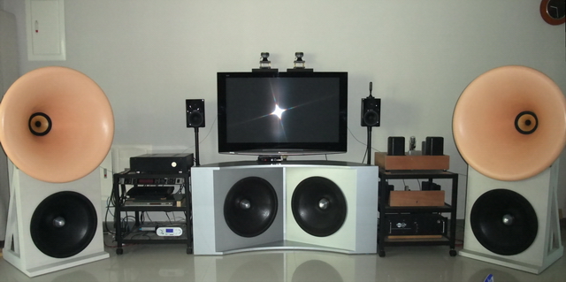

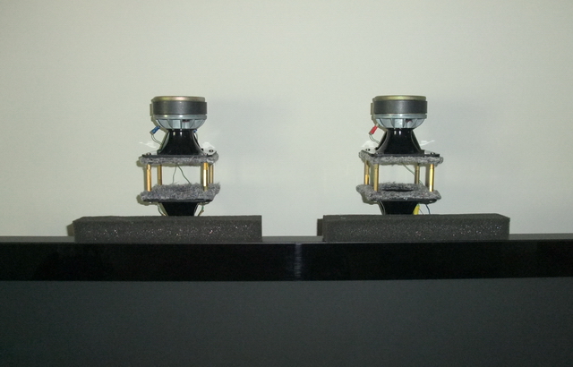

I admire the concept of OSD very much, and I finally got some spare time to try it (well, sort of... ). Trouble is, for practical reason, my existing system is located very near the wall. This brings me all kinds of problems...

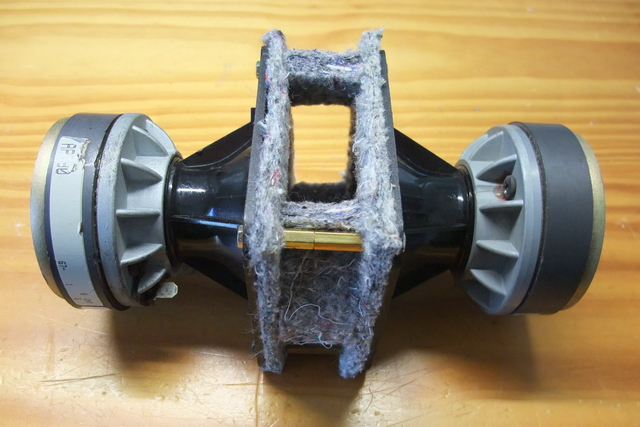

Bringing the tweeters of both channels to a very close distance, I guess the directivity should be very very wide, omni is preferable. Why? I can't explain, imagining 2 narrow beams shooting at me right from the front makes me uncomfortable. It's all by instinct.

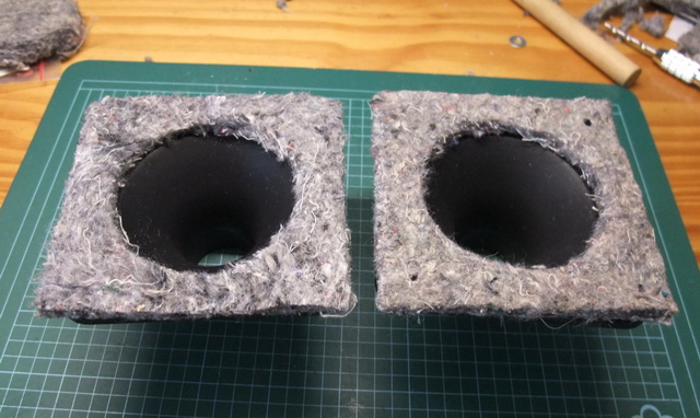

How can I get a wide spreading HF from my existing drivers? Oh well, this must be laughable, but it works to some extent. I just put 2 tweeter horns (Eminence APT) face to face, and 'hopefully' the sound between them would be 'squeezed' and escaping side way, thus forming a radial radiation.
I know it's far from ideal. This is just the easiest way to get a wide spreading HF from the stuff on hand. There must be a lot of lobing problems in every directions, but insteretingly, I can't detect any interference lobes by ears. Moving laterally, the HF sounds stay consistent. So at least it's pretty omni in the horizontal plane. And as expected, moving up and down beyond a certain range, the HF sounds collapse. I'm OK with this.
Next, how can I use this against the wall? By the wave simulation, putting a point source near a boudary produces a lot of interference lobes. So this must be very bad. Again, it's very interesting to find it's not entirely so in reality...
I tried reducing the rear refections by foam pads. Again, it's funny, it seems not much differece to my ears in lobing or smearing. Without absorption, it sounds slightly brighter overall.
The major 'loss' is the sensitivity of the tweeters. At first I separated the tweeters by 2.5cm (the distance between the felt pads around the small horns). This is probably too close, and it sounds somewhat suffocating. Later I added the distance to 3.5cm, then it sounded better. Nevertheless I still needed to re-EQ the system to get a reasonably flat response. Compared to the previous setting (HF horns pointing at me directly), I added 4.5dB above 6kHz, and supress mid to higher mid (under 5kHz) also by 4.5dB. (The LF was also turned down, but with analog volume pot, so no numbers) So it's total 9dB loss of subjective loudness at the listening position.
That's all for the tweeter only. What about the OSD? Before a major re-layout, now I can only try moving the tweeters close together (to 30cm c-t-c). The mid horns and woofers are still at their original locations. The woofers are 3.1m apart, and it's slightly further between the recessed mid horns. With listening position at the center of couch, they almost form a perfect equilateral triangle.
The crossover point between tweeter and mid is 3kHz or so. This should be very 'scary' for most audio hobbyists to separate tweeter and mid by a distance of 1.7m at such xover frequency. Ha ha... Let's just try it. How bad can it be? Explosion? So why worry?
OK, how does this smattering OSD sound? It's a very intereting presentation. The sweet spot is almost everywhere in the room. The tonal balance stays more stable across the room than my previous large toe-in (ordinary 3way) setup. The fiddled quasi-omni tweeter works pretty well in this regard.
And I found it's pretty recording-dependent. On some recordings, the sound stages seem jam-packed with the images spreading only a little wider than mono. OTOH, on some other recordings, it sounds very spacious, images spread everywhere and are in no relation with the close-located tweeters. But I haven't experienced sounds coming outside of the mid horns, yet. It's very interesting that the HF 'sparkle' is also very recording-dependent. On some, by memory, I feel the leading edges of HF seem softened or even muffled, so they sound somewhat darker. But on some others, there's no such 'illness' effect.
I also found the best listing position should be further back by about a meter or so. Overall the sounds are blent better at the position behind my desk which is behind the couch. Maybe the tweeter and mid are indeed too far away to each other.
Now this is only a first small step into the OSD concept. It's far from ideal but very interesting and also very listenable. I have no problem living with this for some time.
Next step will be quite large. I have to relayout the whole system, bring the mids closer and push the woofers further apart. Or maybe I'll dump the mid horn and make it cardioid. Xover is another big topic and need reconsidering as a whole... I have very little spare time and build things slowly, so all those won't happen very soon.
It's already very long. Any comments are welcome. :)

Uh....
OK, the odd looking and probably ridiculous tweeters wouldn't be attractive. Previously, my system was odd enough, so more oddness doesn't matter for me anyway. But this is not just about oddness.
No measurement charts? I know I know, it's almost against the rule here :lol: It's just because now I have limited access to a proper set of instrument and software. I'd like to encourge any of you, who has a system with movable units, to give this a try. Just arrange the units more or less in the fashion of: W....M..T.T..M....W laterally. Simple enough (for the first step...).
And give it a good listen, or measurement :D You'll find something very interesting. And maybe, this will be a beginning of a revolution.
