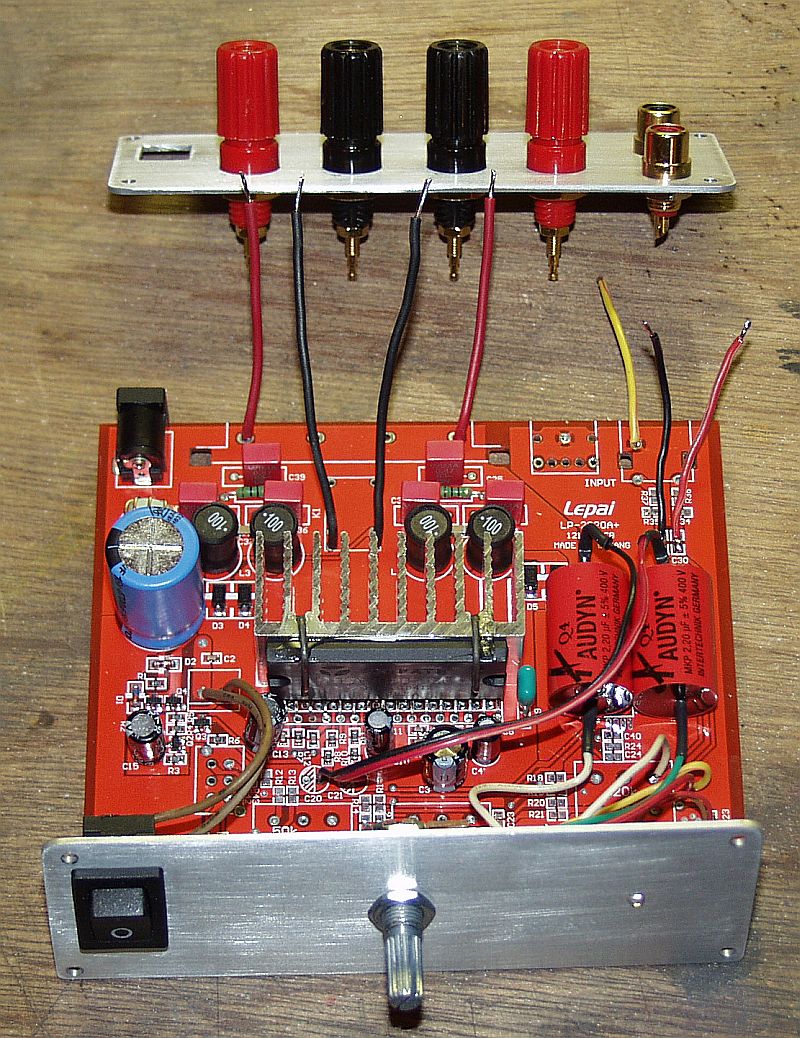

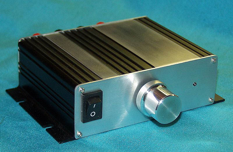

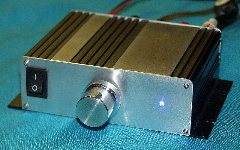

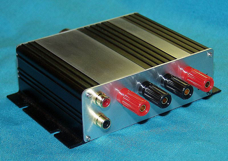

I finally got mine done. It seems like it sounds better but, it has been a week since I listened to it in it's stock form. Here are some pics....
Thanks. I just couldn't stand all the lettering on the top. It was easier to do new end caps than to try and reuse the old ones only to have unused holes left.
I couldn't find any chemical to strip the lettering off the top so I had to bead blast it, and the anodize, off. I was going to leave it all black until I figured that out.
