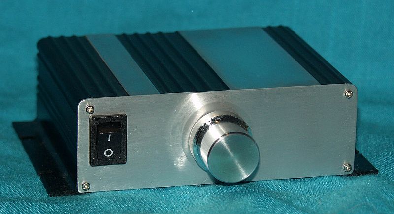

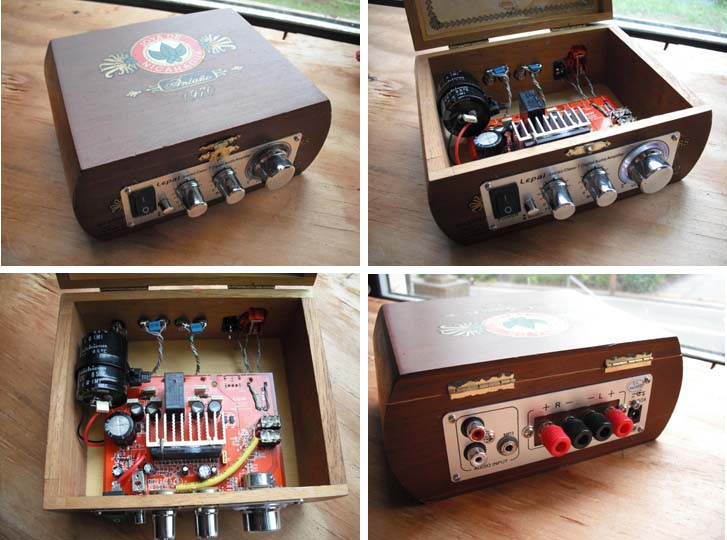

Finished this yesterday. I took Tyler’s advice and just used metal film PE caps. All were pulled from a large pcb I had in my parts bin. Large power cap is from same. If a smaller cap was used, this would have easily fit back in the case but I really like the looks of it in the cigar box. I didn't get fancy with gold connectors or toroid inductors. I plan to gift this to a family member along with a set of 2-way Dayton speakers.

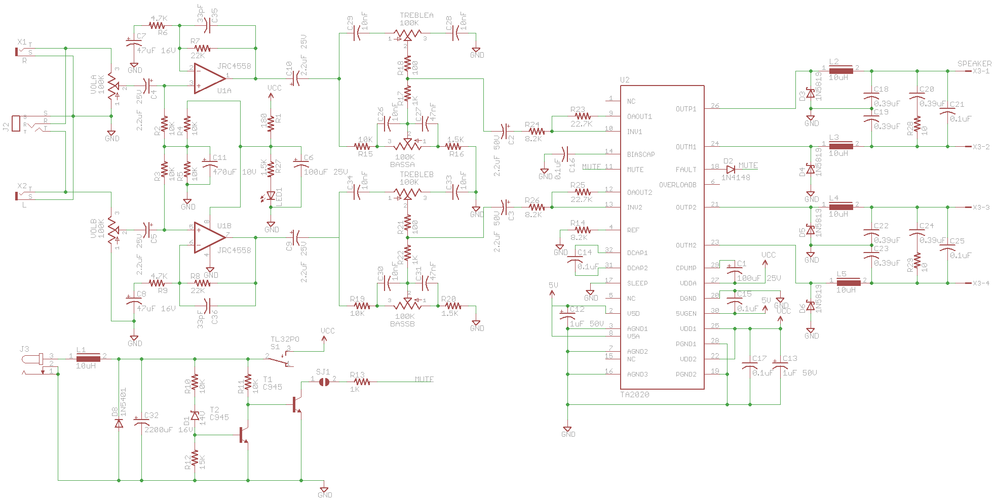

Download the TA2020-20 datasheet from the web. Combine the test circuit from the datasheet and Tyler's schematic from his op and you have the Lepai's layout.

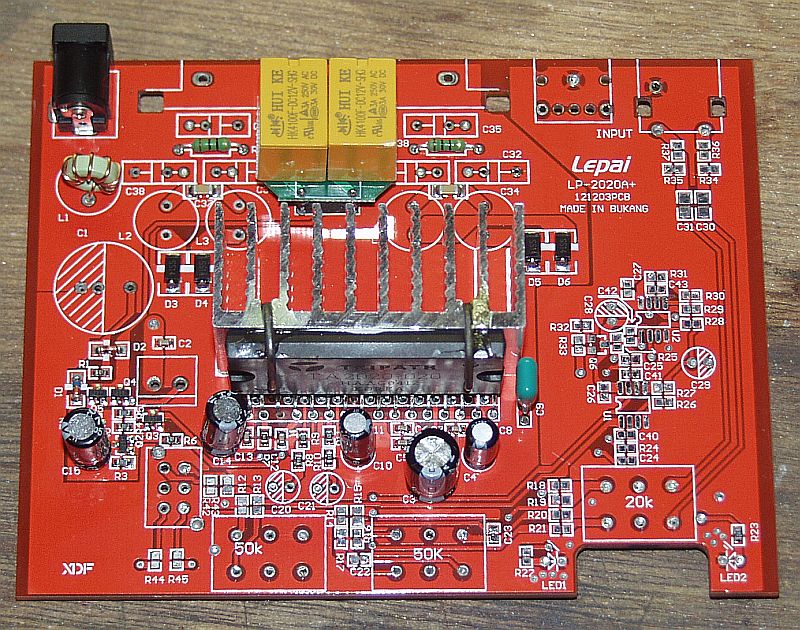

Take the 4 screws off the front and slide the board out. Connect the power cable and switch it on. Do you hear a click from the relay? You should hear one within a secord or so after engaging the power switch. Very audible, you don't have to put your ear to it.

I have had the datasheet for awhile. The relays on mine are just that, two separate ones on their own PCB soldered to the main PCB. I have not heard any clicking from them at all. I checked VCC at pins 22, 25, 27, 29 and that was all good. I believe the chip is bad because I didn't get any voltage coming out from pins 21, 23, 24, 26. Looks like I will be getting a new TA2020-020 chip from MCM unless anyone has anything else to check first. I need to order a compression driver from them anyway for a TalkBox I am building.

And I did answer my last question myself, after doing a bit more tracing to be sure. The relay does break the connection between the speaker neg. and the amp when the power is off. Regardless, I still do get a "thump", both turning it off and on.

I was contemplating how the Lepai executes the use of the TA2020 chip versus how Tripath shows how in the schematic in their datasheet and was wondering what is the purpose of the transistors in the Lepai? From what I can trace and what little I know, it seems that they are part of the power side of the circuit but I haven't a clue as to how they are used.

I did do some more tracing and they are tied into the "fault" and "mute" pins on the IC. Best guess is that they are for IC protection or to lessen the turn-on thump.
I am posting a old schematic from the first version of this amp. It was gave me some insight into what the transistors do.

I have also bead blasted the top of the case to remove the lettering and have rubbed it back out with 400 wet/dry sandpaper. It gives it a nice brushed look. I am also making some new end plates to accommodate the binding posts, new RCA jacks, and no tone controls. These will have a finish like the top of the case. I am getting rid of the lighted ring around the volume control and instead, using a single LED coming through the front to show it is ON. I am also going to machine a new aluminum volume knob and epoxy one of the old tone knobs inside for the splined insert.

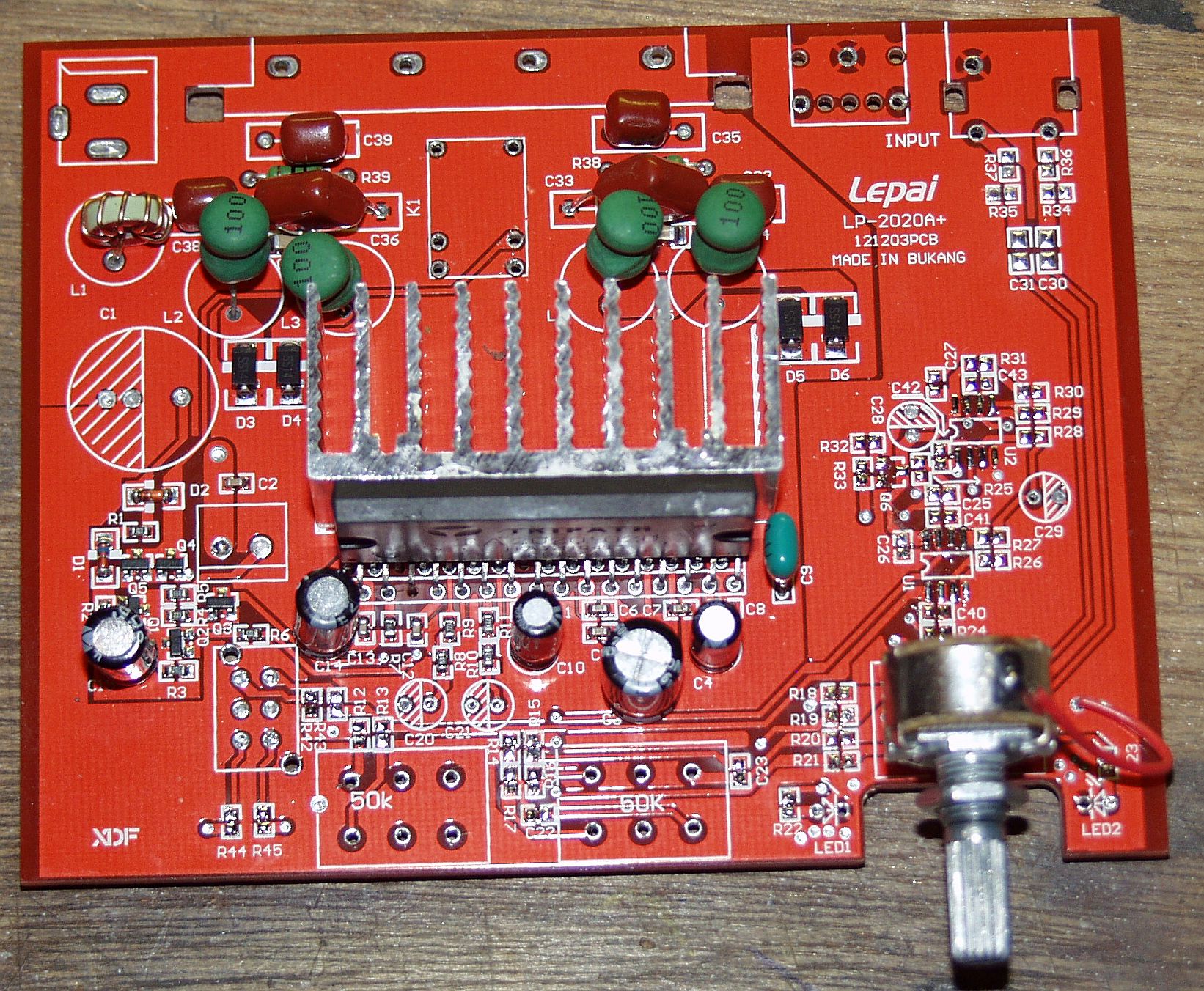

I made new end plates, replaced the input caps with Epcos PP caps. Added 2x 5600uF caps for power, I will be winding new inductors soon, replaced spring terminals with banana jacks, added gold RCAs, removed the tone controls... Etc. I'll post some pics of Frankenpai soon.
