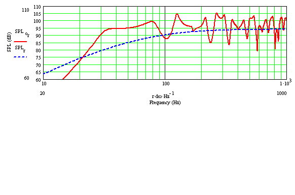

Horns don't have to have a flare constant, it just has to expand enough for 1/2 WL action to occur, changing the pipe from a 1/4 WL resonator (only odd order harmonics) to a 1/2 WL resonator (both even and odd orders) with a 1/4 WL fundamental: http://hyperphysics.phy-astr.gsu.edu/hbase/waves/opecol.html#c1
Where folks get confused is that they look at a compression loaded horn and conclude that this system is the horn because it's what the pros call them, when actually it's a 4th order bandpass speaker with a tacked on acoustically large expanding vent designed to ideally load it at the inverse of its response, so we start with a severely under-damped, limited BW speaker and through acoustic transformation convert it into a severely over-damped one of much wider gain BW.
GM
