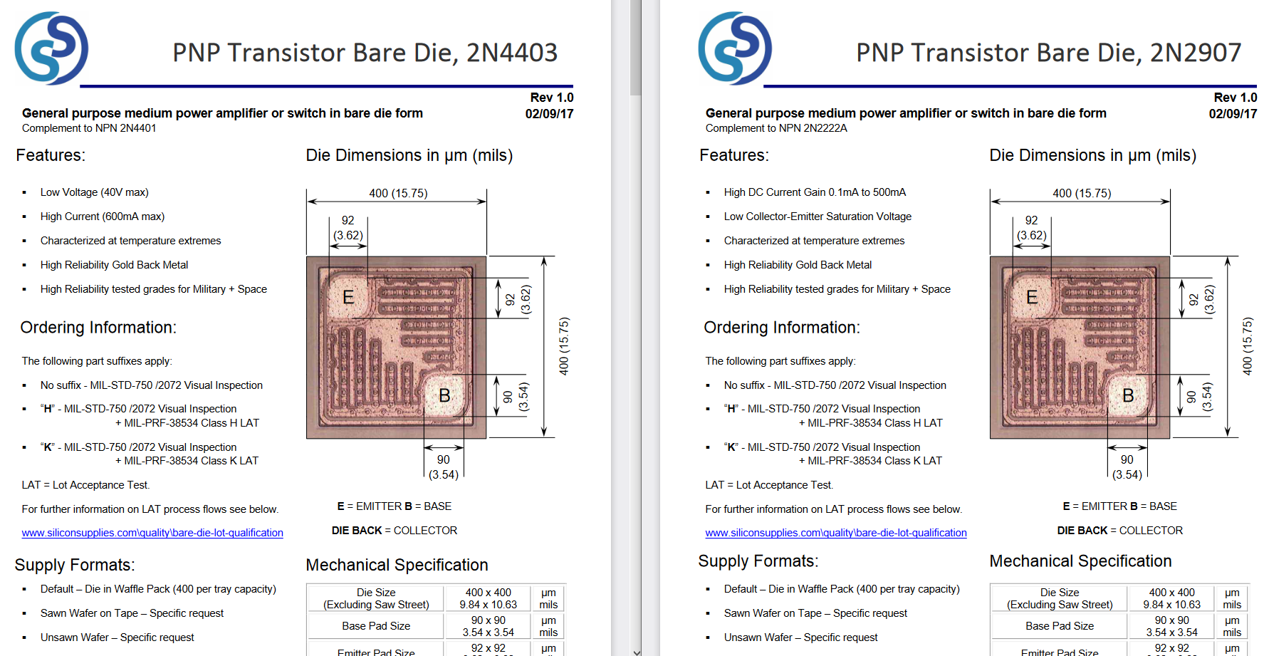

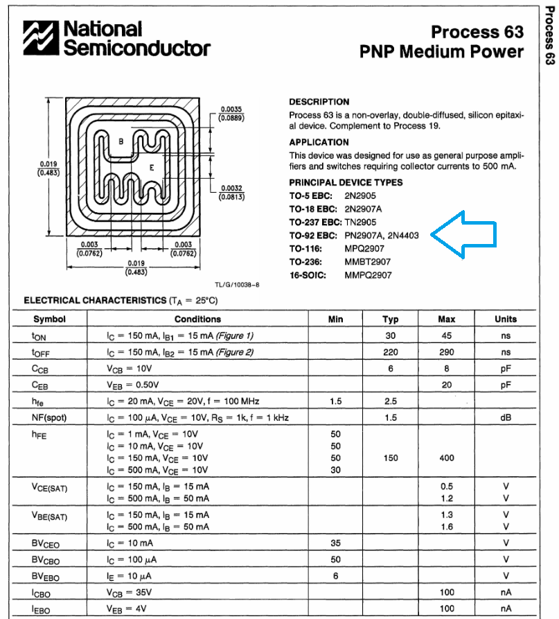

I am building a measurement LNA and it calls for (parallel) 2N4403 (which I have on order) but I had the question if there was another part number made in that same process or perhaps even the same die with different packaging or finishing.
I think the 2N2907 die is (was) originally from the same National Process #63 as the 2N4403. (See attached.)
I also believe that some suppliers of bare die supply identical looking die for 2N4403 and 2N2907.

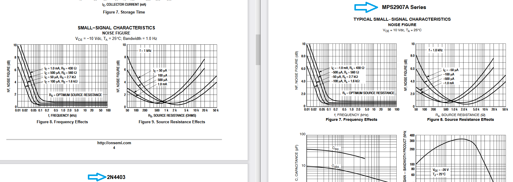

Also I believe that the ON Semi datasheets show the exact same noise graphs (see attached).
So can anyone confirm that these are the same die made in the same process? The differences being only in finishing, packaging and test?
