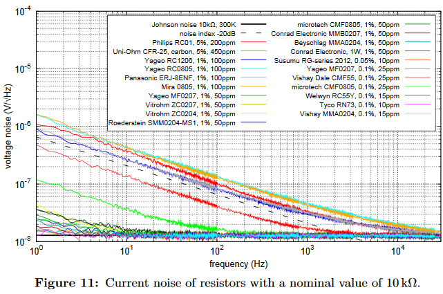

Depends on where and how they are used in the circuit. The thermal noise is exactly the same as that of any other type of (passive) resistor, but they have less 1/f noise, meaning smaller random fluctuations of resistance. By the way, wirewound resistors are even better in this respect.
As far as I know, the 1/f noise is usually specified in microvolt RMS in one decade per volt of bias voltage, so actually in ppm RMS resistance variations over a 1:10 frequency range. The greater the bias voltage, the more noise you get; without DC bias, you only get sidebands around the signal.

This is actually what I don't understand yet. Why do you think that 15nV is pretty high. Is it based on audibility? This is for line level audio application.
