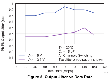

I estimate the output resistance of the isolators at 50ohm (0.2V drop at 4mA output current) assuming they're powered from 5V. At 3.3V the Zout is higher.

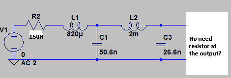

So for 5V supply you'll need a 150R resistor between the ISO7640FM and the LC filter.
In regard to jitter, the plot shows about 0.8nS which corresponds to modulation of the 50/50 duty cycle at zero (1.4MHz squarewave) by around 0.1%. So you'll be getting about -60dB peak noise due to this jitter. That's not to say your audio bandwidth SNR will only be 60dB though as the bulk of this additional noise will be ultrasonics.

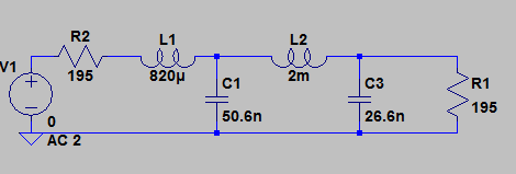

Butterworth or Chebyshev would be fine - I suggest Butterworth as its simpler to design. The corner frequency depends on you - perhaps 50kHz -3dB would be fine as a first attempt.
A 4th order LC would have two series inductors and two shunt capacitors, followed by a resistive termination
<edit> Attached a schematic based on a design I did for an ESS DAC. Its Butterworth but 30kHz -3dB.

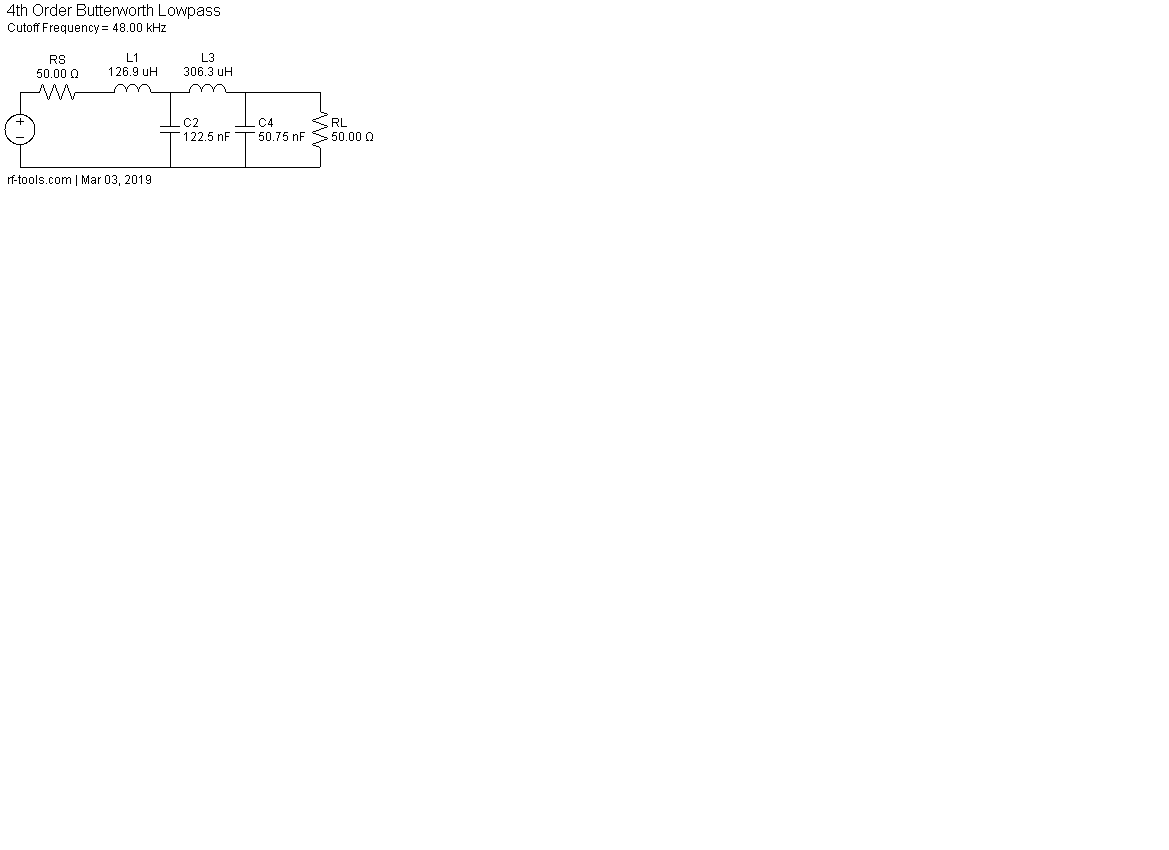

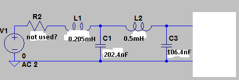

How can mod the filter for 50 ohms characteristic impedance to drive directly the Amanero?

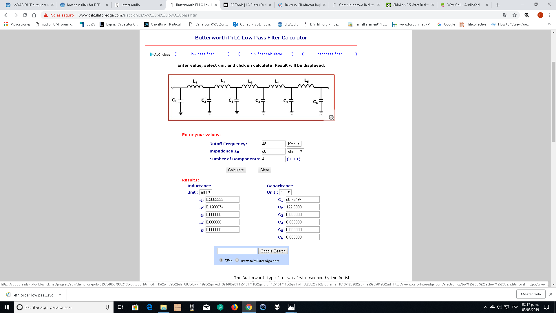

Using an online calculator result is attached schematic.
If you connect this filter to a 100k input impedance (=100k load) then that's totally OK. No need to match the filter to the input impedance.
I think I made the filter with an online calcuator then tidied it up in LTSpice. Can't be sure which online calculator, could have been this one : Chebyshev Pi LC Low Pass Filter Calculator
I did mention I wasn't sure it was that calculator ....
Yes sorry. I only want to contrast your design to be sure is good.
