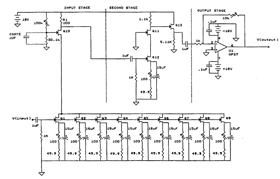

jackinnj said:"An Ultra Low Noise Amplifier for superconductive Detectors" -- each 2sk152 is set to draw 10 ma. so this thing really cooks -- note that for audio there are quite few things which have to be "fixed":
Interesting. Seems like Q10 would really cook at 90mA.

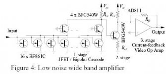

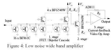

And here is 16 parallel JFETs. Any examples of something outrageous like 32 parallel JFETs?
yes, the authors did point out that some of these devices would really cook. each amplifier section reduces the noise by SQRT(K) where K is the # of amplifying sections, but it also increases the current by K^2. the authors determined that 9 was the optimal number of amplifying sections.
