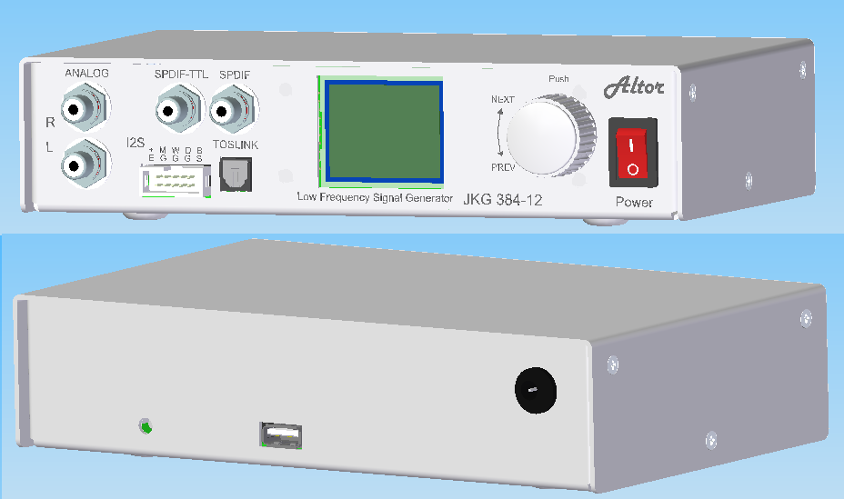

Hello friends.
Maybe this will be interesting for somebody:
JKGEN - ALTOR AUDIO

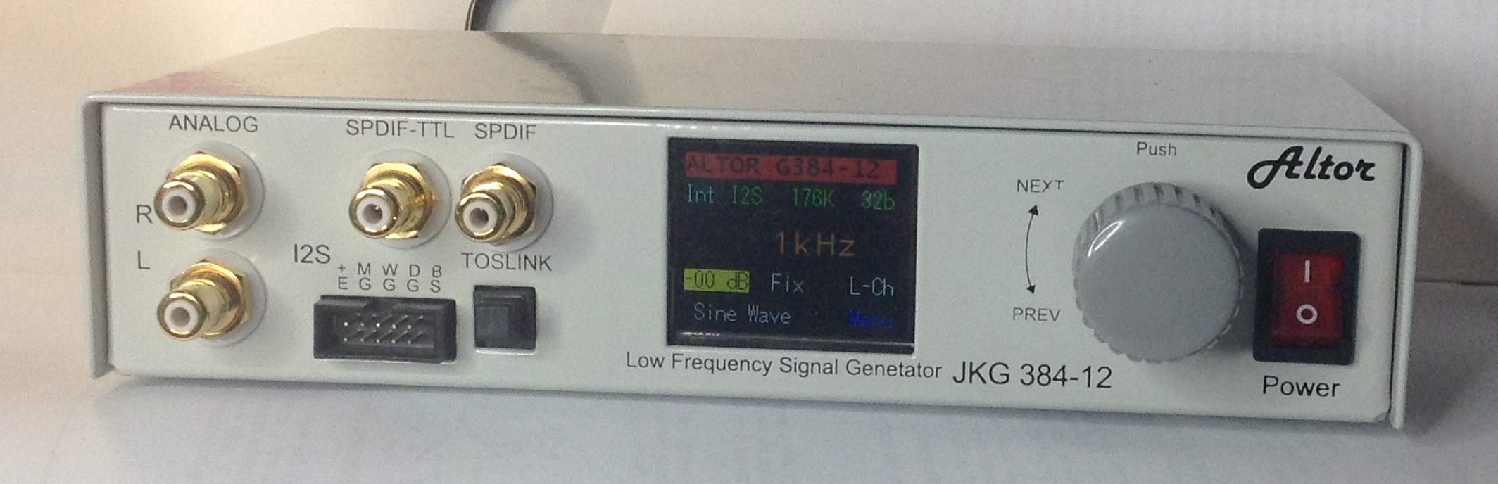

BTW, I put a CAD image to the 1st message, and can't edit it. So, here is a real device's image:

I think the Left channel is always drawn on top, atleast on schematics. Don't know about RCAs...
Gajanan Phadte
It is not so important, in normal operation both channels are the same.
User can select between in-phase channels (L+R), out of phase (L-R), one channel (L or R) or bot mute.
I implement out of phase signal when I prototyping tube push-pull output stage.
BTW, I'm also have some external accessories to the generator:
- comparator, to get the square wave with 500v/us rise/down time
- 2CH high voltage amplifier (200v p-p) - for tube circuits development.
I do not have a plans to manufacture these accessories , but I can provide the empty PCB for DIY, as a gift with generator.
(this time there is no PCB for high voltage amp, I make it on a breadboard, but will be...)

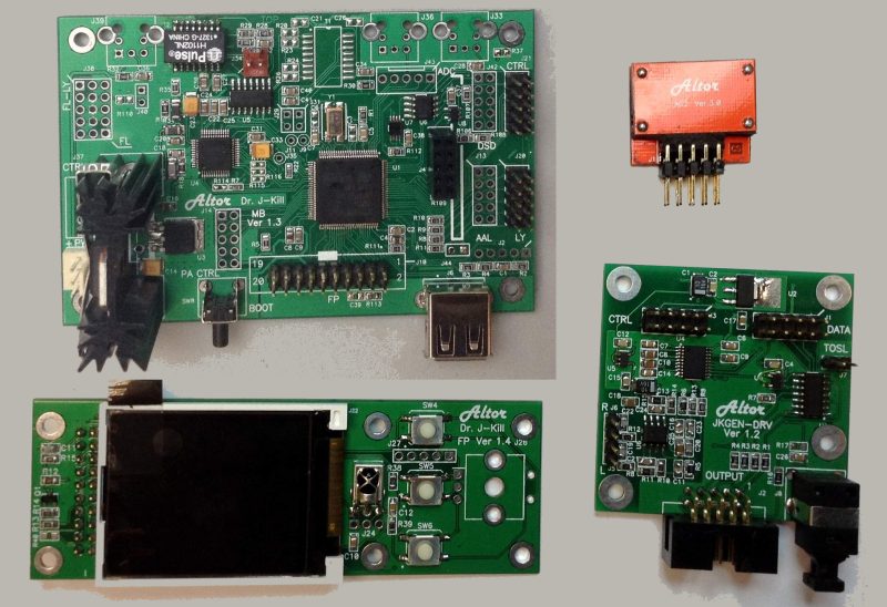

Are you planning or already set up with a modulatable master clock for the jitter reduction testing?
What is not included in the DIY board kit? It seems to not include the DAC board. Are all the other essential parts included in the PCB kits, including the display?
It is not possible in the current HW, but it is possible to use external 512Fs or 1024Fs clock.
It is simpler to say "what included" :)
JKGEN Kit - is what you see on a photo.
JKGEN DIY Kit - initially, there are 3 bare PCB (CPU, Output, Front Panel) plus asembled Clock Module.
And only 3 non assembled (used should solder) components:
- CPU with the necessary software inside (bootloader + firmware ),
- Display,
- Encoder.
All other components (including the cables) the user should buy and solder by himself. But I'm flexible to make custom order, and to add some other components (except R and C) with or without additional money (depends which components).
Most comonents that I use are from Mouser and DK.
DAC board includes - "Output".
Full device consicts of 4 molules:
1) CPU Board,
2) Clock Module
3) Output Module (I2S Buffer, DAC and TOSLINK)
4) Front Panel.
Here on a photo you can see all set.
Output Module is old version, with one minor mistake, now ther is a new version.
Front Panel can be or with 3 pushbuttons or with encoder. At photo - with buttons.
(Don't pay attantion to the IR receiver at Front Panel Module and free component places at tha main board - these modules are also used at another product, Jitter Killer).
