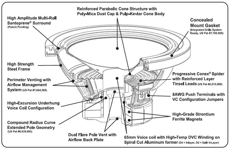

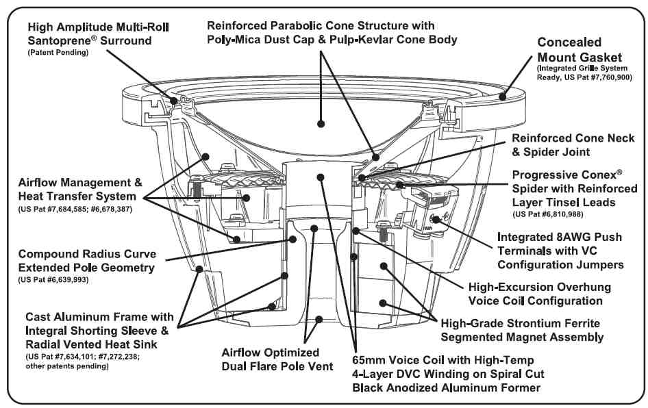

The cutaways for the Alpine SWS and SWR speakers look like they might be suitable for modification, they are not aluminium coned though. But, I have no practical experience with those.
It's funny because the previous series of those drivers did have aluminium cones with an Xmax of 16mm. Now they are using a plastic bucket insert design which is no good for this sort of application.

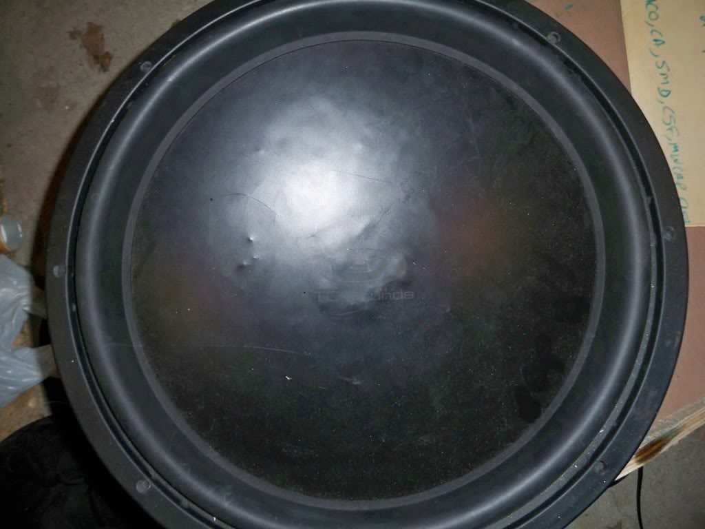

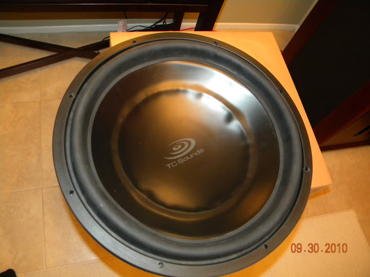

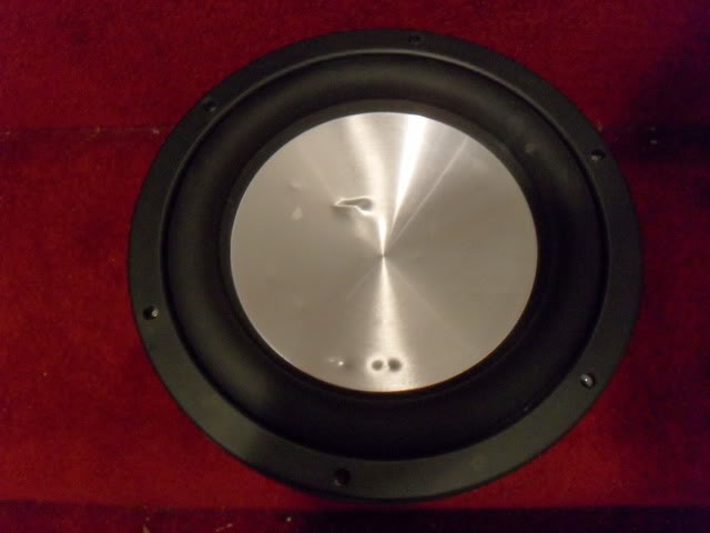

from those pics only the third looks as if the dent occured due to overload.
The first and especially the second look like some nerd tried to evaluate the amount of stroke by probing with a screwdriver
When I accidently dropped a knife into my stainless kitchen sink a similar dent occured.
So far the TCs I had took any 'normal abuse' without issues.
But then, there are nerds who certainly define abuse different.
If You look for vids on Youtube, where windshields of cars break while the drivers still work flawlessly, one may wonder though if the dented drivers weren't purposely destroyed by a childish or idiotic mind with a deep desire for destruction.

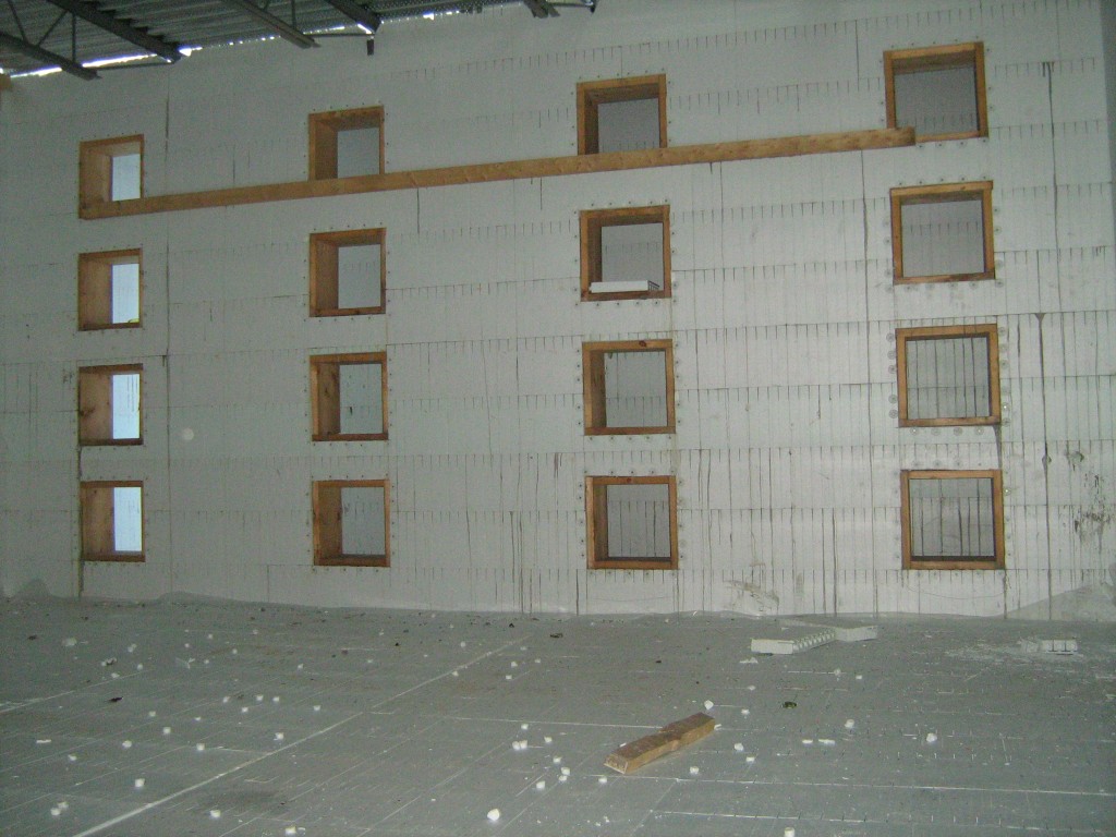

I will also subscribe to this thread as i will be needing 16 15" servo subs to fill my home theater infinite baffle concrete wall holes in the near future
and always enjoy having quality options !!
old pic from the construction time .. ( ouff..time flies! )
