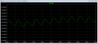

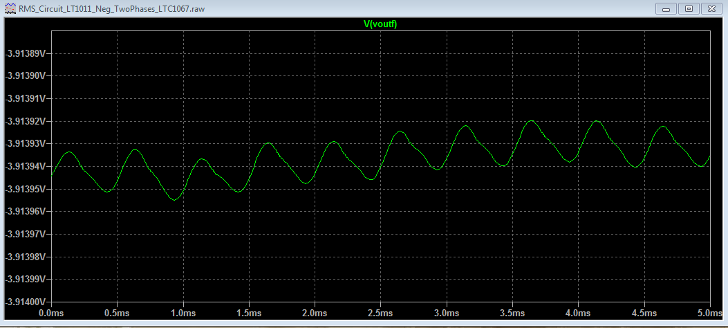

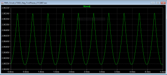

Here are preliminary results of a simulated two-phase, negative peak-value detector with two LT1011 comparators, after the idea of Demian Martin.
First plot shows the output of the comparators filtered by an RC filter with a time constant of 4.7msec, and the second one the output of an LT1067 SC filter with a corner frequency of 1kHz. The remaining ripple appears to have an amplitude of 10uV.
SC filters can track the oscillator frequency, this particular part needs a clock frequency that is 100 times higher than the desired corner frequency, which should not be difficult to generate from the oscillator signal.

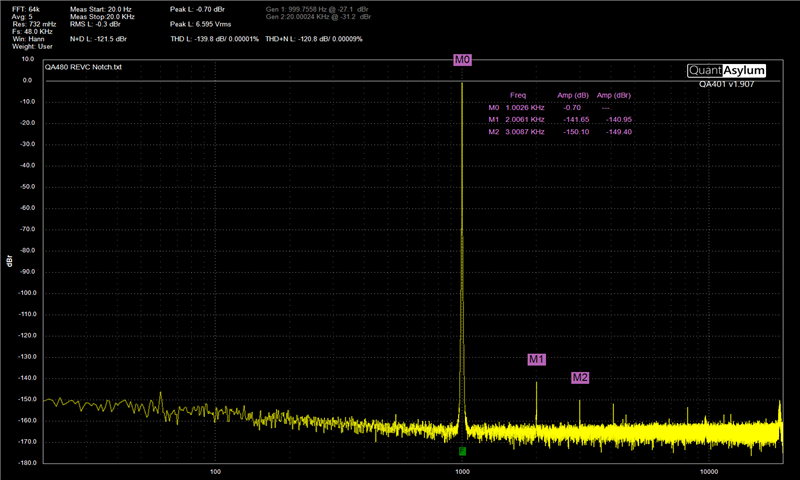

I have built many of these over the years. The lock-down in the US has given me the time to build the 3rd version PCB that is delivering about 10 dB better performance than the 2nd version I've used for a while now. More discussion on the second version is here with some writings on 3rd version here.
The plot below is the current performance of the new REVC board. What you see is the oscillator going into a notch and then that goes into the QA401. Note that the notch correction is swept, saved and then applied in the QA401--what you are seeing is after the signal processing hocus pocus. The THD is about -140 dB and the THD+N is almost -121. The REVC board added a 0..63 dB attenuator (relay-based, with 1 dB steps), 0/12 dB gain on the oscillator and focused a lot on the notch noise. The notch noise is now around -120 dBV (20-20k, no weighting, input referred) and the notch has a fixed 12 dB gain on the output.
The first link above discusses the lineage of the oscillator part of the design. The Jim Williams design from 2011 uses a CdS photocell in the AGC loop, with just a few mV across the CdS resistor (key to distortion). The updated oscillator portion of the design (Januscard) improved on that but also keeps the photocell.
The internal supplies are +/- 15V, so hopefully it will be able to give super clear output from almost +20 to - 63 dBV. The relay code isn't working yet. The last version had some distortions that was dependent on switched attenuator engagement, which I never really understood but thought might be layout related. Hopefully it got a lot better.
If I do another rev, it will include a shield. There is more 1 kHz and 2 kHz leakage in the notch than expected (about -150 dB, which with the 12 dB gain means the leakage is hitting the notch at around -162).

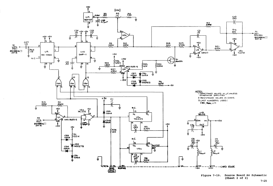

The sample and hold solution has been used effectively to get really stable and accurate AC sources for 50 years. You need to sample at precisely the peak of the waveform but that's the zero crossing of the cosine so not a difficult problem.
The implementation in the Boonton uses a single set of time constants for 10 Hz to 140 KHz with essentially no variation in output to 5 decimals. It also settles really quickly. it does use a number of parts, some of which are types no longer used. That where an ADC can do it very nicely as David proved. Below:

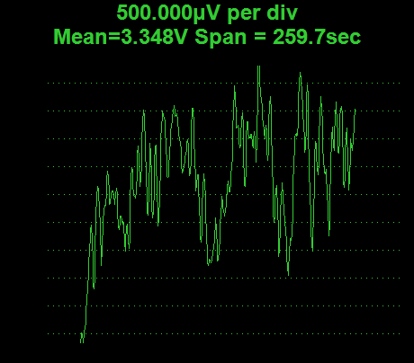

I've written up my experience in bringing up a Jim Williams/Januscard oscillator paired with a passive notch. I think Demian and Bob's explorations are important as the 2H considerations Williams explained in his article related to LED bias are real. If I build another version, it will be with each block individually shielded to see if it helps. I think the performance limitation at this point is either radiated or conducted 2 kHz from the rectifier into the notch.
Link is here: Notch Filter Hardware REVC - QA401 - QuantAsylum Forum
If anyone is curious, the picture I attached is the loop control voltage on the NSL32 LED. This measurement has nV capability, but 400 mS interval, so there could be a lot more action that isn't shown, but given the loop response (~3 sec) probably not.
Each 500uV division corresponds to about 1uA of LED current. So, the loop is making adjustments as small as hundreds of nA to the LED current.
