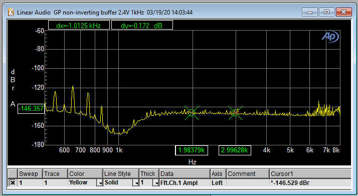

It does show the signal level in a DMM-like display of course but that is not the same as the fundamental magnitude in the FFT, right?
A typical display is as attached.
Jan

Logical would be calculating the signal level in DMM from samples directly, not using FFT.
But how about using a regular spectrum display, without the notch filter? The FFT method used by AP should be the same. We do not need the harmonics, just the fundamental.
There is no fundamental on your screenshot down to -170dB, does the notch really reject so much or is the fundamental removed from the chart by the AP software?
AX tech editor
Joined 2002
Well, in this case I was using the external passive twin-tee, hence the -170. I did set the reference to 0dBV so it shows the fundamental referred to that 0dBV, attenuated by my external twin-tee and it's own internal notch. But the principle is the same.

The input is an autoranging/gain circuit, followed by analog level metering and a selection of filters and/or the notch. After that, the signal goes to the ADC.
Using the external 40dB twin-tee means that the dynamic range requirements for that ADC is lowered by 40dB, thus the very low distortion limit.
