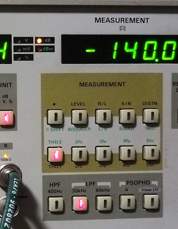

Demian, what model did you get? 725-D I hope.
-Richard
No an AM70A which is a newer design but shares a lot.
It resembles the Panasonic VP-7722A in most ways -- made and maybe designed also by Mitsubishi Heavy Industries. Says tag in rear panel.
The 7722 used 2 notch filters. Does THD/THD+N and IM and has built in generators.
What makes the 725D most useful is the monitor output is scaled with the instruments range. It is not with the 7722 which makes the monitor much less useful.
Is the monitor port (residual distortion) scaled to the AM70 instrument's range setting?

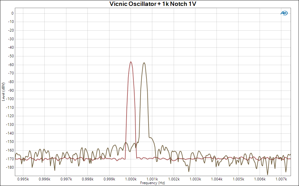

OK, first the Vicnic oscillator drift. I confirm by direct freq measurement it drifts a few Herz over 15 or 20 minutes after switch-on. The attached confirms that.
The wide fundamental is from the Vicnic, the narrow from the AP generator. Both 32 averages at 1.2Msamples FFT.

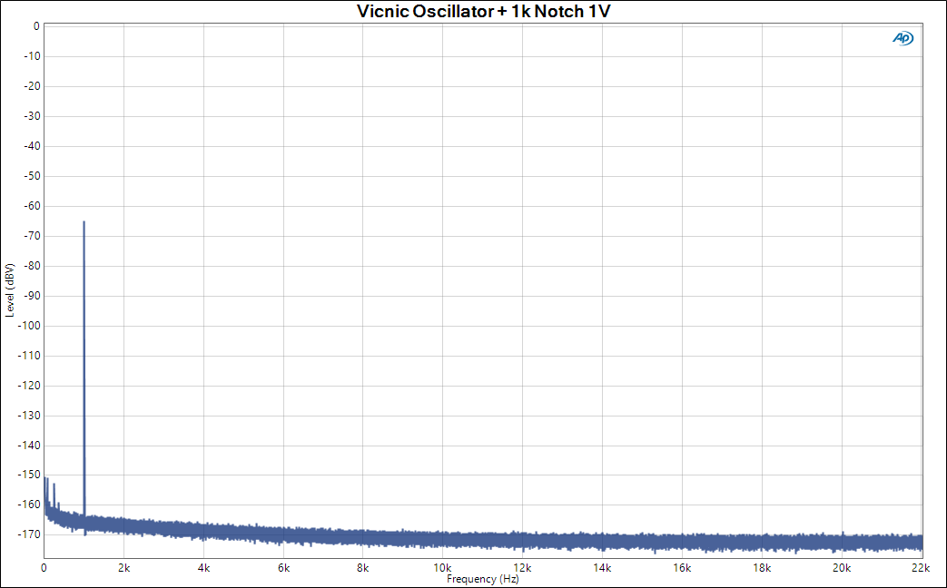

Finally, here is the Vicnic again but now a single sweep to exclude cancellation of harmonics due to oscillator drift. Clearly no harmonics above the floor.
And a blowup of the two fundamentals, with a single average for the Vicnic.
This is one hell of an oscillator and with the passive twin to decrease the dynamic range requirement for the AP ADC, gives truly stellar performance.
