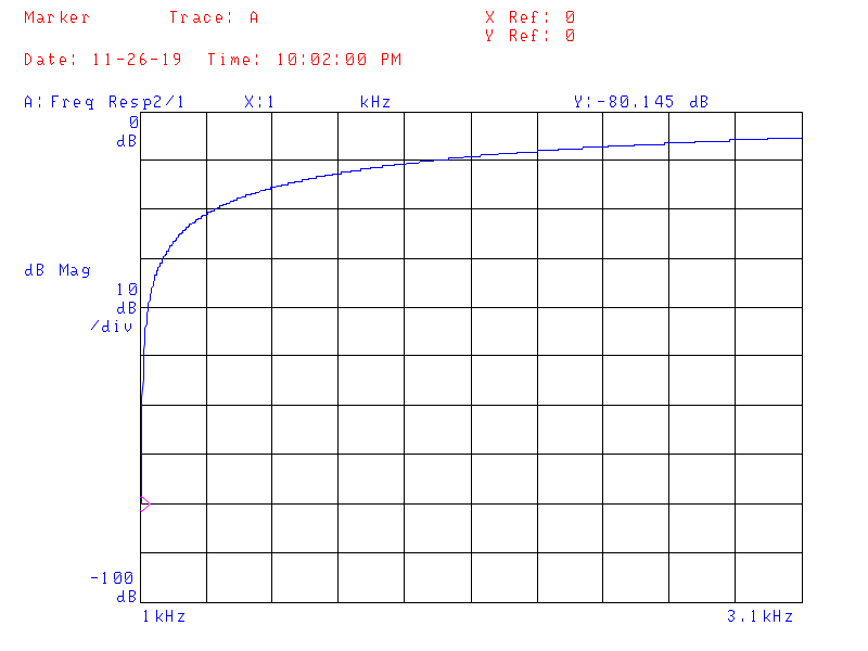

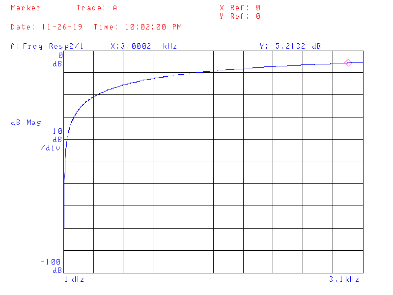

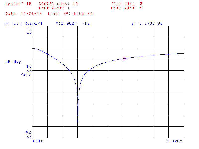

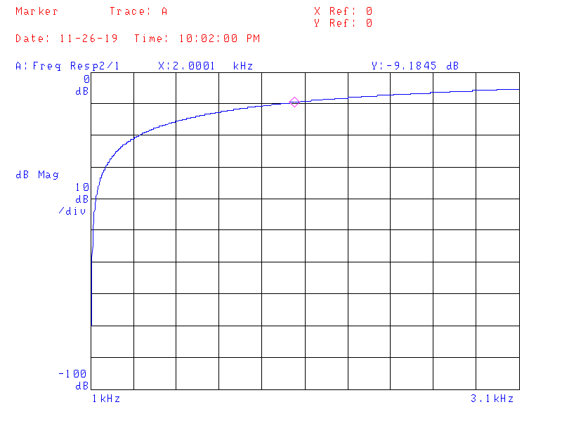

Notch attenuation measured with 1Vrms, is exactly as Victor have stated: passive twin T notch attenuation -9,1dB for the second H, and -5,2dB for the third H. Notch deep is -80dB.Quote:
Originally Posted by Monte McGuire
I think it'd be a good idea to just measure your notch directly. Just measure the gain at 2kHz and 3kHz and you have the conversion factors actually in your notch - no need to quote something else. I guess you need a general purpose oscillator for that, but for measuring gains, it doesn't have to be that clean at all to be useful. A sine wave generated by a computer sound card would be more than acceptable, as long as the frequency was correct. But, you can verify that using the same spectrum analyzer SW.
This is the good way for to get right scale.
I used that scheme for to calibrate the measurements with -140dB markers:
https://content28-foto.inbox.lv/albu...wMeas/Mix4.jpg
Also needs to note, that the typical passive twin T notch attenuation -9,1dB for the second H, and -5,1dB for the third H appears only in "ideal" condition, when the source impedance is "0" and no load at the notch output. In real conditions this attenuation will be higher. When the source impedance is 600 ohm, the attenuation would be app. -10,2dB for 2H, and -6,5dB for 3H.
