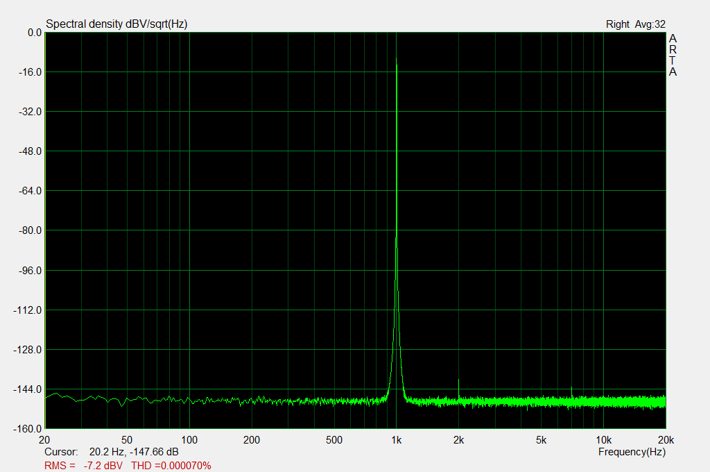

You are right, I tried another pass with -20dB output (-17dBFS) and H3 went down significantly, see attached. The grand total THD went down to -120dB.
Very, very difficult to keep such a sound card based measurement setup within the optimum limits and reach the ultimate performance. I doubt it could be kept stable for THD measurements much under -120dB.
You definitely won't get there easily. Once you have it all down it should be repeatable. -120 dB THD is probably as good as you can expect. -100 dB THD+N seems even harder. I think the software is getting some of the source's skirt as well as other noise. The AK5394a is better by as much as 10 dB in ideal circumstances. it costs almost 20 dB more to the mfr. as well.

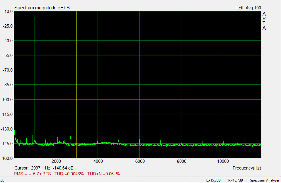

FWIW here is the Xonar DX loopback at -15 dBFS Win 10 ASIO. The performance is limited by the other noises. The distortion products are at around -128 dB. The other junk dominates the floor. However turn up the drive to -10 and the harmonics increase more than 5 dB. I don't know if its source or ADC. Not really inclined to do more research on this.
