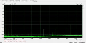

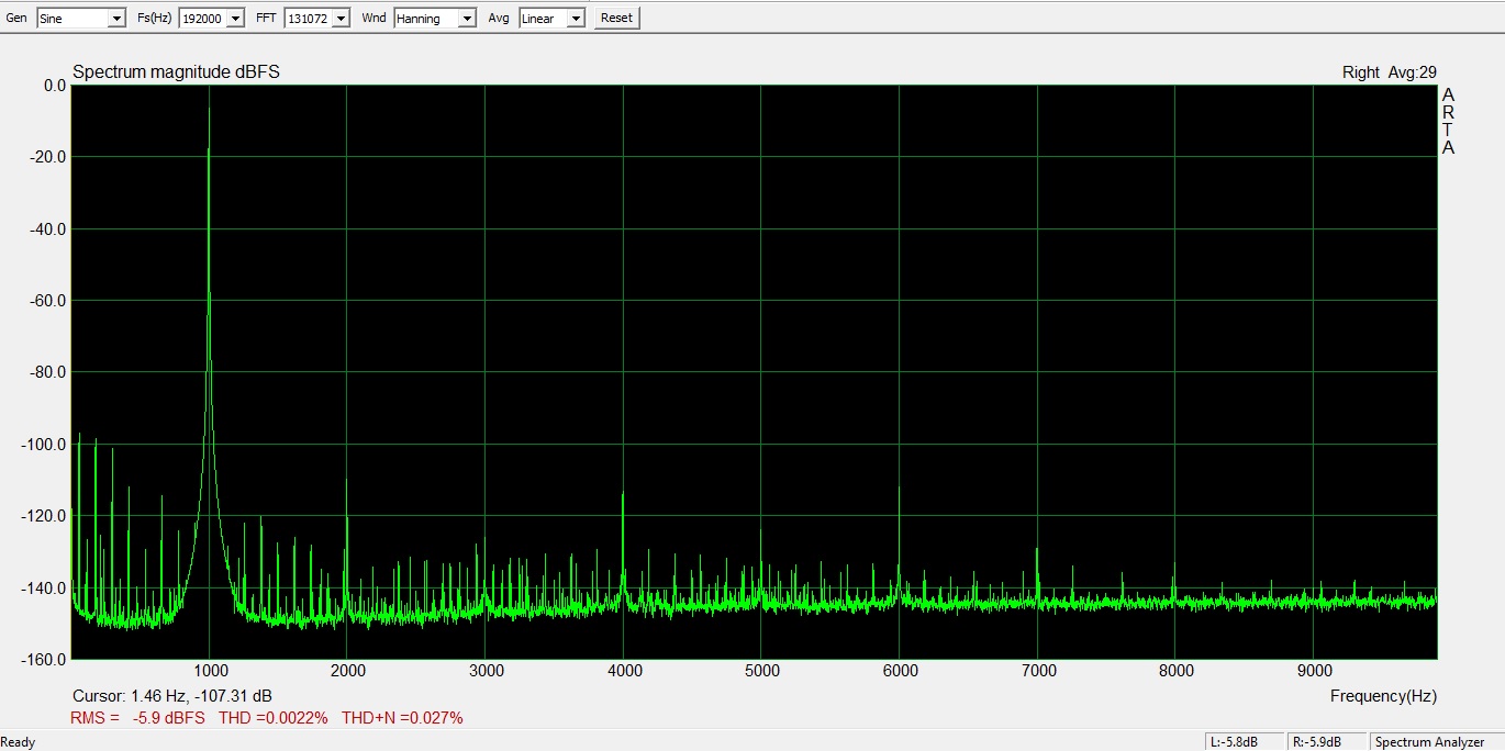

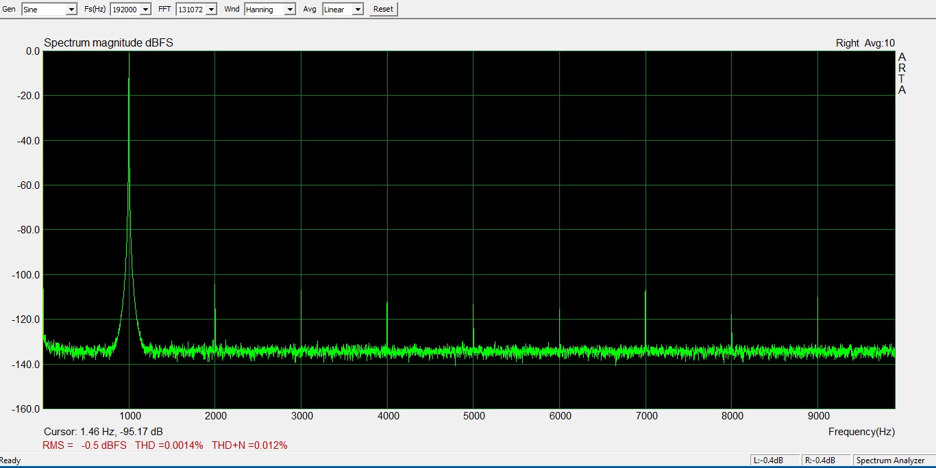

I don't know how you guys get those outlandish performances out of sound cards, I may do something very wrong? I had the opportunity to check 3 models:
- Asus Xonar Essence STX (PCIe)
- M-Audio 192 (PCI)
- Asus Xonar U7 MKII (USB)
They all use top of the line A/D and D/A from Cirrus (Xonar U7) TI/BB (Xonar Essence) and AKM (M-audio) and also the best you can get in op amps.
None of these cards can reach at 1KHz better than 0.0015% THD and 0.01% THD+N in loop back, by far the best being the M-Audio 192 (I suspect because it's the only one having balanced inputs and outputs). The Xonar Essence has about 0.002% THD (after replacing the NJM5532 op amps with LME49710) and the Xonar U7 MKII has about 0.004% THD. In all cases, the limitation appears to be the A/D converter, since the distortions appear at the same levels, by feeding from a SG505 low distortion generator, at optimum level.
I am in particular surprised by the Asus Xonar U7 MKII USB performance (or lack thereof), since it uses the flagship A/D and D/A from Cirrus (the owner replaced the original CS5361 A/D with the better, pin to pin compatible, CS5381, the D/A is CS4398). Op amps are rail-to-rail LME49726 with 0.00002% distortions. Both 2nd and 3rd harmonics are at -102dB, best case.
Using ARTA with ASIO for measurements.
Waly I think you missed something, these are all what I find too. With respect to THD I presume we are talking about what we see after a notch filter.
None of these cards are useful at full scale in to better than 100dB or so.

Trick #1 lower the level. I find -15 dBFS to -20 dBFS gets the best results.
Trick #2 get as much hum out of the card as you can. The balanced to differential helps a lot. The hum and noises dominate the distortion readings
Trick #3 waste a lot of time f'ing around with it. Even the host PC makes a difference if the supplies are poor or the noise level is really high. The three cards you tried I have not. The Asus Xonar DX is the first Asus and that only because of the low profile.
The pro cards tend to be better executed for whatever reason. Probably because they will get flack from users faster.

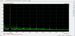

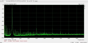

Ok, so I've put quickly together a twin T, with what was around; unfortunately at 5KHz, since the only decent caps (dielectric, 5% precision and enough to sort 3 pcs.) I found were 3nF polystirene. Got some metal film 0.5% and the result were pretty good: -58.3dB attenuation @5.0475KHz (measured independently with a SA).
Redid the Asus Xonar U7 MKII USB, see the attached results; 5.0475KHz notched is -69dB, it adds up with the notch attenuation and the low output (had to keep it low, the whole thing is powered from the 5V USB, max output signal is -3dB, used -9dB (-3dB max from calibration, -6dB from generator setting) in this experiment). H2 is at -128.8dB + 9.6dB = -119.2dB and H3 is at -106dB + 5.8dB = -100.2dB so the total is pretty much H3 0.001%. Not too bad, but still worse than what I would expect from top notch A/D and D/A in loop.
I'll redo the Asus Xonar Essence STX when I have the chance (needs f'king with the PC internals, something I deeply hate to do).
