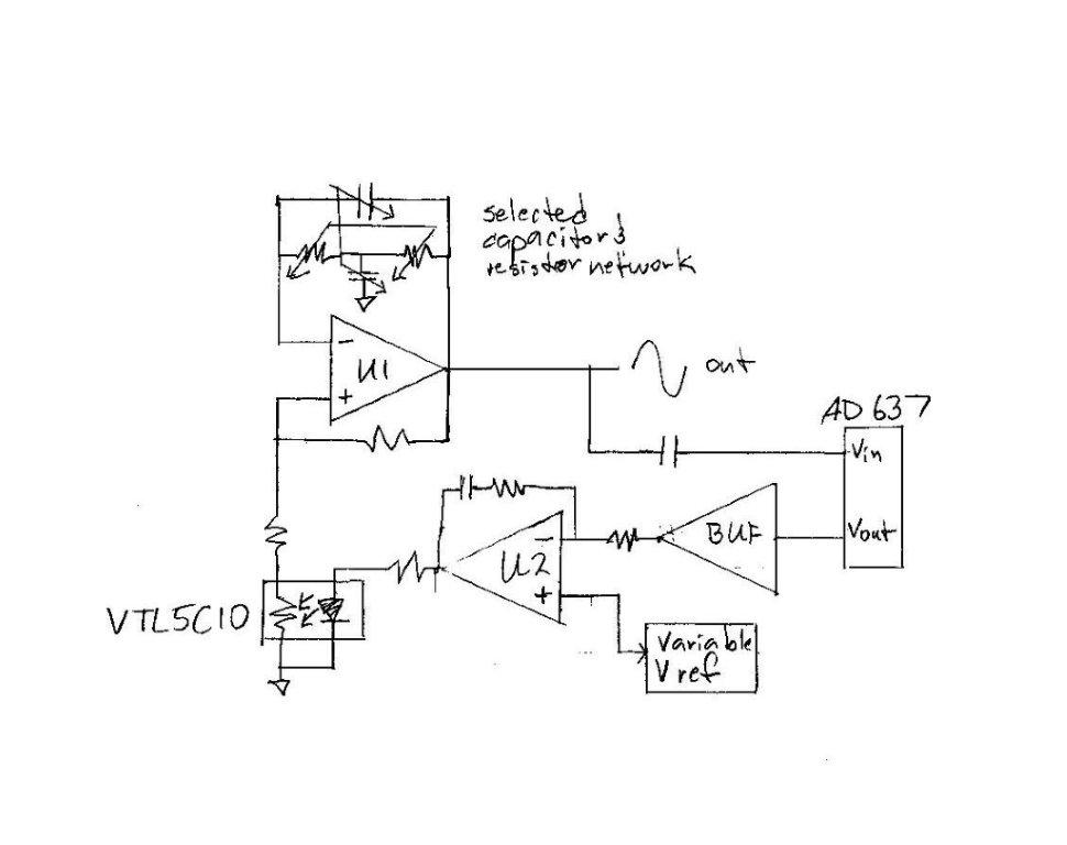

What about this one? It's a version of a bridge T oscillator I came up with that has an rms->dc converter (AD637) with a VTL5C10 as the variable element in the positive feedback leg of U1. U2 is an error amplifier and the variable Vref sets the output level. It's just an outline, obviously. Please feel free to rip it to pieces...
I just realized that the AD637 has a built in buffer, so BUF isn't needed.

Hi DB,
This is a nice circuit, and may prove very worthwhile.
The full-wave detector in my oscillator is not a true peak detector because it has a significant 10k resistor between the FW rectifier output (from two open-emitters) and the agc filtering capacitors. This seems to work better than a true peak detector in this position.
Although I always worried a lot about the agc ripple, it does not appear to be the limiting issue in distortion in my oscillator, but rather the small distortion of the JFET in the agc. There is a noise/distortion tradeoff there. The fact that agc is not a big problem for me is partly due to the fact that that the agc filter capacitance is range-selected and that anti-parallel diodes greatly reduce the agc feedback amplitude once the oscillator has settled.
Another approach is available for reduced agc jitter, and this is a result of the beauty of the SV providing in-phase and quadrature outputs. Instead of just using a full-wave rectifier (two phases), one can use a 4-phase detector by connecting FWRs to the quadrature output as well (as long as level differences between the quadrature and in-phase outputs are close to being the same). If one wanted to go to a real extreme, they could go to 8 phase detection by combining quadrature and in-phase outputs to form yet another set of detector signals.

Hi Bob,
Thanks for your comment.
I wasn't singling out your oscillator as benefiting from this TH. I was just using it as an example of a very popular and high performance SVO.
I tried the quadrature peak detector approach a few years back and found that it requires
a lot of calibration. If the balance of the signal is out even a small amount from gain differences, offsets and mismatched diode the output can look very ugly. Although fluke proved that this can be a very reliable approach. I can't imagine trying it with eight.
If one wanted to get crazy with this TH it could be done with the quadrature arrangement. The quadrature stuff can get pretty noisy and requires a lot of filtering.
I'm looking for something that's simple, quiet and non intrusive to the oscillator. But I think I will be hard pressed to come up with something that outperform
your design.

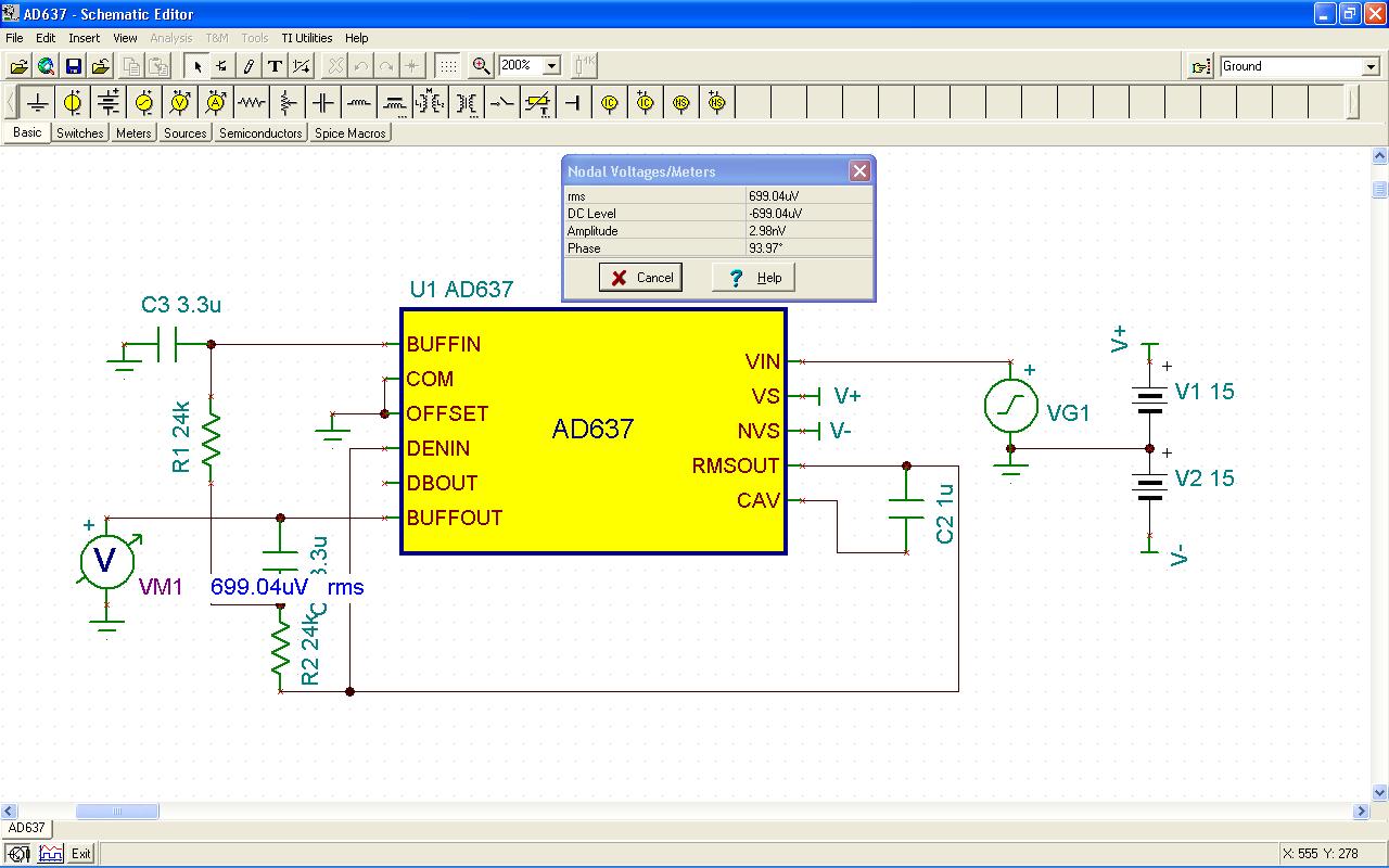

Anyone expert on the AD637 rms-DC converter? Input in above sim is 1V p-p, output from the chip is 699uV DC. I thought it should be 707mV DC?
I'm just going to have to hook it up in real life. I don't have the necessary patience for these stupid simulators!

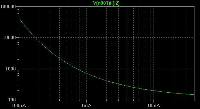

Here's an equation which describes the VTL LDR behavior --r2 is very high as the errors of a few percent are offsetting. I plugged the datasheet from the VTL5C9 into Eureqa and went to the deli for a sandwich:
The lines are quite compressed at the low R end, so the errors exceed 10% as the current approaches 40mA.

Jackinnj,
I feel like I may have wasted your time a bit. When I got into the original Vactrol spice model I found it was table driven anyway. However spice only does linear interpolation between the data points which can be seen on the test plots, so I converted the model to use your equation.
To borrow your expression, that turned out to be a little above my pay grade, but I learned a few things about spice and now it works fine. It might run a bit slowly but so what. Checking the test plot (now smooth) It looks like you took the points from plot line no.2 on the spec sheet graph.
I've yet to sort out the time constants, they don't look quite right.
It's not instantaneous -- and your averaging capacitor may too large. Try running the sim with an o'scope and watch the buf output increase to the RMS value.
Jackinnj,
Simon.
Hi Simon,
I haven't looked at these models.
What are they using for an element? Is it R or something else?
Hi David,
It's a bunch of behavioural current sources but the core is a simple lookup table with entries for LDR resistance against LED current. If you have LTSpice you can have a look inside Tom Gootee's VTL5C2 model here http://www.fullnet.com/~tomg/VTL5C2.ZIP.
The models do model the response time, not sure if it's accurate.
Hi Simon,
I don't know if you are aware of this but in LTspice you can use an ordinary resister as a behavioral resistor. I used a resistor to do a lamp model last year and it worked quite well. A resistor might be better suited for an LDR. You can plug jackinnj's formula straight in. That would just leave you with figuring out how to do the time constants.
