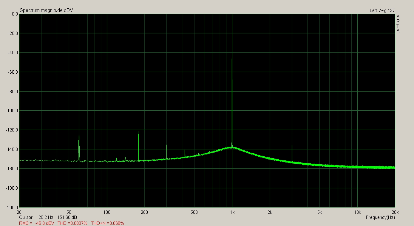

Below is and LME49600 in a loop with a 1611. RB resistor is 470 ohm and shunt is 200 ohm.
Output is 8.375Vrms and input 2.5Vrms. Non inverting mode. The load is just the FB components.

I have checked the datasheet of the OP1-BP and the parameters are excellent. Wish I was able to measure such low distortions as Samuel. I finish at -130dB even with notch filter.
Build one of Samuel's notch filters.
I have a Shibasoku 725C on it's way. My resolution should improve some.
